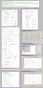

Hi Paolo,
Still looking for a Driver? Have a look at the submitted calculations that tries to expand your given requirements to a more complete set of Driver T/S worth looking for..
b 🙂
Thanks bjorn, but I know the calculation procedures.
I only need a double coil woofer.
For the moment in Italy I have found Ciare HS323 (if I remember correctly) that is good for a B4 reflex in about 65 liters, with the added parasitic resistence of the coil in series for low pass. It's not optimal but I have more liters of minimum so I can go.
And it costs about 220 Euro. It's a 12".
Thanks for reading.
