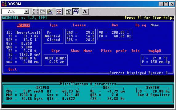

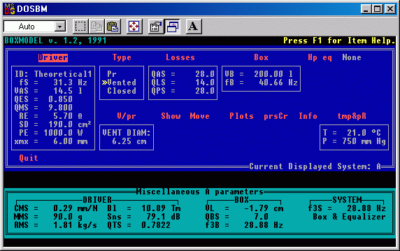

Just to illustrate, here is a screenshot of BoxModel using the parameters you gave us. forget about PE or excursion-for our purposes they don't affect what we are doing right now.
You didn't give Re, for an 8 ohm driver it is useally around 5.7 ohm, that's what I put.
For the dark blue area, we are only interested in the box under "Driver". The other boes have to do with enclosure measurements, which we don't care about right now. The parameters written under "Driver" are the parameters of the driver, in free air-no enclosure.
The way this program works is, we fill in our driver's parameters inthe "Driver" area inthe dark blue. Then the program calculates the other parameters and lists them in the light green area.
We cannot directly change what is written in the light green area. However, we can change what is written in the "Drivers" area in the dark blue, and that will change what is written in the light green area.
As you can see, if we fill in 1190 square entimeters-the equivalent of 190 square inches-the Bl goes up to 68. That is almost impossibly high.

Now, if we fill in an Sd of 190 square centimeters, we arrive at a Tm of 10.8-a very normal Bl value. This is why I think you accidntally filled in 190 square centimeters for your Sd value, when it is actually 190 square inches-or 1190 square centimenters.

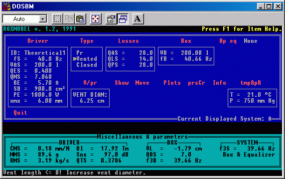

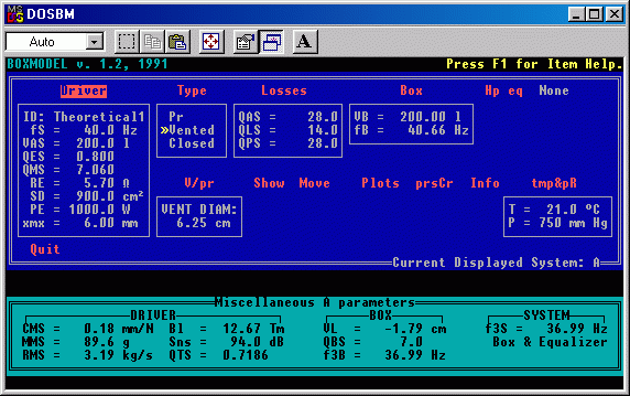

A lot of things affect each other, but let me illustrate something.
Suppose you have an 8 ohm, 15 inch speaker with an Fs of 40 Hz, a Vas of 200 liters, and a Qts of 0.72. You would like to lower the Qts.
The formula for Qts is:
Qts = (Qes X Qms) / (Qes + Qms)
Now, if you do the math, you are going to find that for most values of Qes and Qms you are likely to run into, Qts and Qes are pretty close. So if you can get Qes to where you want it, Qts will not be far behind.
So, here are the parameters of the 15 inch speaker with the "high" Qts of 0.72, which we would like to lower. Note the Bl value and the Sns, (sensitivity) as well.
Now, we increase the Bl by putting a bigger magnet on the speaker. Assuming the voice coil stays the same, adding a bigger magnet will do that. This cuts the Qes in half, which cuts the Qts almost in half.
As the chart indicates below, we just took the Qts down to about 0.38-a pretty normal value for a Qts, and one which allows you to use a vented tuning, if you wish.
We also increased the sensitivity by 3 dB-pretty nice.
We do all this, but the Fs and the Vas stay the same!
There are other ways to increase the Bl besides using a bigger magnet, but a bigger magnet is one way to do it.
