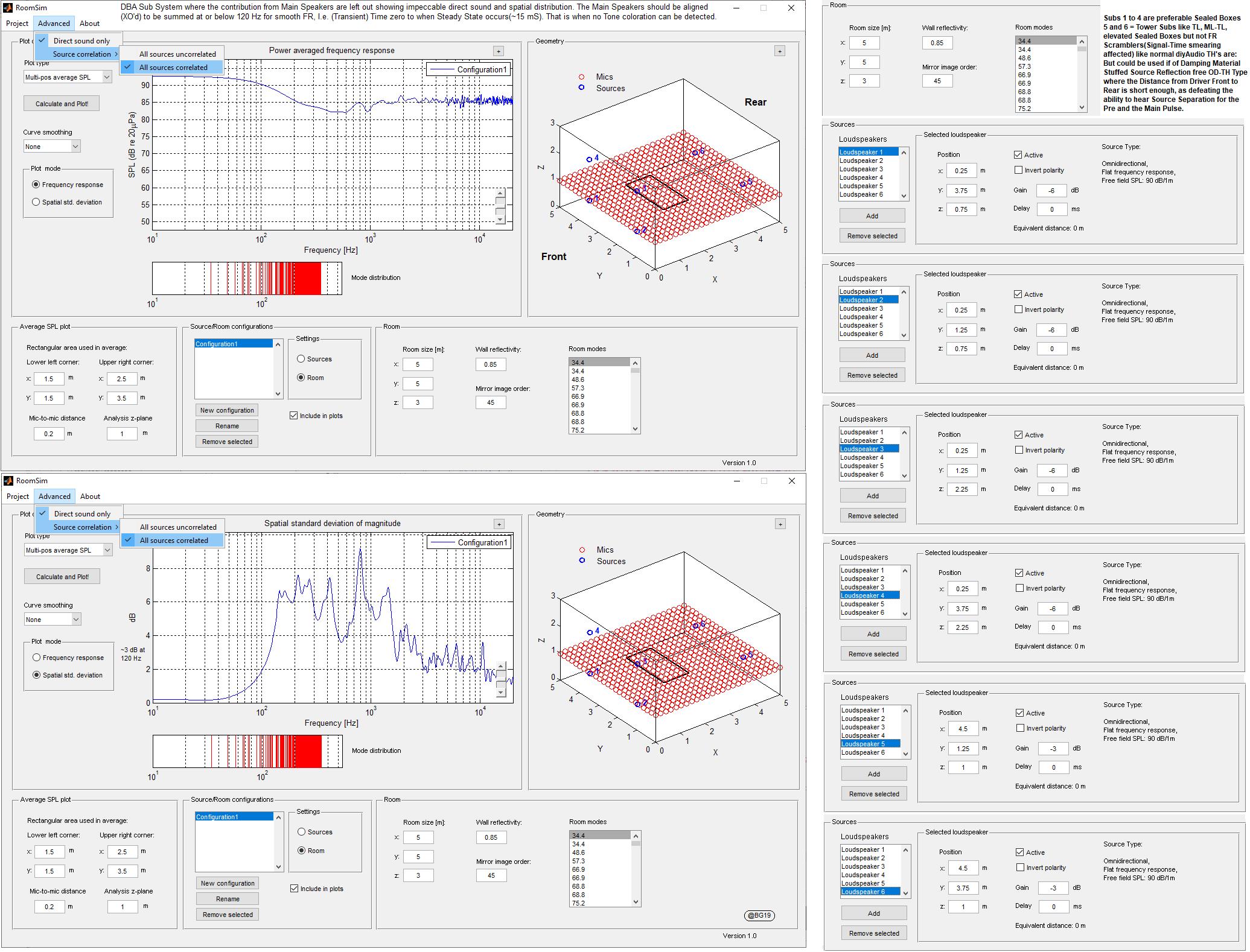

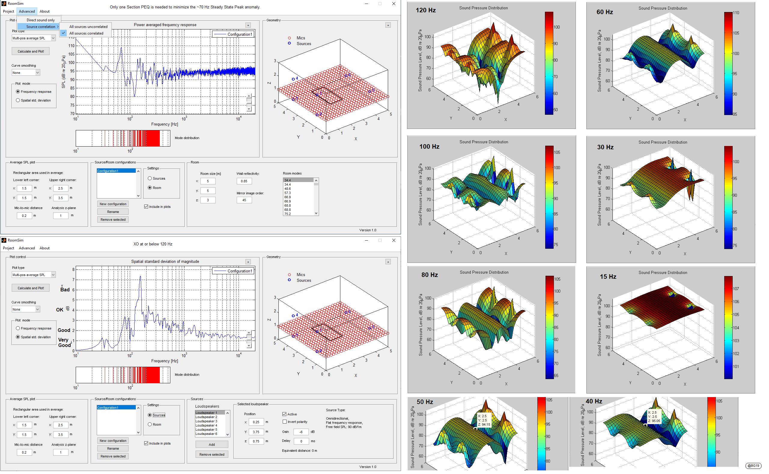

It is possible to use REW room mode simulator which can loosely estimate room mode suppression via 4 identical LF devices before even you build it. Remember, REW results are only estimation, not simulation and real-life results are often slightly different by all means.
Another possibility is to use random subwoofers placement and Multi Sub Optimizer software. Having compact subwoofers is always convenient from this point of view. From my memory, best sound was obtained everytime when one pair of LF extensions was placing close to monitors, creating 3 way stack. Hiding subwoofers under sofa caused seat to vibrate what is not welcome behaviour in music (but in HT - yes!).

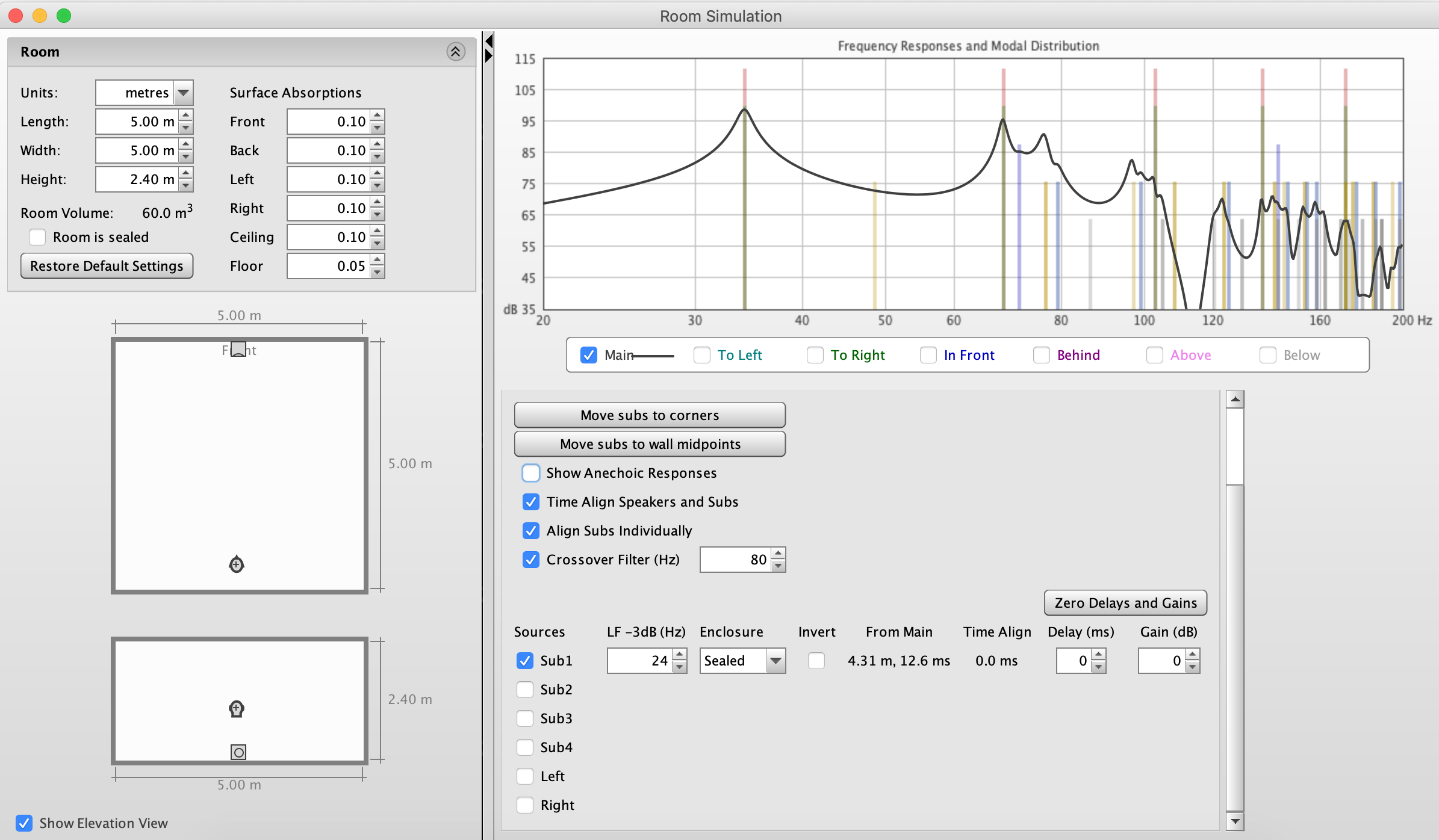

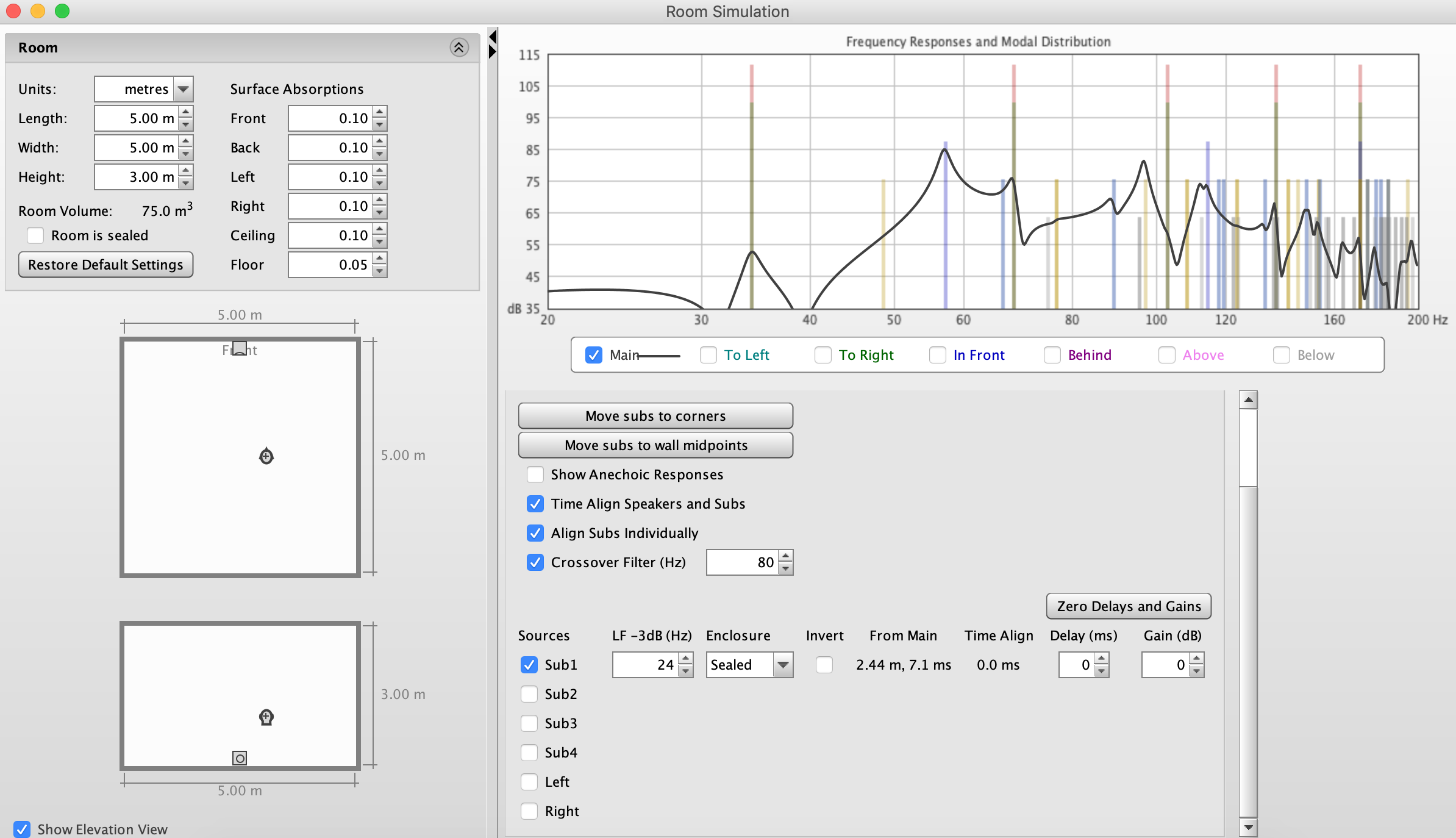

So have been reading the provided information. REW room mode simulator seems to suggest that a single sub-woofer placed exactly in the middle of the front wall would be best. Multi-sub does provide smoothing of response depending upon listening position, but the benefit appears to be otherwise minimal?
Really glad that REW room mode simulator was suggested to me - but REW would suggest that a single sub is best?... Seems that a square room is a pain!

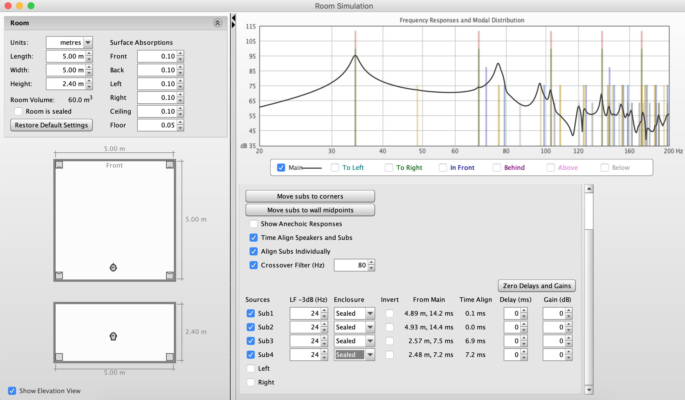

Thanks Think - yes you're right large nulls in the middle of the room.
Trouble is, even trying different configs (2,3 or 4 subs) as you suggest REW still predicts a complete dearth of bass in middle of the room - I just can't seem to find any locations in a 5x5m square room using different configs of subs that yields a flat frequency response.

The smaller the room, the less predictable it becomes; REW is a tool, an indicator, not the real world.
Take the width and height of your room and divide it by 2 and 4; those are ' the forbidden' distances to use for distances to walls for all speakers in the room.
