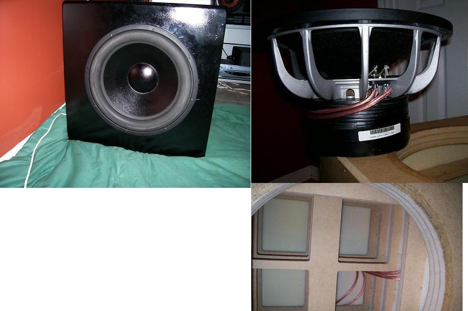

You probably already know that the adire Tumult 15d2 driver is a match made in heaven with the ada1200. The amp was designed with that specific driver in mind. I've just completed a DIY sub based on this driver. If you are looking for serious 20 Hz bass, this is an excellent way to go.
The 68 lb. beast comes in at $600 but is worth the price. If you are handy with wood and a decent painter, a serious sub could be put together for about $1100 (with an ep1500 amp). Add to this a Marchand Bassis, and for $1500 i'd match it against anything in the $2k class.
I ran a preliminary sweep in my 1,800 cu. ft. room and recorded 90 dB @ 20 Hz (6.5 meters) and 104 dB @ 28 Hz (2 meters) with less than 100 watts!(uncorrected). I should realize a 12-15 dB boost with the 1400 watt ep1500 and the Bassis on tap.
IMO, DIY is the most bang for the buck.
