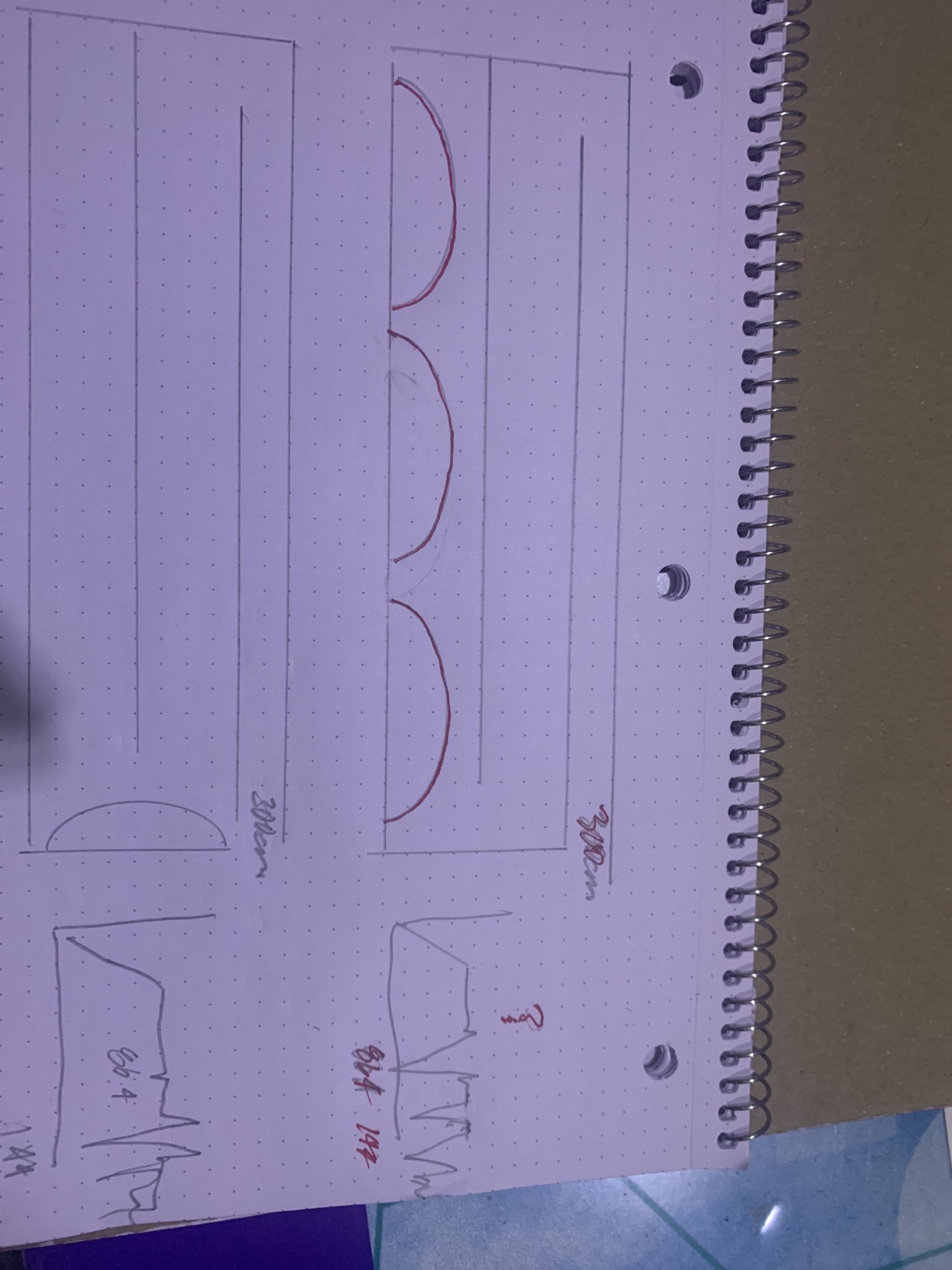

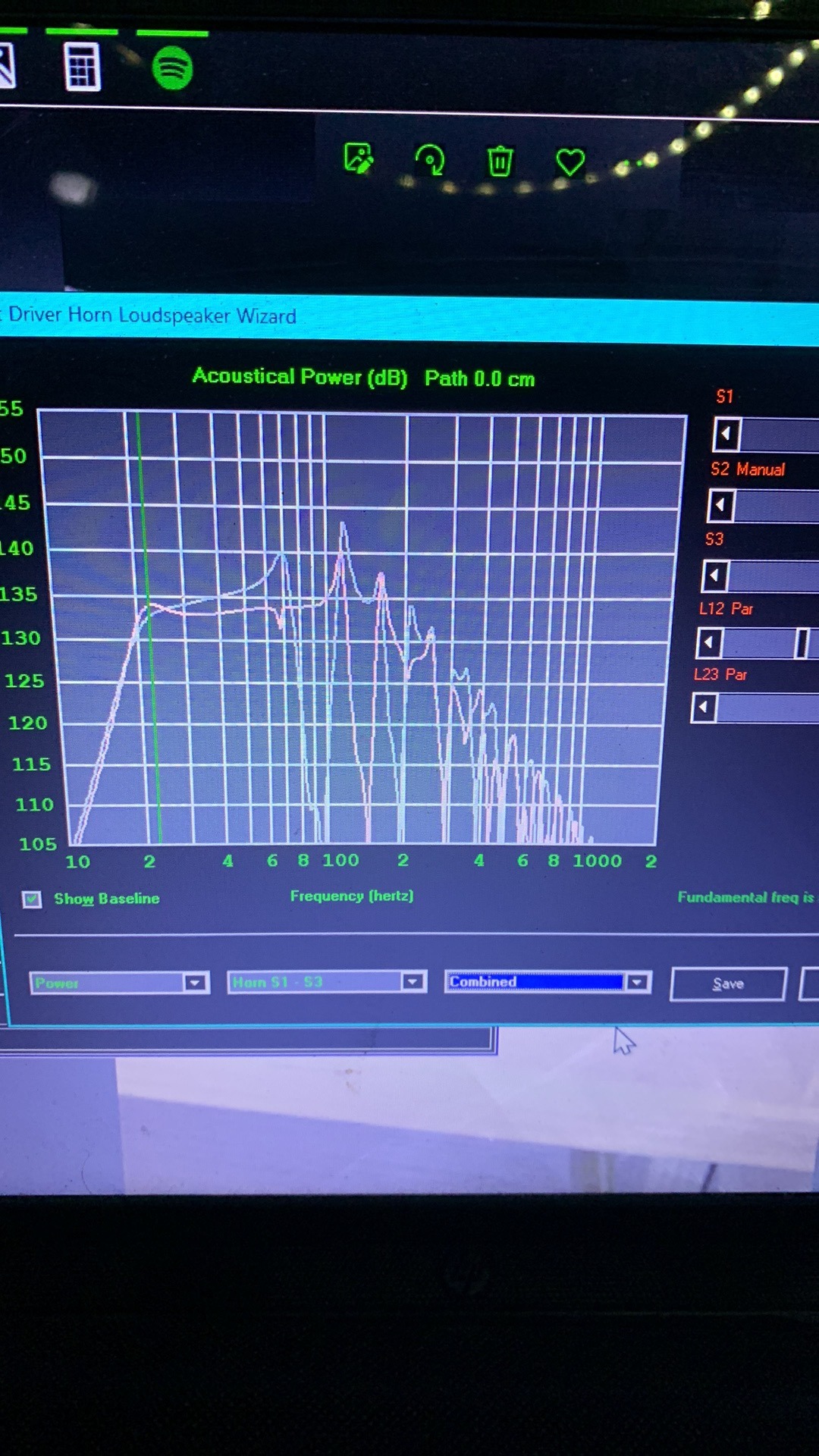

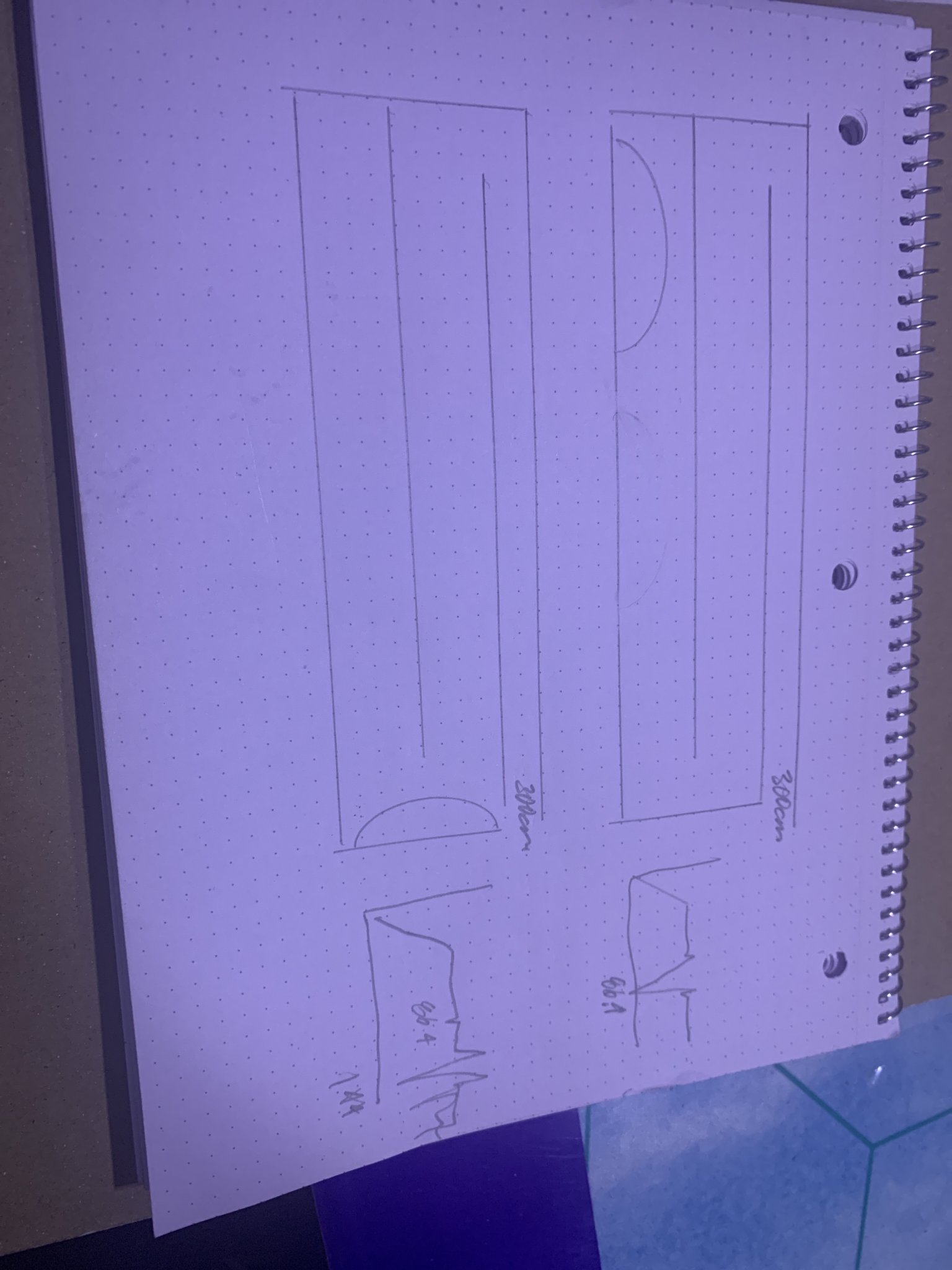

so load up the first ‘1/3‘ of any TL and the response would look like?(ignore the distance from exit/vent to front out put in non offset TL version So it’s still got the 86.4 hz notch…). I shoulda drew it single fold to help show that
