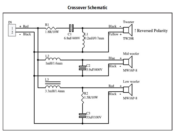

Not suggesting you change your parts, just thought it might be interesting to look at a similar project: as there aren't any details for the crossover - the important part - the link is of limited use to you but shows you what could be possible. You could always send the designer a message and see how you go.

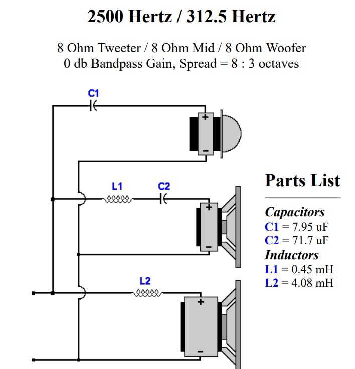

Could you predict how crossover like will be ?
If necessary , will replace to better suitable MID .

I know next to nothing about crossover design, I've almost always made other peoples' designs, and only two ways or MTMs. Three ways look rather daunting!
However, I've done heaps of research while we've all been at home, and suggest that the XO above probably wouldn't work well, whatever the drivers. If you look at almost any three way DIY build, they have more parts in the mid range driver part of the XO compared to a two way, here are just a couple:

I want to stick with the design in the first comment ,
The advices I need is about what crossover to use ,
If necessery to replace mid and the twitter .
The 10" woofer I don't want to replace
ofcourse I would like flat FR and smoth .
I need to do all callcultion . than to buy from partsexpress
I am really appreciate your advices :up:
The thing is , I would like to stay in the design in the first comment .
I don't know how to use speaker design software .
So I thought maybe someone here ,
will do it for me and recommend passive crosover for flat and smoth FR as posible .
I agree, but would use an active XO for the bass. Mid/Treble passive.
To drive the bass to Xmax you would need 84W into 8 ohm to 102dB/1m.
Mid and Treble need only 40W for the same SPL.
you save me . thank you . I have been trying with no succes to configure the XO . bass was indeed too week with the 10" classic woofer .with active XO the bass is superb 😱 . God bless the forums .
