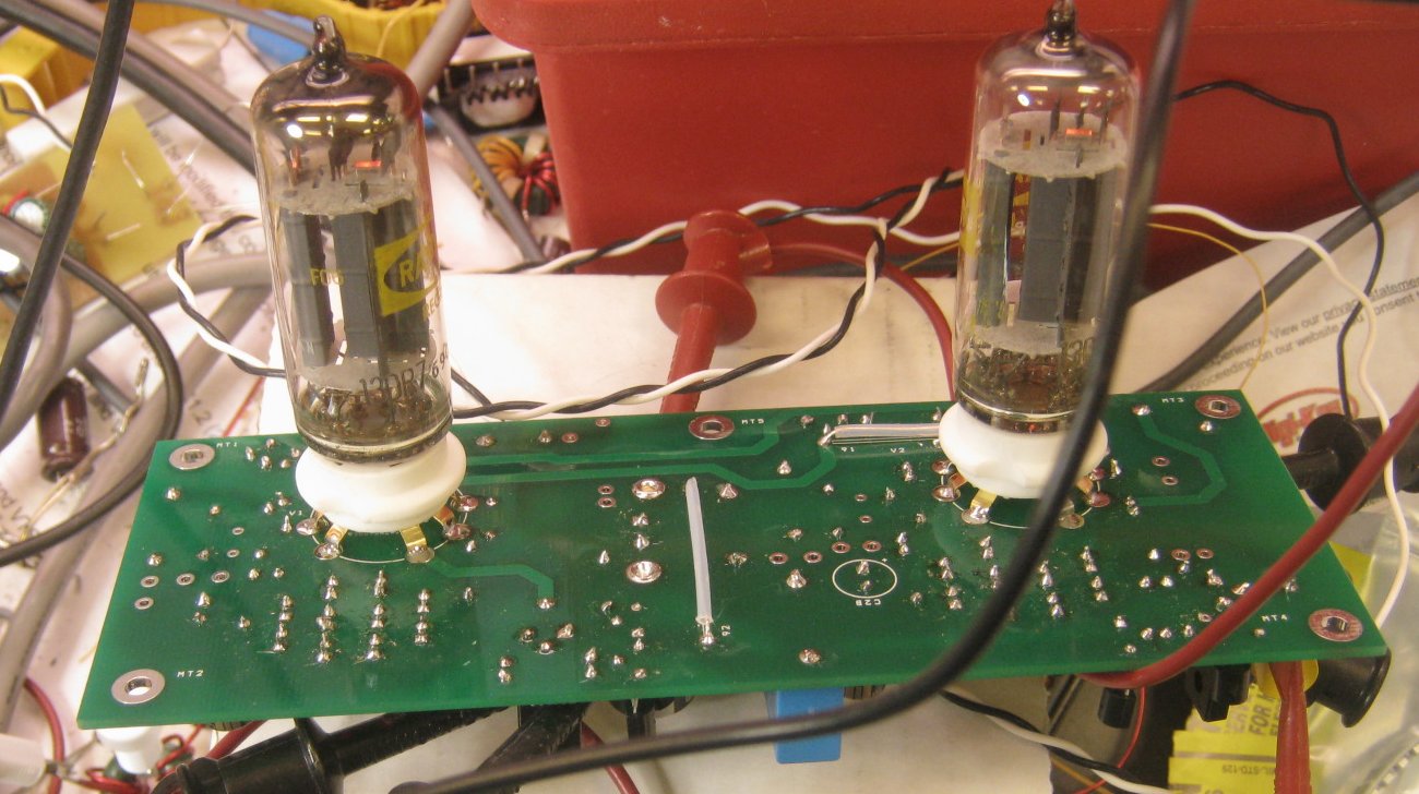

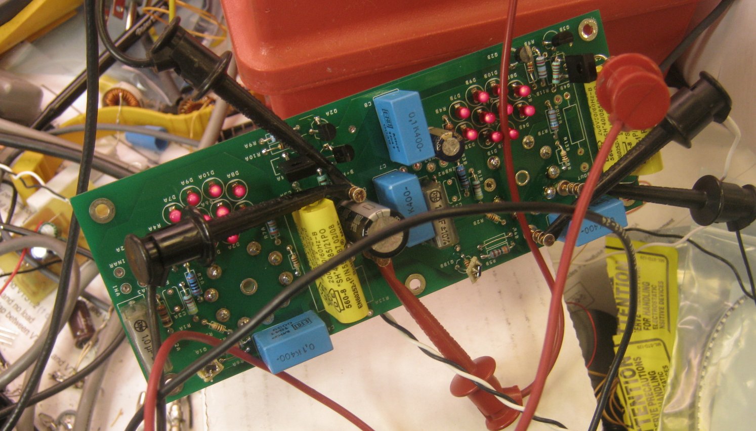

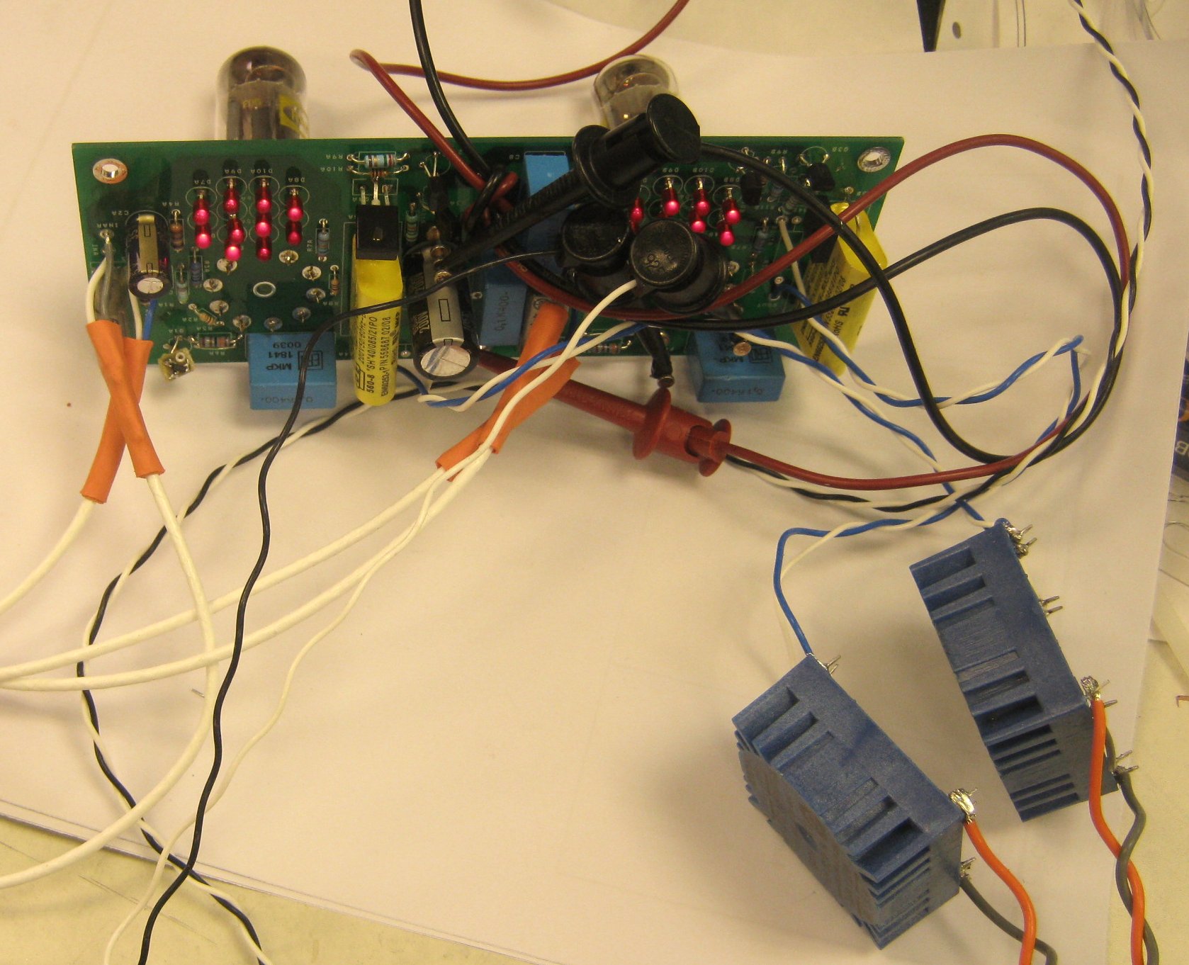

Attached are a couple of pictures of the first prototype of a headphone amplifier using inexpensive vertical oscillator/amplifier dual triodes. I am going for a parafeed amp first, using some small power toroids for output XFMRs, as that's what I have on hand. I'l be scouting out options for legit parafeed transformers, but the troids should be enough to make a noise at least.This amp could also be run as a simple SE amp with gapped output XFMRs.

As I described in my first post here, I'm using a pair of small toroidal power transformers for parafeed output transformers for now - you can see them in the picture.
The amp is touchy as to input level with the feedback loop open because of the excess gain, but the sound is surprisingly nice driving a pair of Grado SR225E headphones.
There is no lack of bass, and the control is reasonably tight, even for an open loop SE amp. The fun will begin when I close the feedback loop, as I have no real idea what the cheap output transformers will do when included inside the global loop. It's nice to have a gain-phase analyzer at work...

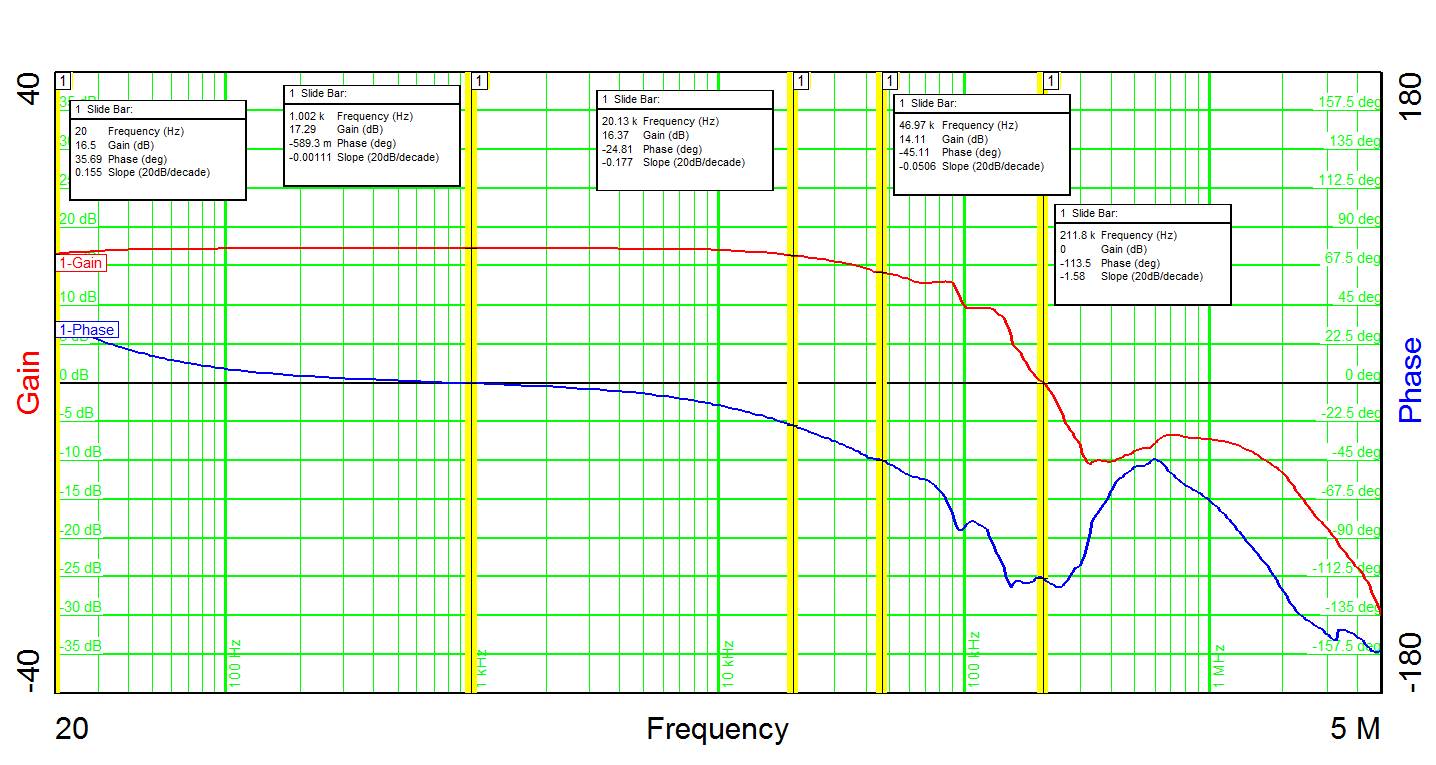

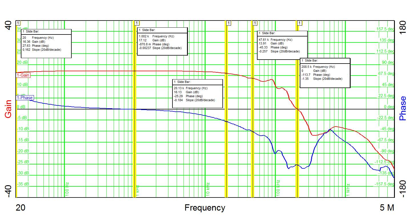

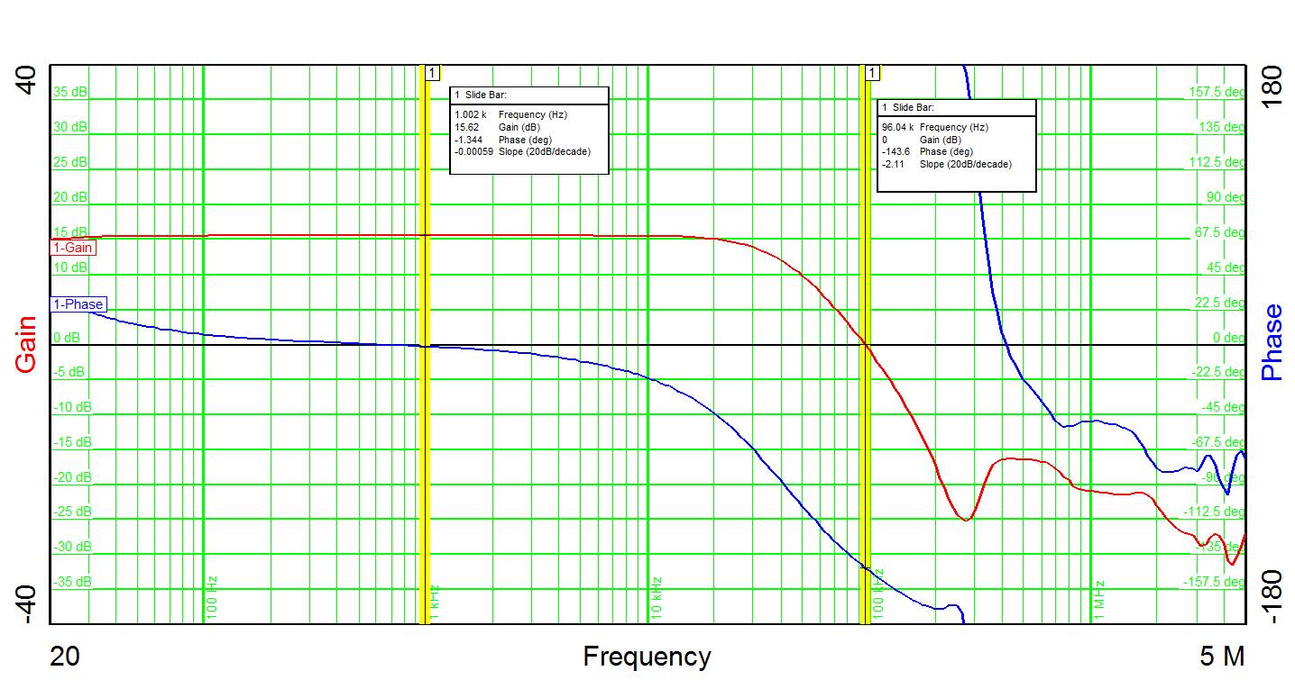

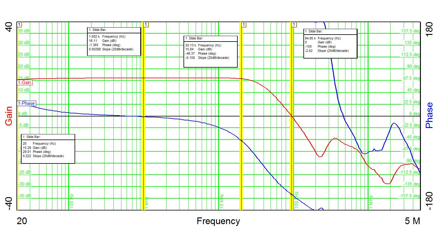

Well, I ran gain-phase plots on the system with loop closed and no compensation cap, and wonder of wonders, the amp did not oscillate. The phase margin at ~30 degrees leaves a lot of something to be desired, but I was expecting a lot worse. It looks like a 10uF output coupling cap is more appropriate for the headphone impedances and transformers I'll be dealing with.
Attached are gain - phase plots for the amp with toroidal power output transformers, 3uF coupling cap, 51 ohm resistive load, and no compensation. Attached is one more plot with a 10uF output coupling cap instead of 3 uF.
Instead of rolling off the HF gain to get better phase margin with the crappy output transformers, I'll be looking for a better transformer.

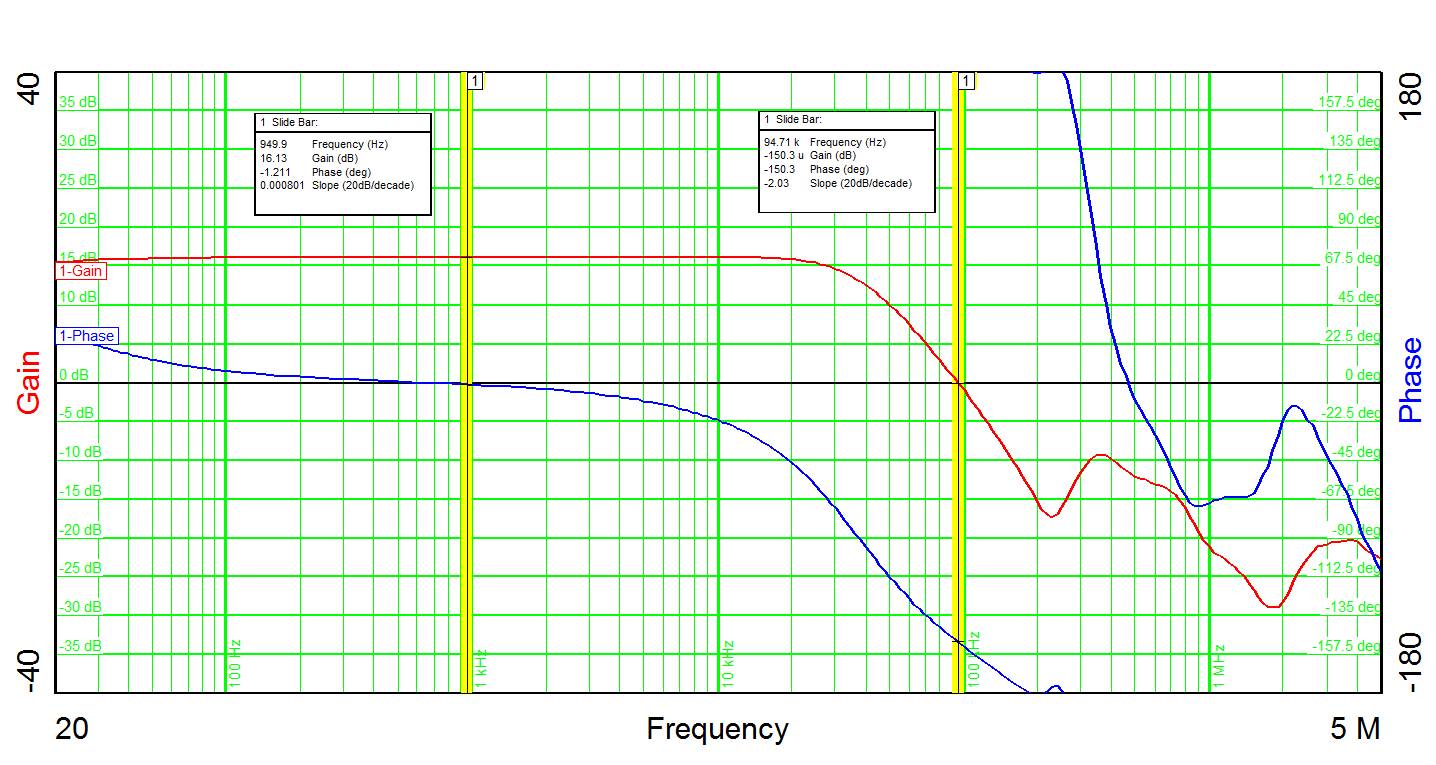

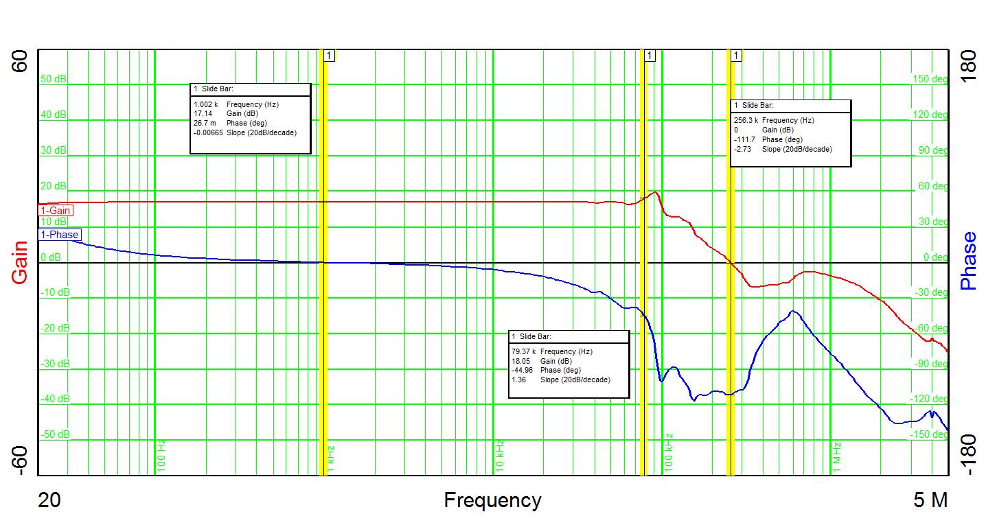

OK - here's the closed loop gain-phase using the Transcendar parafeed transformer with no compensation cap. The response is more, shall we say, interesting than the toroidal power transformers used as outputs, and there is reasonable phase margin at crossover. The peaking is a bit troubling, and will probably require a visit from Mr. Zobel - more on that later.

Several tries with a Zobel network on the primary side did not really damp out the 100 kHz resonance and phase dip. I will try a reasonably heavy network on the secondary side to see if it helps. after all, that's where I'm picking up my feedback. The other thing I want to fix is the amplitude rise near 1MHz, as there is not a whole lot of gain margin, and one could envision a situation where the amplitude would cross back over 0dB again - conditional stability, anyone?
This weekend, I tried a secondary Zobel network on the outputs of both my parafeed headphone amp and and its simple single-ended alternate stuffing. I ended up using 100nF + 47 ohms and some mild compensation of 3.3n + 330 ohms across the feedback resistor. Results are shown below. I think this is about as good as I can get using the inexpensive Transcendar output transformers, unless I really want to cut down the amplifier bandwidth. I may talk to Electra-print to see what they can do for me later on. Right now, though I'll declare a conditional victory and move on to other projects.
The first G-P plot shown is for the parafeed design, the second is for its single ended sibling. They look pretty similar, as they both use essentially the same transformer, the parafeed transformer being simply a gapless version of the standard Transcendar single-ended design.

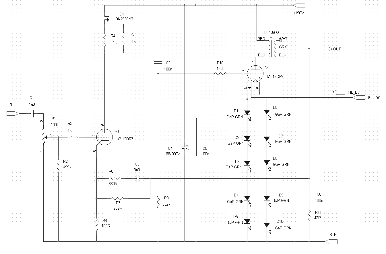

Here's a schematic for 1/2 of the single ended VT headphone amp that made its way to Burning Amp last Sunday. It's all Rolls-Royce with current source loaded first stage and LED-biased 2nd stage. You could do a knocked-down version of this with resistive and RC biasing, but it probably wouldn't sound the same. I plan to give it some better output iron for more bandwidth and (hopefully) better sound.

The amp auditioned well at BA - not mediocre at all. My point is that it could be even better with better output iron.
As evidenced by the gain-phase plots shown, I was able to damp out most of the warts of the Transcendar output iron with compensation sleight-of-hand and achieve decent gain and phase margin. I did the best I could with what I had at hand, in the time I had available. The gain-phase analyzer I have at my work place is a valuable tool, showing things that wouldn't be necessarily visible from just a square wave response. A good square wave response is a necessary, but not sufficient indicator of decent behavior in the frequency domain.
I'll be talking to Cinemag about output iron possibilities, as they have some capabilities I didn't suspect until recently. I may also be talking to Electra-Print. The object will be extended bandwidth, but still with adequate gain and phase margin.
