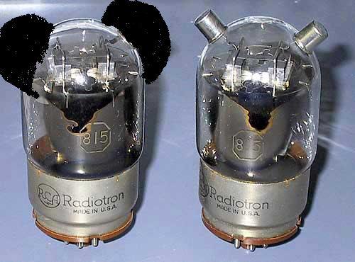

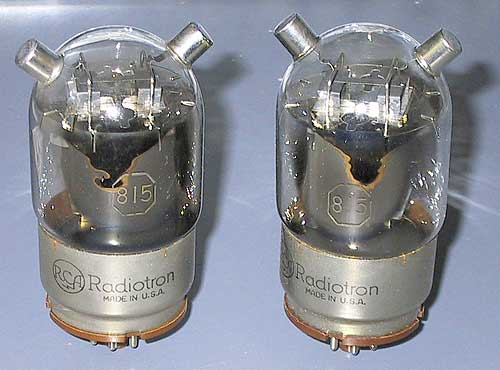

Dave,
I have a few of the 815's also but I hesitate to make an amp from them for fear of it looking kind'a Mickey Mouse. 😀
rcavictim said:looking kind'a Mickey Mouse
Not Mickey Mouse... R2D2
I've heard they make a good audio tube... wonder what kinda drive you'd need?
dave
