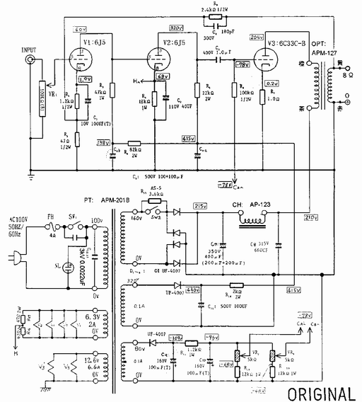

Hi, I have a SET amp with 6C33C, it is designed by Dakesue who "discovered" the 6C33C and started to import it as EC33C to Japan. The circuit diagram can be found here: http://www.bonavolta.ch/hobby/en/audio/6c33c_5.htm
It is a relatively simple design but the sound is very good. My own amp that I bought as a kit by Dakesue use a Tango output transformer, which is of very high quality. As you are probably aware of the quality of the output transformer is very important in a tube amp, even more so in a SET so I would suggest to try finding something at least similar quality level.

tubetvr schematic suggestion
Good schematic design. This should be a great sounding amp with careful attention to some components.
I would exchange the 12BH7 with a Sylvania 6SN7GT, 6SN7W or 6SN7GTA with 'T' shape plates. Same circuit components are ok. Just hard to beat those common Sylvania 6SN7s.
For a 12AX7, Mullard tall plate such as 10M series would be a great tube. 1950s era CBS 12AX7s are also a winner.
Use motor oil run caps or a polyproplyene type such as Solen in the amp & power supply. The huge capacitance of 400uF at the 6C33C PS filter is necessary- just use four 100uF motor oil caps in parallel.
I would also use a Mullard EZ80 rectifier tube in place of SS bridge at B2 supply.
UF4007 solid-state diodes are best at 6C33C position.
The .22uf @ 630 volts coupling cap at the 12BH7 (now a 6SN7) should be of best quality. Russian teflon type are good.
My 2 cents.

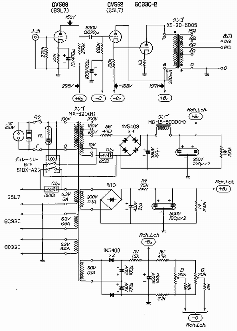

They both appear to be reasonable designs, the 6SL7 based design does not use global feedback, which to me is an advantage.
Both the 6J5 and 6SL7 are good sounding tubes.
The 6J5 version seems to be configured for lots of voltage gain, the 6SL7 is not, but will still have a full power sensitivity of less than 1Vrms I would guess.
I terms of reliability issues I am not sure there is a significant difference.
In terms of driving the 6C33 the 6SL7 CF will have lower source impedance than the 6J5, but due the relatively low operating current will probably have less large signal power bandwidth than the 6J5 which can be operated at much higher currents.
