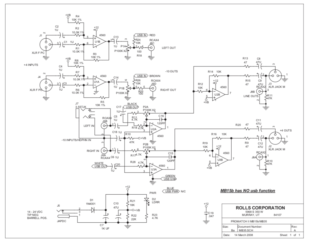

Thanks for that tip - this was exactly what I was looking for. Don’t know why a google search could not turn up something like this. $55 is a great price too. Only thing is the -88dB noise floor. Most of my stuff is -125dB noise floor - but it will do until I make a custom one.
Manual even has a schematic:

Thanks for the tip on the Mesa Boogie clearlink - but I think the Rolls unit is closer to what I was looking for.

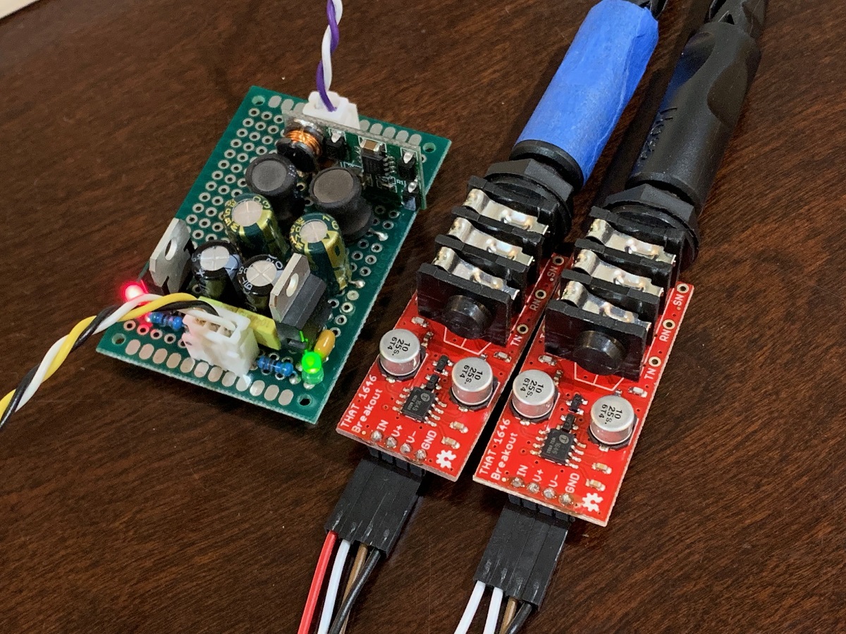

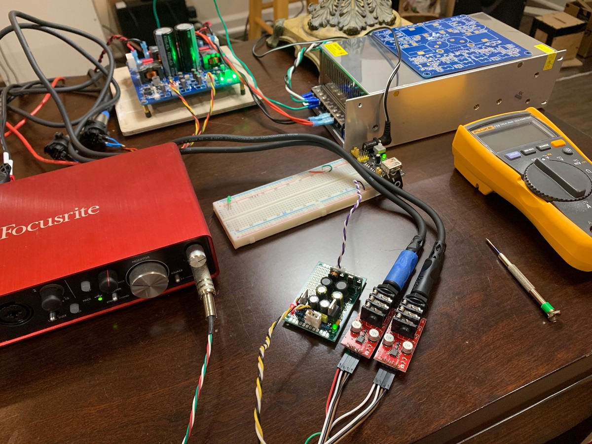

My Sparkfun THAT1646 breakout boards arrived today. Will probably use a handy 5v to +/-24 DC-DC followed by +/-15v 7815/7915 regulators.
I made a +/-15v power supply from a +/-24v DC-DC converter and LM7815/7915 voltage regulators to power the Sparkfun THAT1646 SE to Balanced drivers. Connected it to my TPA3255 Reference Class D amp with balanced inputs. Now I can use SE headphone outputs to drive the TPA3255 rather than always having to rely on the balanced output section of the Focsusrite. These Sparkfun breakout boards are very convenient and sound great.
