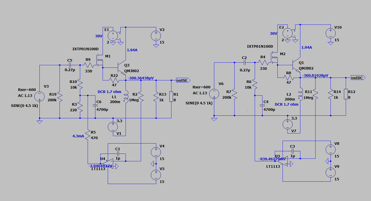

I am designing a simple 14-15W unity gain power follower to drive my sealed box midbass system. To get good damping even below crossover I want it DC-coupled at the output.
I have never dealt with servos before, but have tried to come up with two versions by copying other. For some reason the left one sims slightly better.
The reason for the 10k resistor and 0.27u capacitor is to form a 1st order 60Hz HP filter. Removing C4 and C6 might be unnecessary, as they don´t seem to alter the sims.
Should the servo be designed otherwise?
