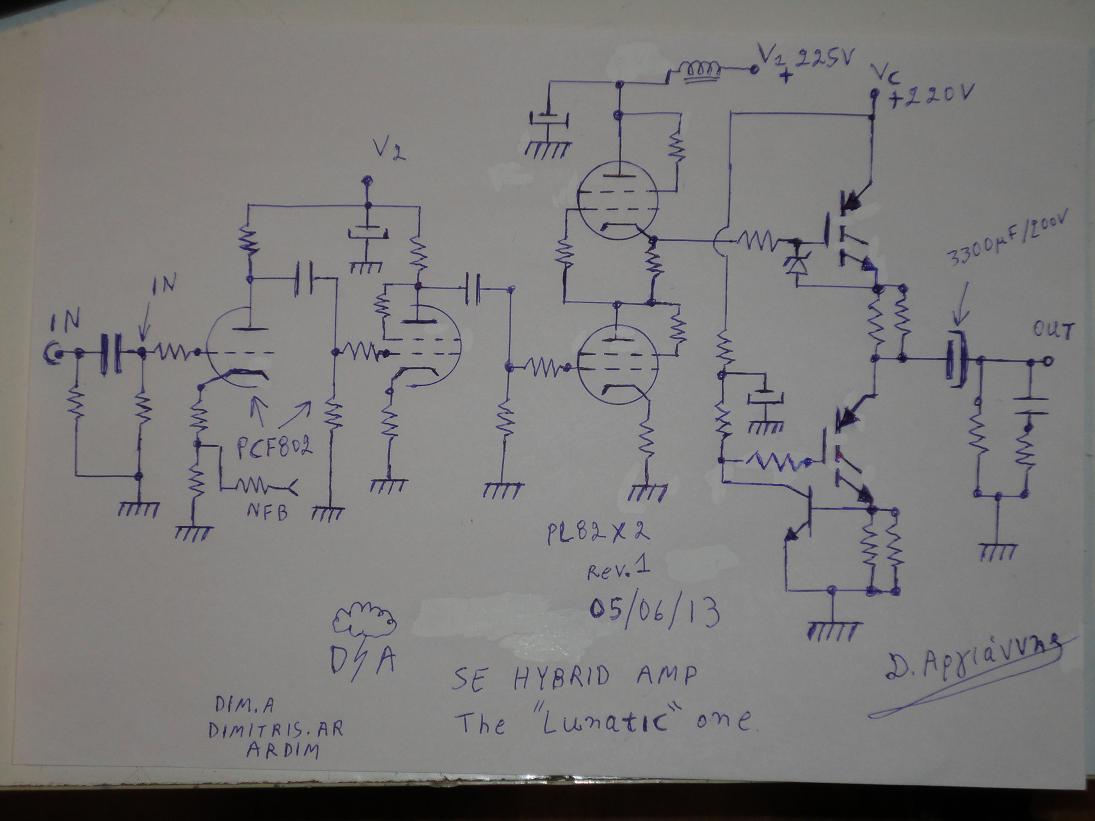

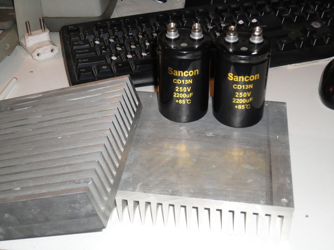

About two months ago I started to design and build an Single Ended Hybrid Amplifier .
The circuit is simple , consists of one PCF802 tube ( two common cathode gain stages ) and two PL82 pentodes ( triode connected ) in SRPP configuration as driver and third stage in the same time , DC coupled to the output stage , which is an IGΒΤ power follower ( emitter follower onto current source ) .
The circuit runs at about 220V - 225Vdc for both the sands and the tubes , but with seperate power supplies .
The name "LUNATIC" was given because of the use of high voltage IGBT and the DC coupling between them and the tubes 😀 .

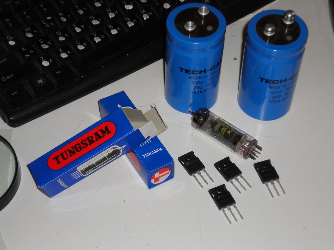

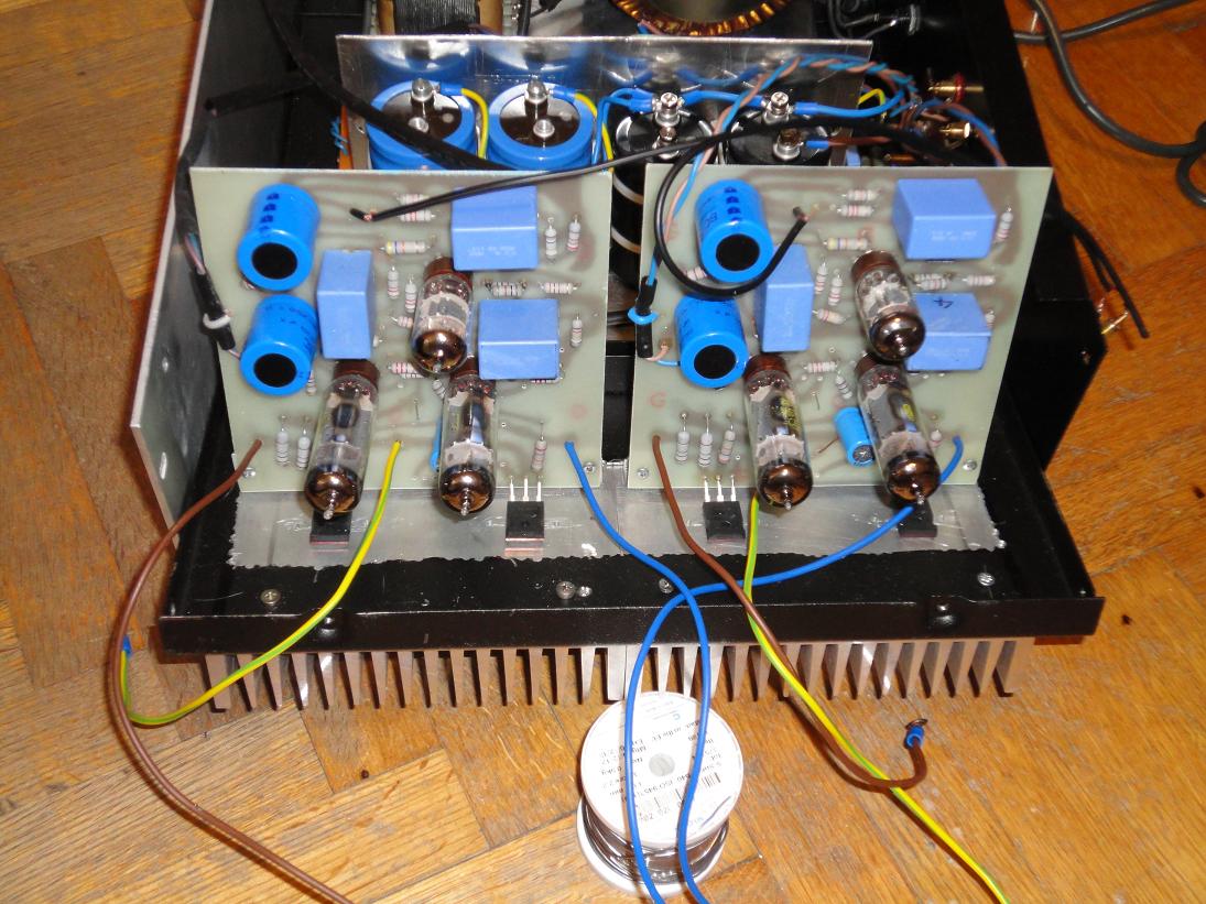

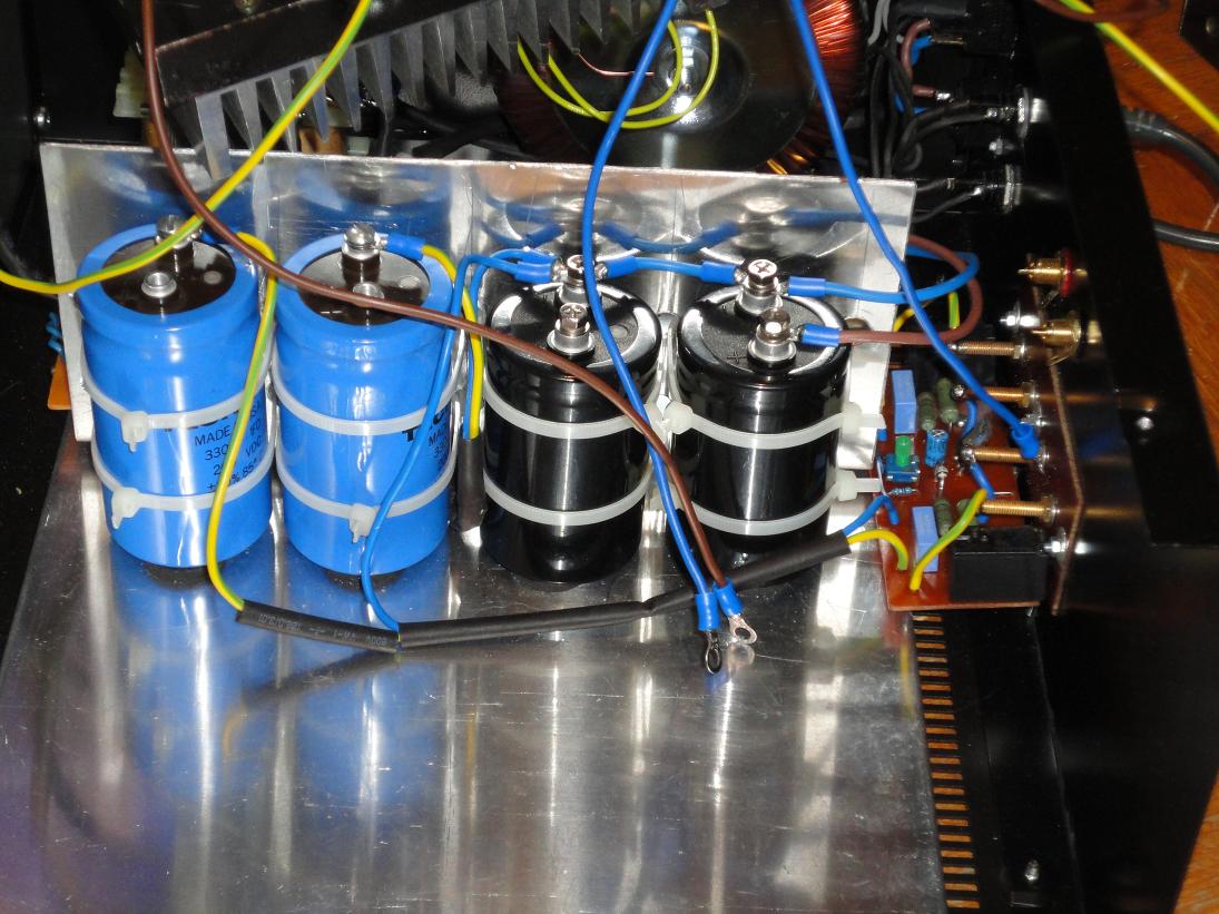

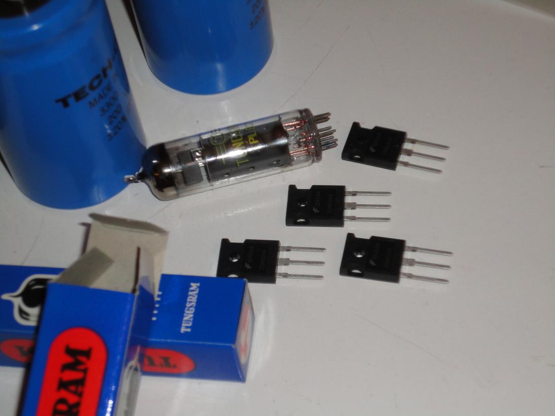

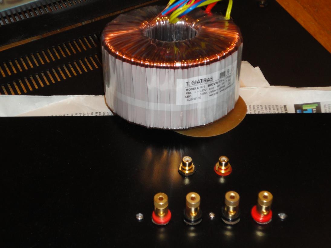

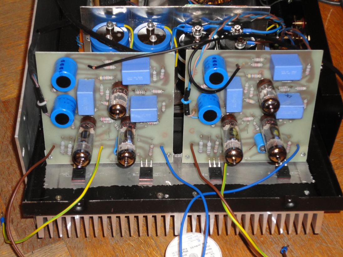

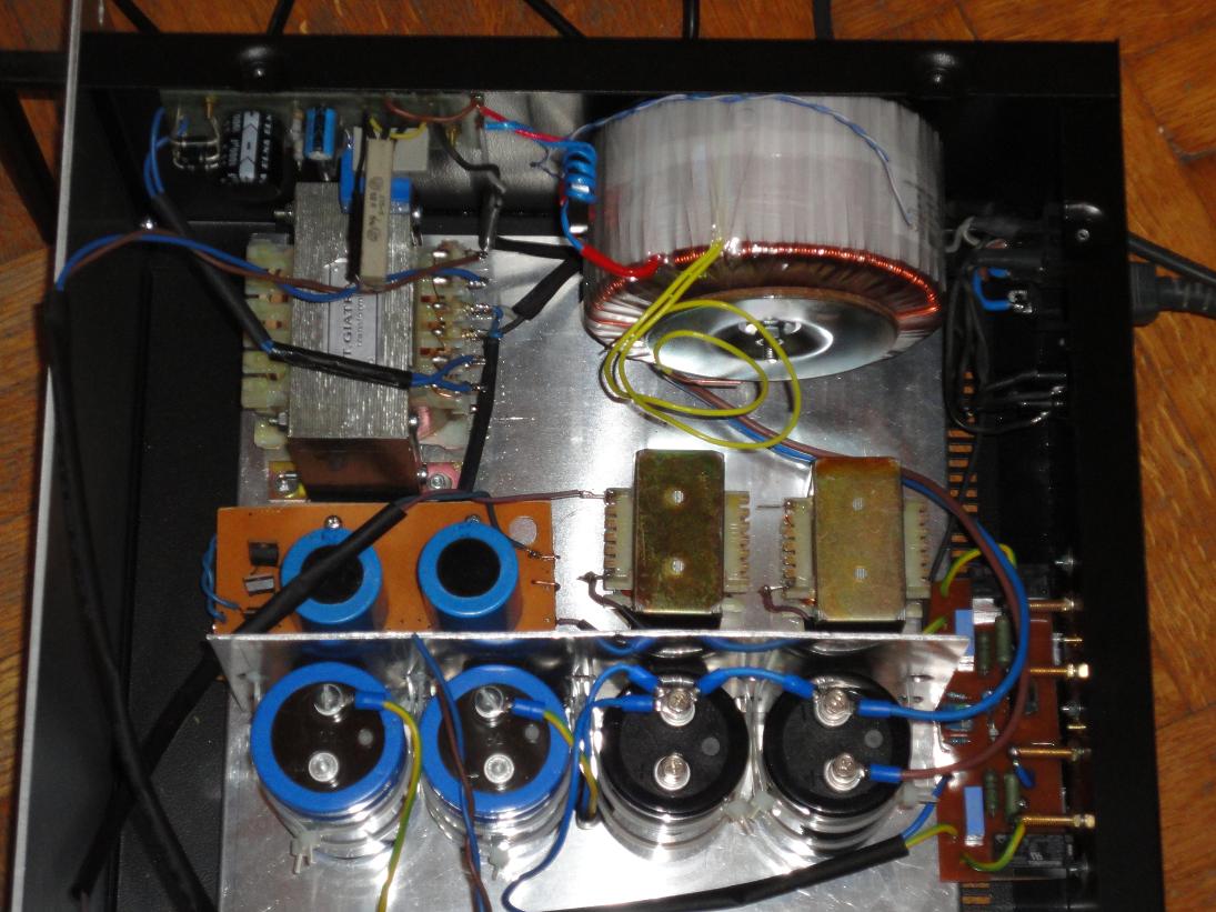

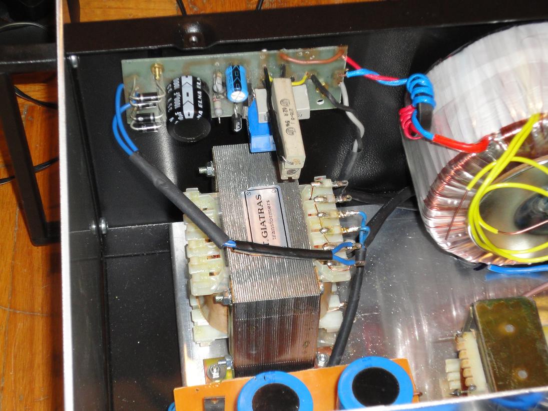

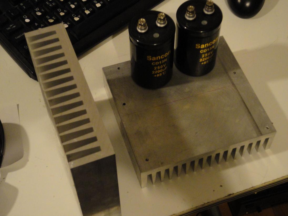

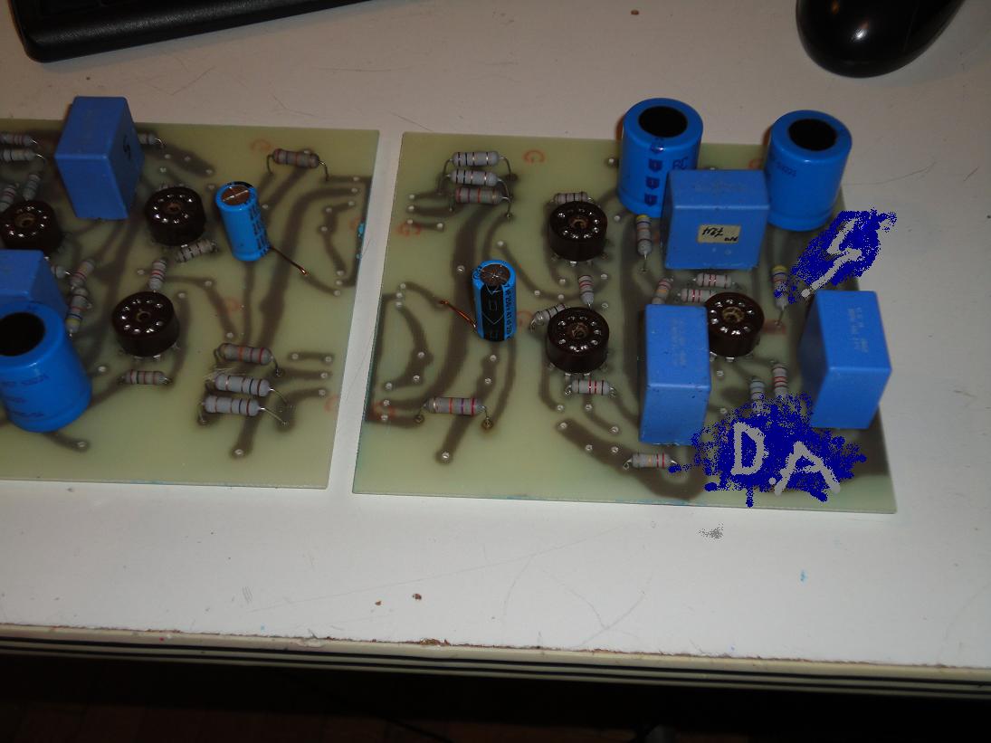

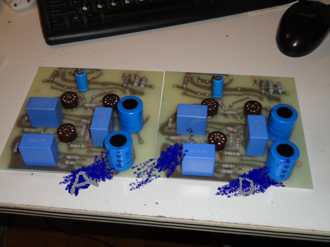

Here is some Fotos , the IGBTs , one PL82 and the output Capacitors ( in the first two fotos ) , heatsinks and power supply capacitors on the next two fotos , and finaly the two channels pcb and the 600VA power transformer for the output stage .

Like any other SE class A amplifier it will have low Efficiency about 25% of the idle power , but this depends from other things too , like power supply , driver circuit , the load and the output elements too .
For the moment I have tested the tube circuit only ( the output is taken from the output of the SRPP via an capacitor 20μF/250V MKP and here is the results
Open loop : Input signal 1KHz 170mVp-p , output 74Vp-p onto 10KΩ load , this is a gain of about 53dB
with the same input signal I have 70Vp-p onto 5KΩ load
and the maximum undistorted signal at 5K load is 74Vp-p
Open Loop : -3dB point is at 48KHz .
I'm wondering how you are dealing with heat on those igbjt's using such a high B+ for the output stage. To have enough current for any useful output you will be burning in the neighborhood of 100 watts per device with a 225V supply.
My intention is to build an amplifier in Class A that would work better with high resistance speakers ( because I don't like high currents bias too much ) , like 16Ω loudspeakers , that's why I said it depends on the load ( meant loudspekers ) in the previous post , but I will tested with 8Ω loudspeakers too ( something like a tube OTL amplifier ) and so I choose B+ 220 volt for the IGBTs to be the same with the voltage of the tubes to DC coupled easy with them , I know it's a risk but I have a "plan B" if this fail , hehehe "plan B" it reminds me something here in my country ! , I said it's lunatic - crazy from the begining 😀 .
I will start with 80W to 100W idle for each channel and we will see , maybe there is a "little" chance to go in class A2 .

What is optimal for audio or not is a big story , that we can't cover it here ( it's a big debate ) , in my opinion most devices can play good if we treat them right , as for those IGBTs , their switching characteristics is very good they are new generation IGBTs , but here we have class A amp therefore we don't have to worry about those characteristics 😀 , it will matter if we have class AB amp .

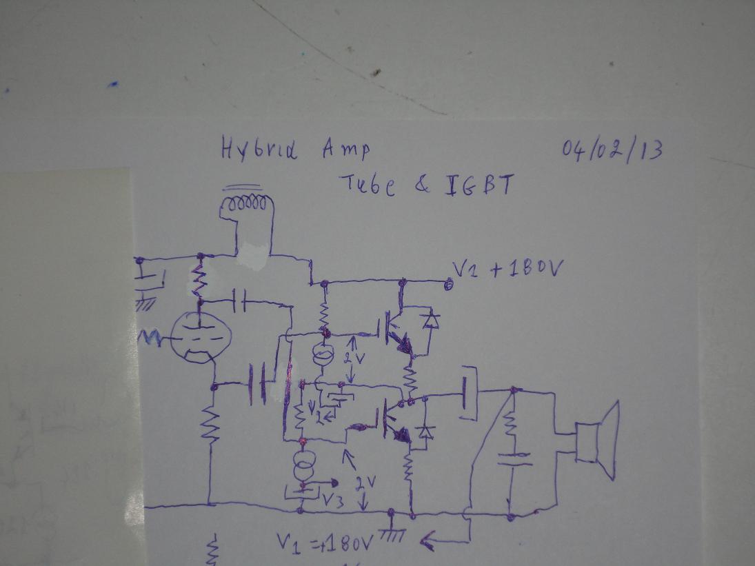

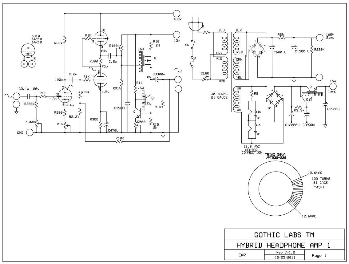

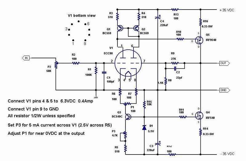

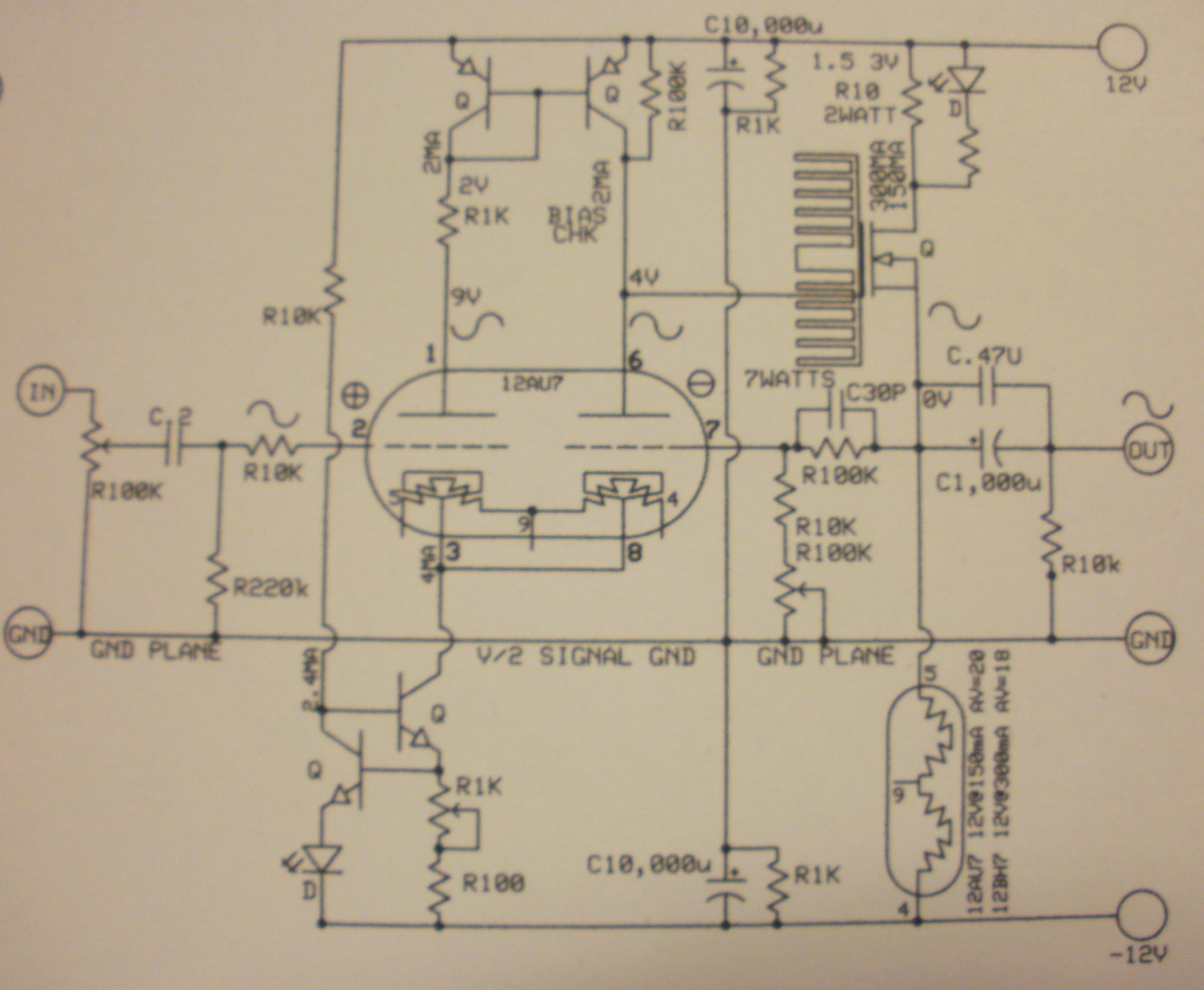

Looks more like a headphone hybrid circuit.... Class A followers have been used for yrs especially on the IRF510-12 AU7 design
