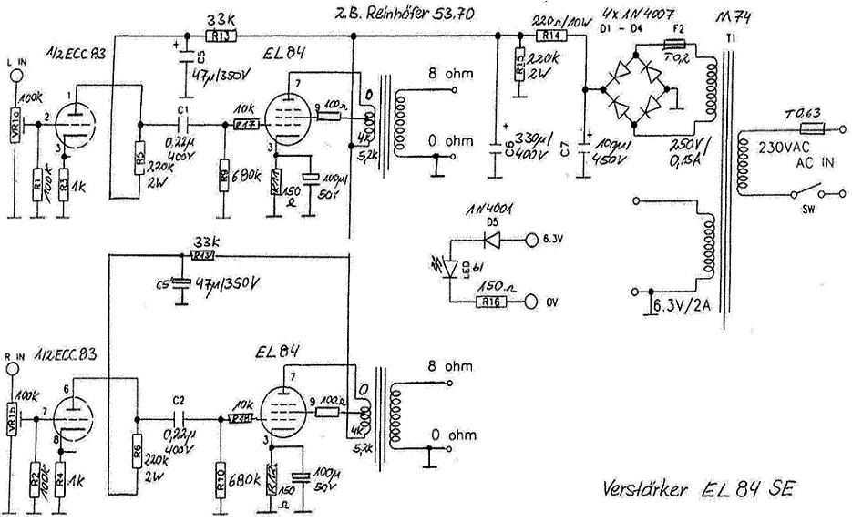

mabey something like this?
I like the look of this because it is fairly simple, i could probably wire it all point to point useing just the component leads and keep it fairly small.
What sort of output power would this give out?
Would it work ok? any improvements that could be made? Or should i go for somethign completely different? if so any suggestions what i should go for?

the output transformers i salvaged have three wires on primary side though, one too pin 7 and one too pin 9 and one too b+, not sure how i would go about wireing them up for that circuit? or would it simply be that i wire it up the same but instead of wireing the sacond wire to the el84 i put the resistor to that pin (pin 9 i think) and to B+ like ont the schematic.. and ignore the third wire ont he output tranny?

The cct for the silk transformer amp is nothing too special, it is missing an earth connection at the junction of the two cathode resistors though.
As for measuring the impedance of the transformer, the easiest way to do it is to apply an ac voltage to the primary, and measure the voltage across the secondary.
Voltage ratio can then be determined, square that and you have the impedance ratio. So if the tranny is designed for an 8 ohm output, multiply the ratio by 8 and et voila, you have the primary impedance.

Owen,
Your O/P trafos have ultralinear taps (shows how well I guess
). That opens up an interesting possibility. You can try Bandersnatch's exolinear topology. Instead of connecting the voltage amplifier's load resistor to B+, connect it to the O/P trafo's UL tap along with the EL84's screen grid. It's a slick form of NFB.
An ECC88 section probably has enough gain to achieve full power driving the EL84. It is enough for a triode wired EL84 without NFB. However, the 40+ mu 12AV7 family tubes I suggested do offer extra "breathing room" over the mu 33 ECC88. In North America, 5965s are INEXPENSIVE, but I can't say anything about UK cost.
