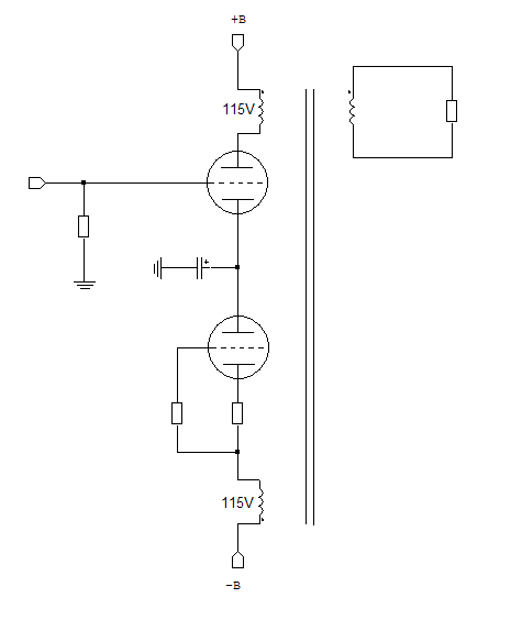

I was reading "Designing Valve amplifiers" By Morgan Jones (Highly Recommended) and saw the page for cancellation using one valve, page 392.
I had some questions.
First, would each winding be 2*RP as a rule of thumb?
Would Av = 2 * mu/mu+1 ~ 1.8?
The circuit looks like it might work great with a toroid and maintain "perfect" balance. It would also work with something like the Lundahl LL1663, but not most classic push pull transformers.
I was thinking I could have a bit different amp.
Any thoughts are appreciated.
I was sketching concepts on my pad for this and thought I'd throw it out for comments.
Doug

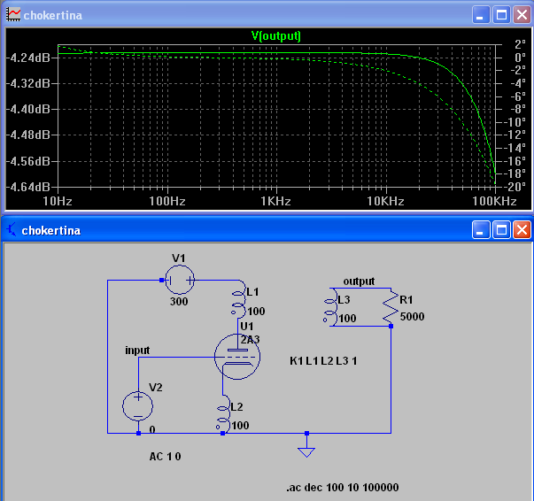

It seems like such a nice concept. However, the problem is that the AC signals will exactly cancel each other out leaving you with almost exactly no output. That is, it is an error in the book.
Sims are from Slagle from a while back. Also, if you search AA for "chokertina" there was a discussion on this in 2003.

Here is The Concept.
Push pull transformer with split, not center tap primary.
Standing current cancels. And since there is only 1 tube and Icathode and IPlate are equal until A2, the current ballance should be "perfect".
Morgan Jones said it was a problem to drive.
Doug
Doug
Really?
Thanks.
Sounded too good to be true.
Doug
"The ac signals at the anode and cathode are opposite phase right?"
Yes, but they are then connected to the same phase connections on the xfmr where they then cancel out.
