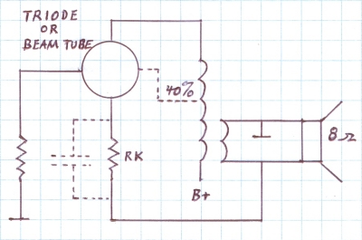

I don't think it's correct the schem that you posted.I'm not sure though.But it isn't like McIntosh' unity coupled.
Anyway for a SE amp,you can't do it like McIntosh.But you can do it like Quad!
It's called CFB(cathode feedback).Do a google search to find the original Quad schem to see how it looks like.It's a PP design but...the half ... is a SE design! 😉
You need a separate winding for the cathode.The only disadvantage is that you will need more preamp gain to drive the output stage.But the main advantage is that with CFB you can drive loads down to 2-3ohms!

The schematic you show seems to be a simple SEUL (single ended ultra-linear) amplifier. Since a triode does not have a screen grid, you cannot use it un UL connection this way. Have a look at Patrick Turner's 22W SEUL 13E1 amp
Yes, you can use cathode feedback taps on a single ended amp to good effect. Have a look at the "Scrapbox Challenge" amplifier in Valve Amplifiers if you have a copy.
A minute amount of Rk will be taken up in the secondary resistance, negligible since the resistance is under an ohm. It will change the AC response a bit (forming a voltage divider with the cathode impedance, approx. 1/Gm), which is why a bypass cap is necessary.

On second thoughts, I probably should add that using cathode feedback on the output stage of an amp by leaving Rk unbypassed isn't a great idea when using anything in fixed screen mode, because the valve will increase its effective anode resistace by Rk x m (which is large), so you end up driving the OPT with what is basically a CCS, which isn't all that great for bandwidth or the damping factor of the amp. Somewhat less of a problem with UL or triode connection, but CFB via taps on the transformer is a better solution, if you can get them since CFB this way reduces output impedance.

There's no reason why you can't use cathode feedback on a single ended output stage. Note that it will be similar, but not identical to McIntosh's UnityCoupled output topology (only works for push-pull, and with special transformers).
The schmatic as you have drawn it should be good. I would bypass the cathode, if I were you. And you can experiment with connecting the screen in either pentode, triode, or UltraLinear mode. What tube are you using? 6L6? EL34? the KT__ gang?
take a look at the reverb drive stage in this Fender Reverb Unit (from schematicheaven.com) https://schematicheavencom.secure.powweb.com/fenderamps/reverb_sf_schem.pdf
This shows how to apply cathode feedback with an ordinary transformer, if you bias your tube using a fixed negative bias (derived via "back bias" or the traditional bias supply). If you want to use cathode bias, you can either do it like your schematic (speaker grounded), or you can connect the cathode directly to the output winding, and then the ground of the winding goes to the cathode resistor/cap (speaker floating at cathode potential, harder to take "standard" global negative feedback, not recommended).

> The vintage mcintosh amp use a separate winding on transfo output to create a local cathode feedback. But for a SE amp with normal transfo is it possible ? and a good idea ? to do that.
Possible? Sure. Good idea? Probably a waste of time, especially for Triode.
The Mac is "unity coupled": the cathode swings as much as the plate. If the B+ is 450V, and the tube can suck down to 50V Plate-Cathode, a normal amp will swing the plate 50V-850V. The Mac will swing half of this on the plate, 250V-650V, and half on the cathode: +200V to -200V. The grid-cathode swing for the 7195 and 6L6 tubes Mac used is 25V-50V, so the total grid swing is large compared to grid-cathode swing. The tube works with very large feedback.
But a 3K:8 ohm transformer is a very different thing. The winding ratio is closer to 20:1 than 1:1.
Consider a basic SET with 2A3, working at book values 250V, -45V, 60mA, 2K5 load, 3.5 Watts.
A 2K5:16 transformer is available (probably). 3.5 Watts in 16 ohms is 7.5V RMS, 10.6V peak. The grid-cathode swing is 45V peak. So sticking the 16 ohm winding under the cathode increases total grid swing from 45V to 55.6V. The amount of feedback is proportional to the reduction in gain. Gain is reduced less than 2dB, so we don't even have 2dB of feedback. That is nearly insignificant, and I suspect the side effects are not for the good.
Also, raising the drive from 45V to 55.6V increases the burden on the driver, which (if it is R-C coupled and running on the same supply as the 2A3) is already working as hard as it can.
The problem is the low load impedances we like for speakers (limited by wire gauge and market habit) and the very low voltage gain of a high-current triode. Going to a high-Mu triode seems better, but the maximum current (for similar heater power) is less. No improvement.
Things are "better" with the high-gain Pentodes. 8417 will make around 15 Watts with about 15V RMS drive. With a little rounding, this is 20V peak drive, and 20V peak in the 16 ohm winding. Drive voltage increases from 20V to 40V, and you really do have 6dB of feedback, enough to take some of the curse off of an SEP power amp. And the transformer is about the only significant reactance in the feedback loop. Stability is solid. 40V peak drive is not a major problem. 6dB feedback is enough to give some damping and a little better response smoothness. But it also puts output distortion back into the tube to be intermodulated. With complex signal this makes low-level hash in the background, and it may take another 30dB NFB to reduce this to the level of no NFB. While many low-NFB amps are happy things, I'm inclined to either no NFB or a LOT of NFB, not 6dB NFB.
In a sense, what transformer cathode coupling does is change the effective Mu of the tube without (much) changing its current capacity. With a 20:1 transformer ratio, a 2A3's Mu can't be over 20, but is really only 4, so effective Mu is hardly changed. With a Mu of 20 and a transformer forcing effective Mu no higher than 20, we do get some benefit. But Mu=20 triodes don't make as much current as low-Mu triodes, won't make much power. Pentodes are different, But with speaker-impedance windings and typical amplifier powers, we only get a little NFB. You have to go to much lower winding ratios (higher winding impedance) to get a lot of improvement. McIntosh amps force Mu~2 on tubes that act like Mu is around 20, so are high NFB, but special transformers.
If you are driving 600 ohm outputs, things are better. But very often when we want "600 ohms", we would also like "floating output" to reduce problems on long lines. And the output can't drive a cathode and float too.

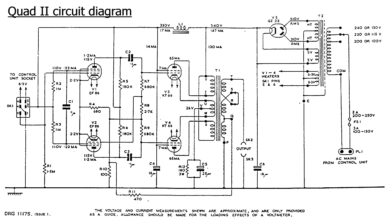

unlike mcintosh quad II use 10% turn ratio
for cathode feedback winding not a big feedback

good info here for the small 10% turn ratio quad II
cathode feedback
-for ~5kohm to 8 ohm n=22.72
-cathode feedback winding n=2.27
-16 ohm output n=1.44
1.44 not = 2.27 but not to bad
http://home.insightbb.com/~stephenwmoore/Speakers/Tube_Schematic.htm
