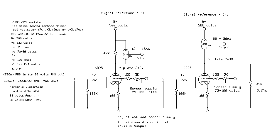

I haven't tried this, but with the talk of EL84's as drivers this might be of interest if you haven't seen it already. Has to be adjusted on a per-tube basis (screen voltage), so no simple tube rolling. However, good PSRR for a pentode stage, low output impedance, and low distortion (even at 90+ volts out) just to name a few.
Link to the full page:
http://www.pimmlabs.com/web/drivers.htm
