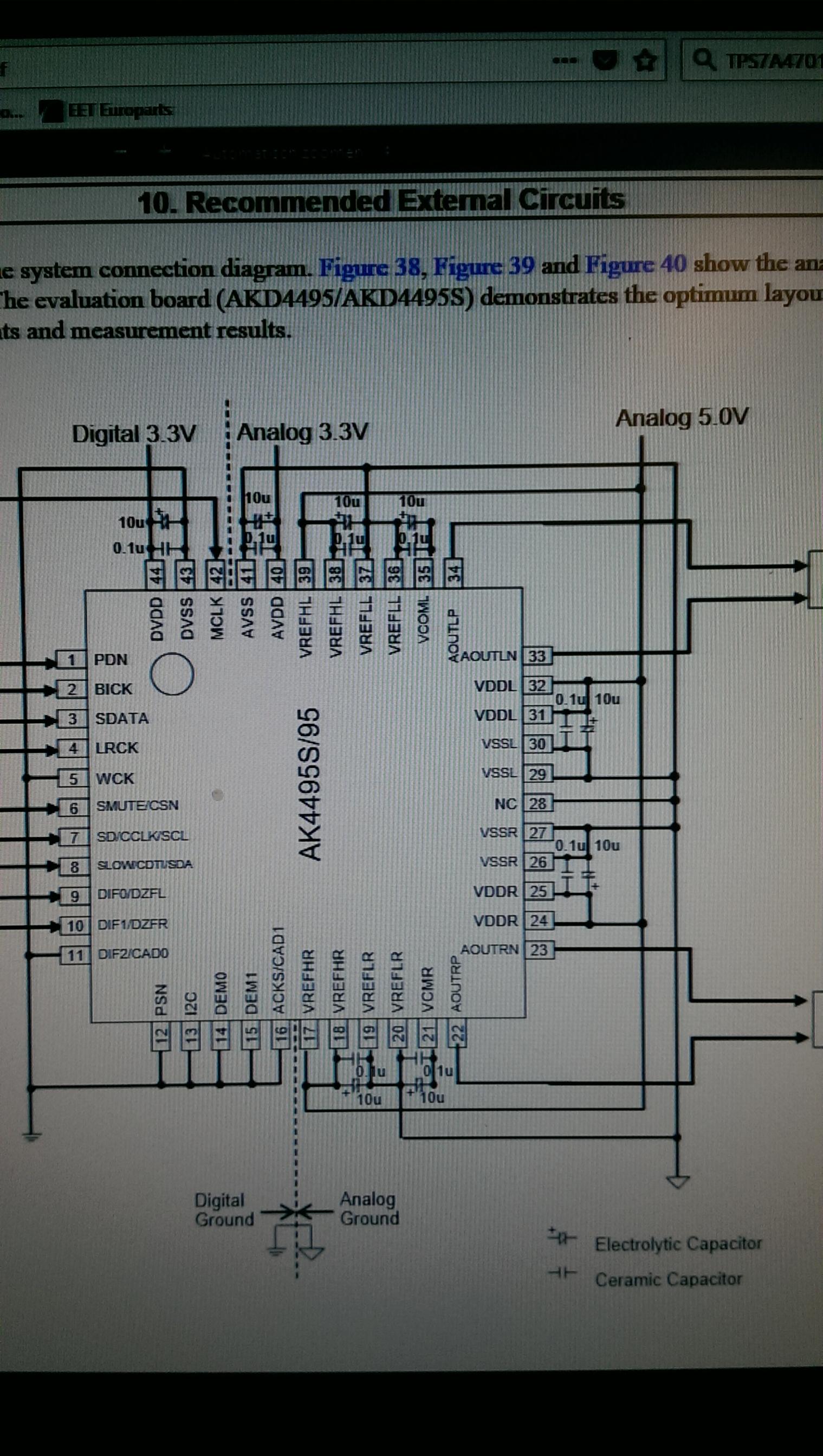

Studying the decoupling of the DAC chip itself revealed an interesting mod:
The VREFH and VREFL for both channels are decoupled with 100n ceramic parallel to a 22uF elco. According to an article on hifiduino - https://hifiduino.wordpress.com/2014/12/07/akm-verita-4490-dac/ - there's something to be gained by the value of the decoupling capacitors there.
(image courtesy of hifiduino)
I paralleled 2200uF/35V to it and that has made some good changes to the lower midrange and bass.

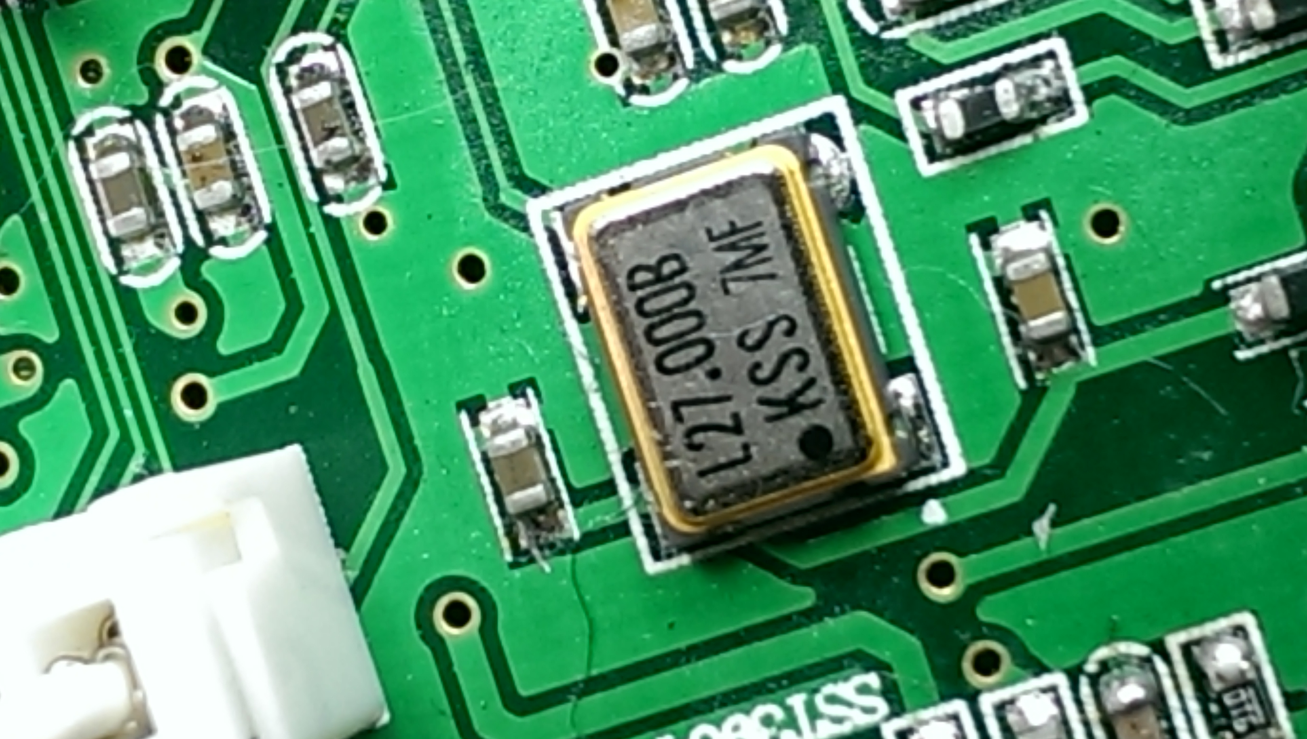

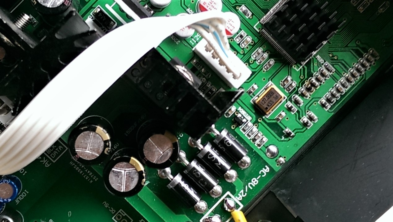

Bought a DV20A as well. Slightly different than Hans his version, powersupply for the SD/USB has been moved to the i/o board itself. Now i'm trying to identify the oscillator on the i/o board. It's a 4 "legged" SMD verion, brand : KSS and maybe it's a 27 MHz version ?? I will add a picture, a sharper one once i'm back home again.

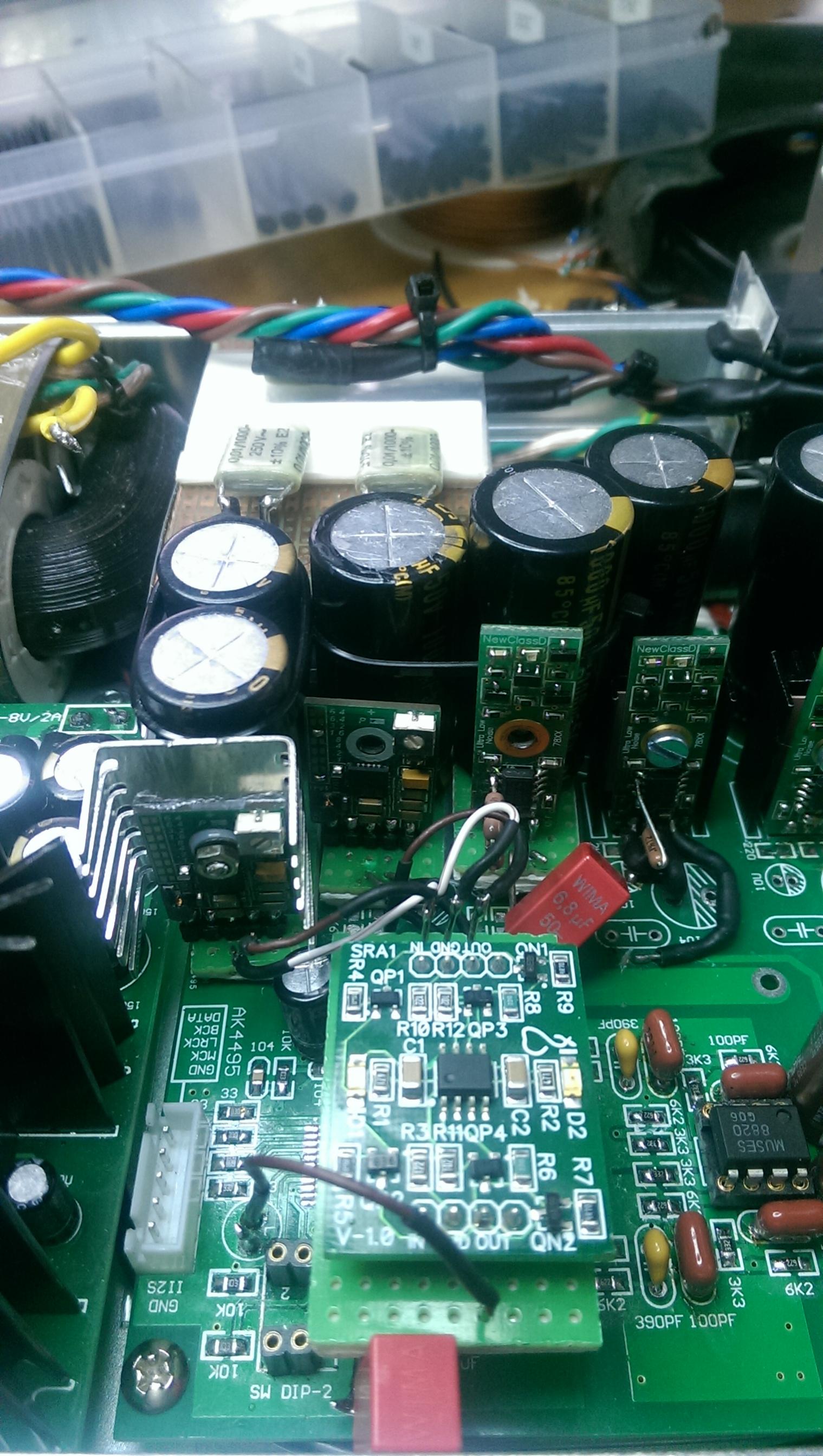

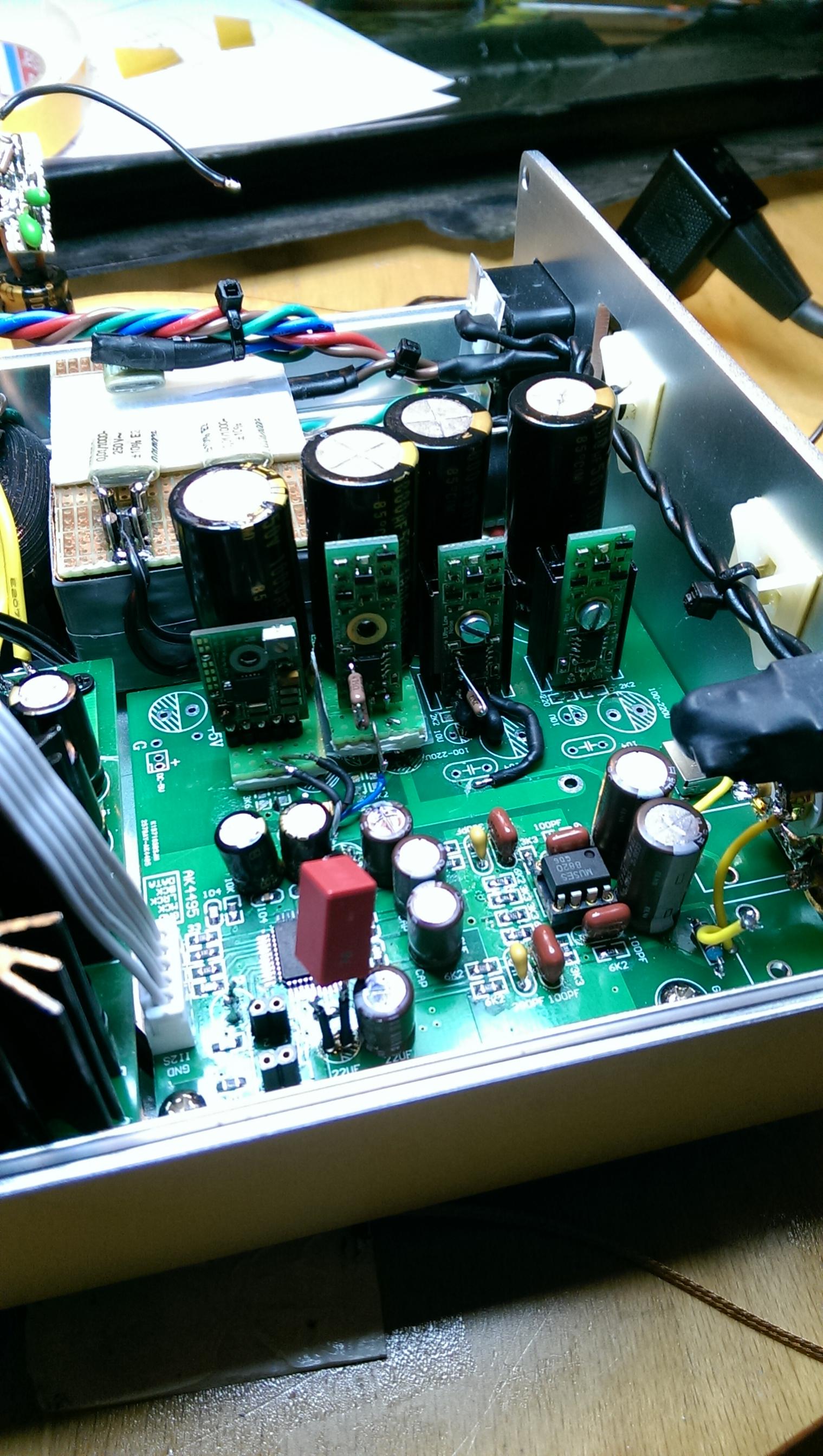

Okay , first thing that i wanted to do was to split up de powersupply for the opamp.

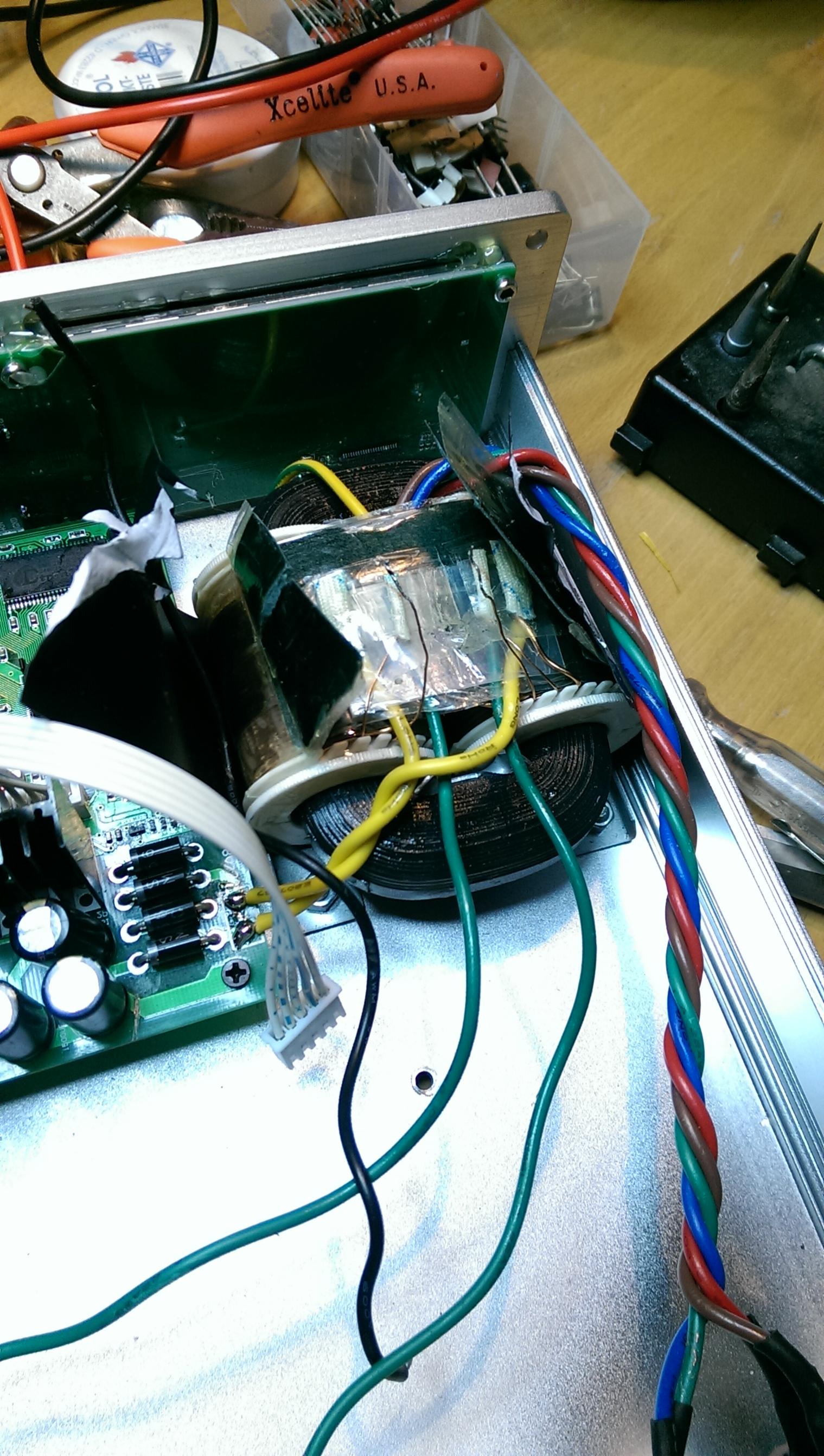

The double voltage 15/0/-15 was rectified using one bridge.
The 0 wire was connected inside the transformator with the other secundairy windings.
Using just 3 wires gave a loud hum coming from the transformer.
I had to cut the trafo open to make 4 wires for the double rectifier.
I then removed the two regulators, LM317 & LM 337 and surrounding caps + resistors.
Changed them for 2 NEWclassD regulators i had laying around.

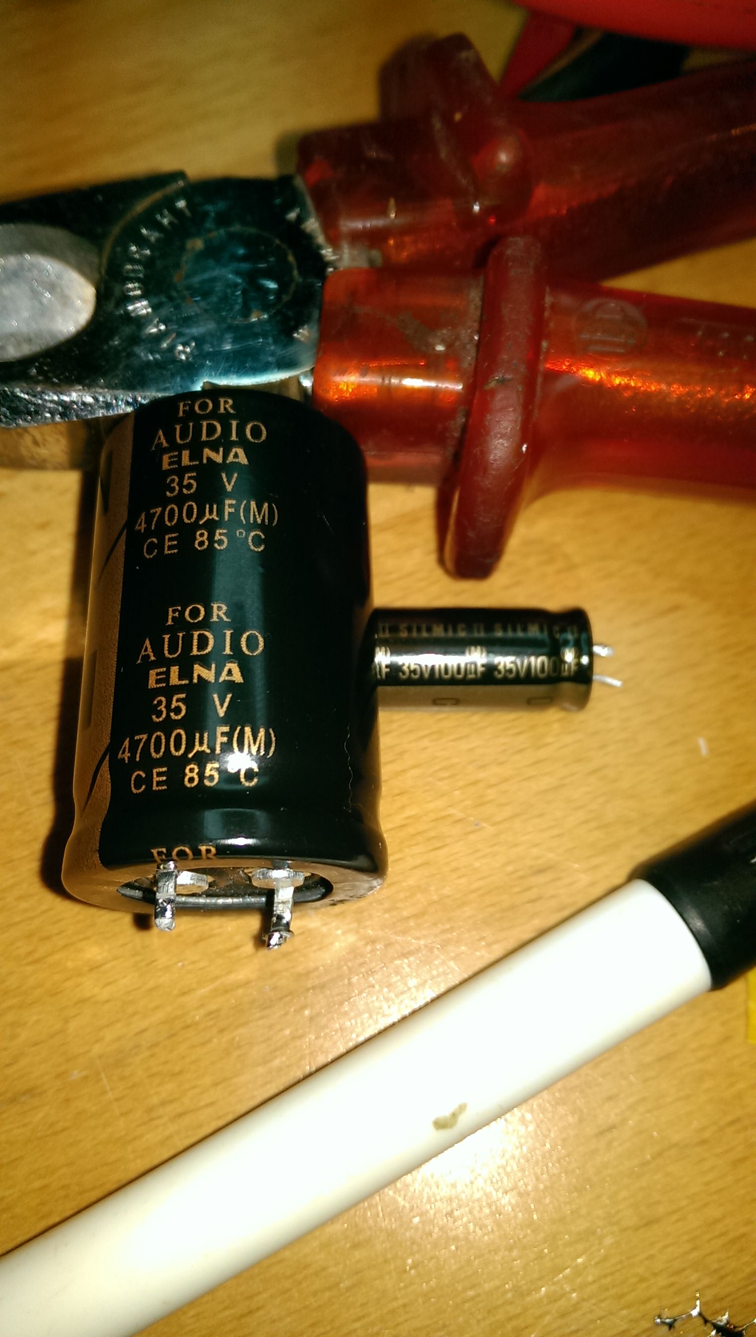

Removed the 2x "Elna for audio" 4700uF caps for 2x Nichicon KZ 1000uF
I also made a new rectifier with 8 Schottky diodes, the existing diodes were also Schottky's.
Here a picture with the 2 regulators on the right, i also changed the Wima filmcaps surrounding the Muse8820 for my favourite filmcaps.
I don't know if the capacitors are genuine or not, changed them to be sure of it.

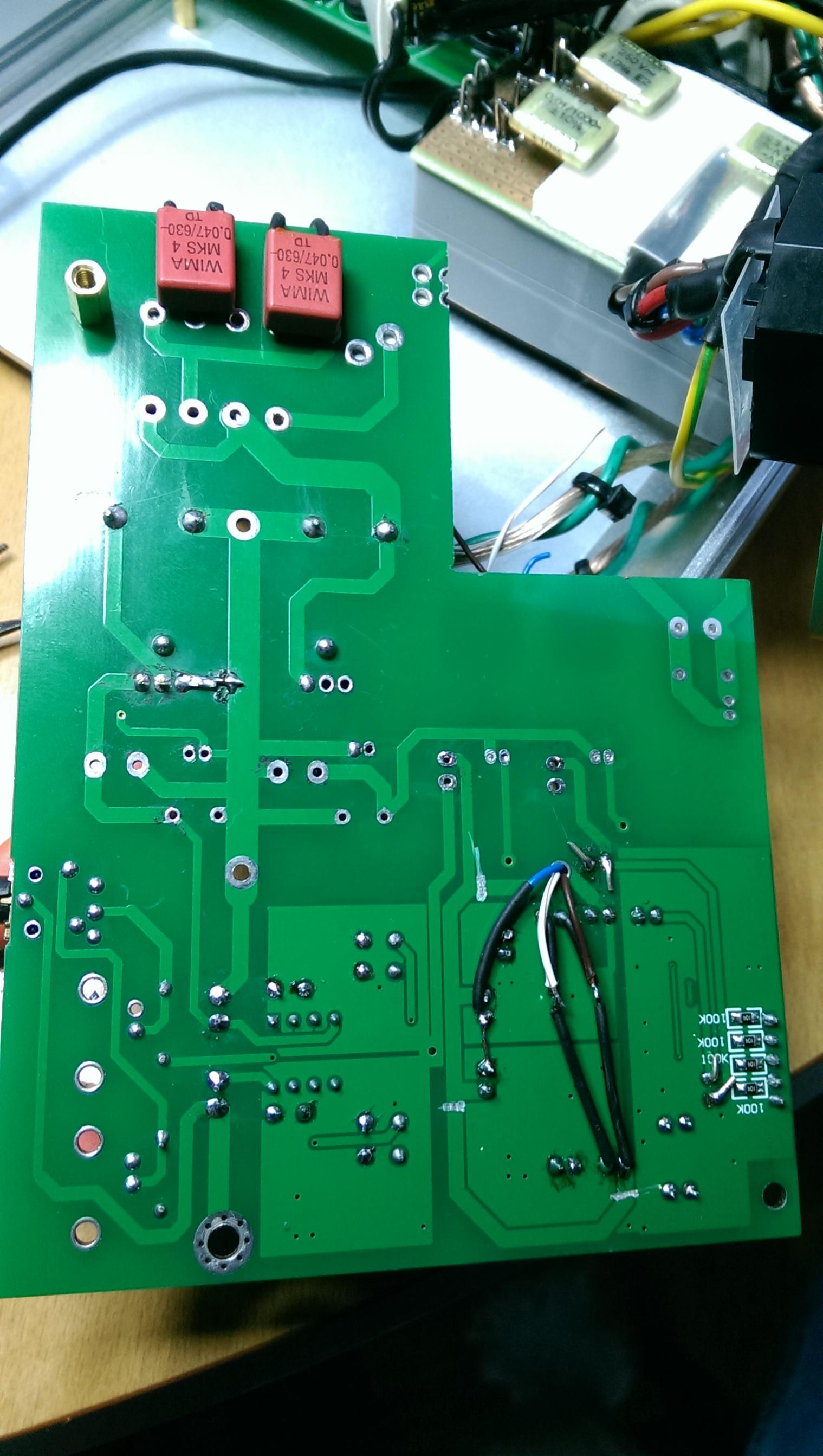

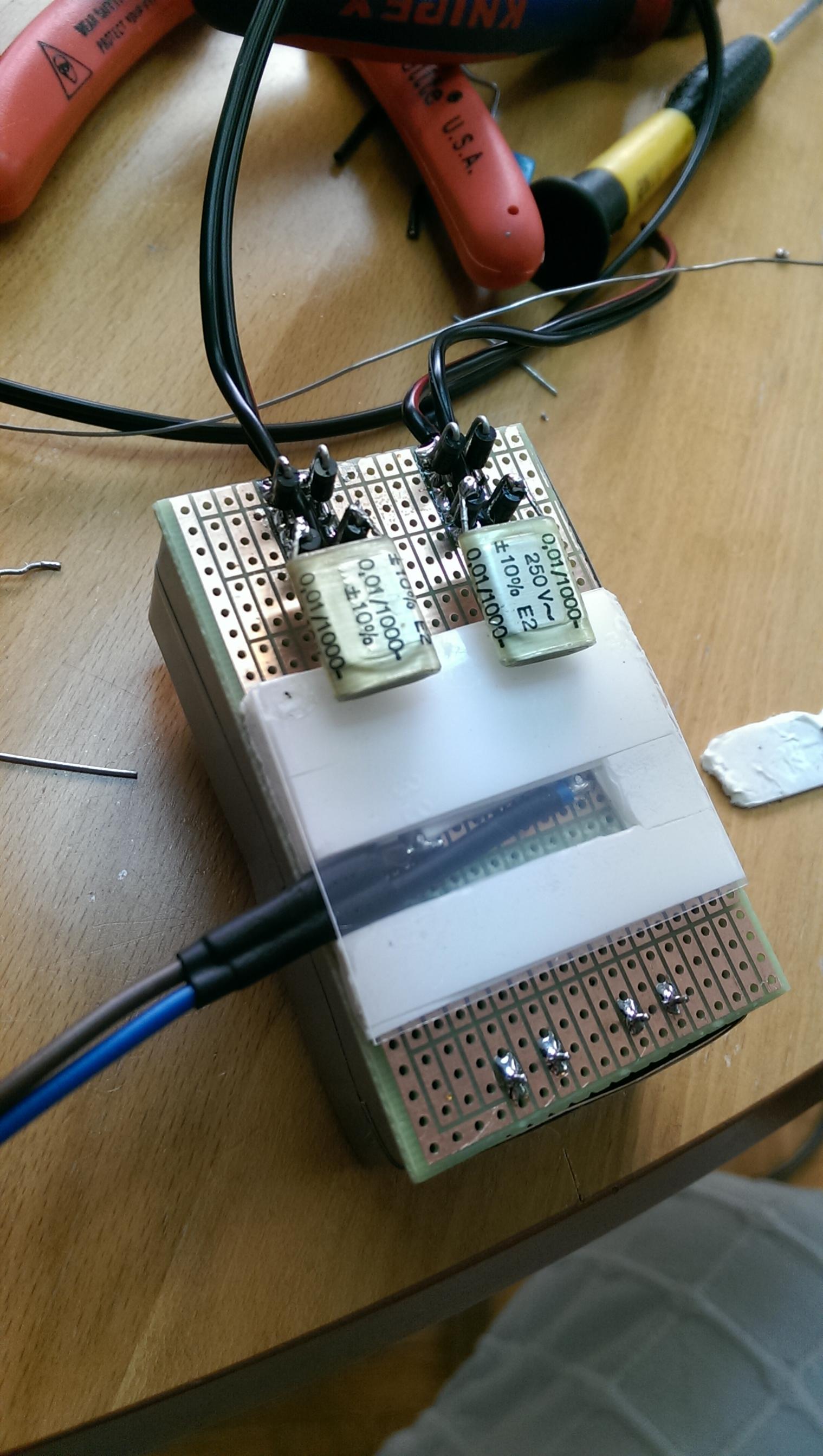

With this newer model DAC is the powersupply for the USB/Sd card /display etc. moved to it's own board. The DAC board itself remained unchanged, only without parts. So I cut the board up to make room for 2 trafo's to make 4 powersupply's.
The last picture is of a later date, there i allready changed all the elco's surrounding the AK4495 for real? Silmic 2 and Panasonic FM.
I also moved the main switch away from the rectifier, too close, it became unsafe.
Funny thing about that switch, it was placed between the 2 primairy 115V coils. That gave some problems when installing my own trannies 🙂

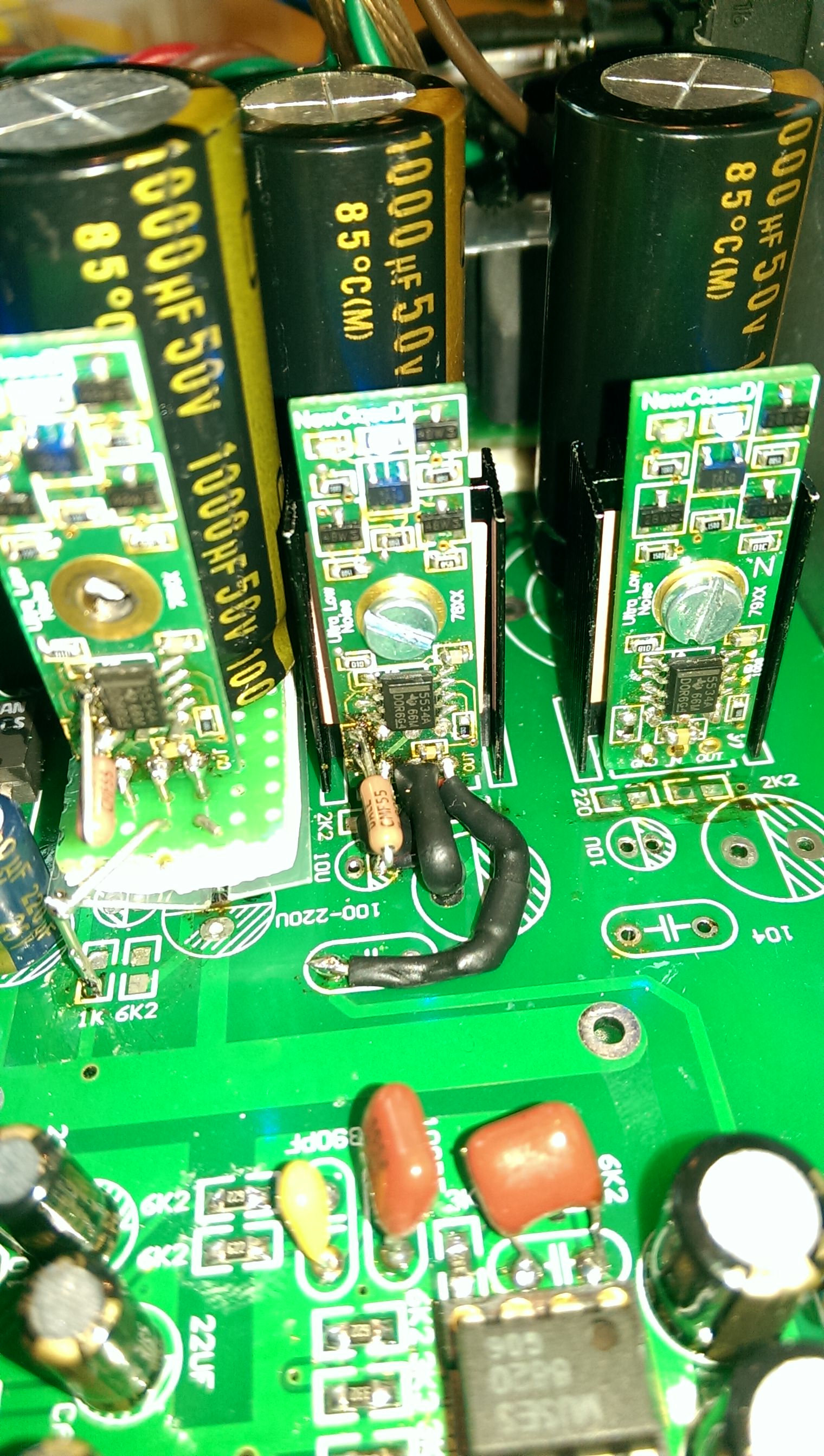

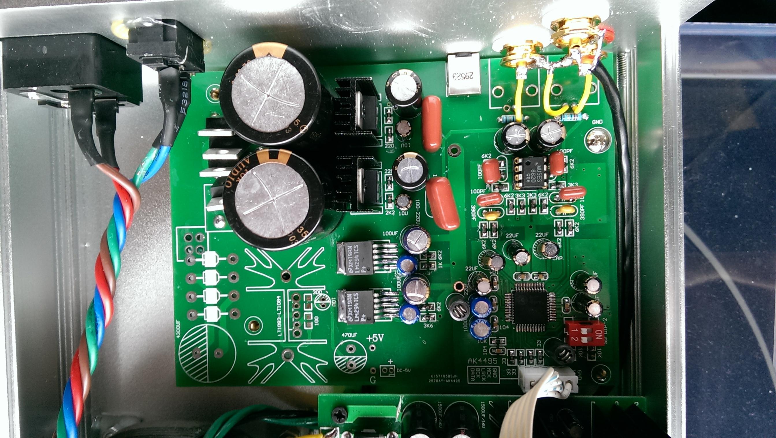

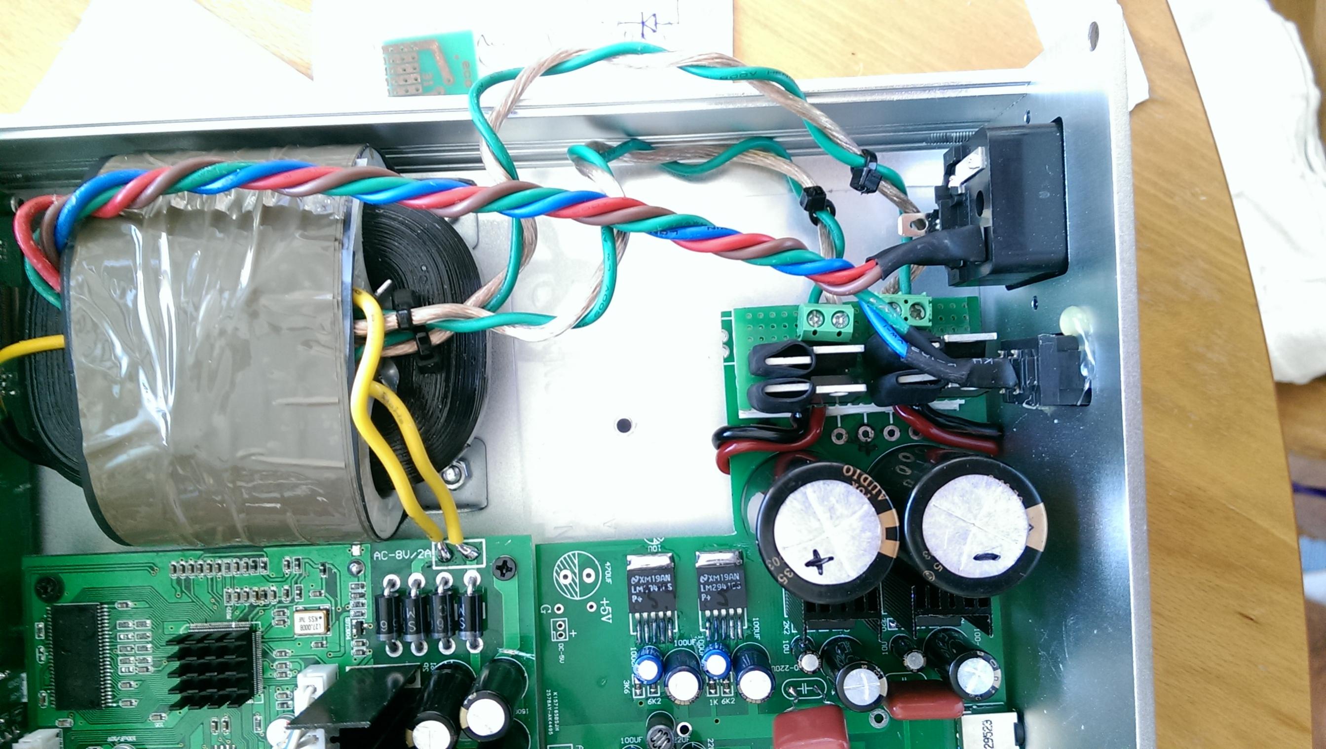

The stock transformer delivers 8V/1A to the I/O board and 2x 15V ?A to the DAC itself. There only the negative side is used to feed the MUSE8820. The positive side is also used for the opamp AND to feed 2 LM2941 regulators.
The LM2941 one the right powers VDD/L/R and VREF/L/R, the other regulator powers DVDD and AVDD. I wanted to split that up, the original supply is now only used for the opamp.
With my 2 new trannies i can make 4 power supplies. One NewclassD reg for VDD/L/R at 6.9V, a TPS7A4701 based reg for VREF/L/R also at 6.9V.
In the pictures you can see where i cut the lines.

Another TPS7A4701 reg at 5.25V was placed in the small space left. That one powers a Twisted Pear AVCC reg with 2x3.6V output. Those outputs feeds the DVDD and AVDD of the AK4495 chip. Luckily the sound improves with every change, better image, cleaner sound, but maybe a little too bright.
-As mentioned before on other threads, you can easily cut the single powersupply for analog and digital up by removing the 2 ferrite coils on the board.
- I tried the 2 big capacitors on VREF/L/R, the sound got gloomy and slow. I currently use only 2 Wima 6.8uF filmcaps.
