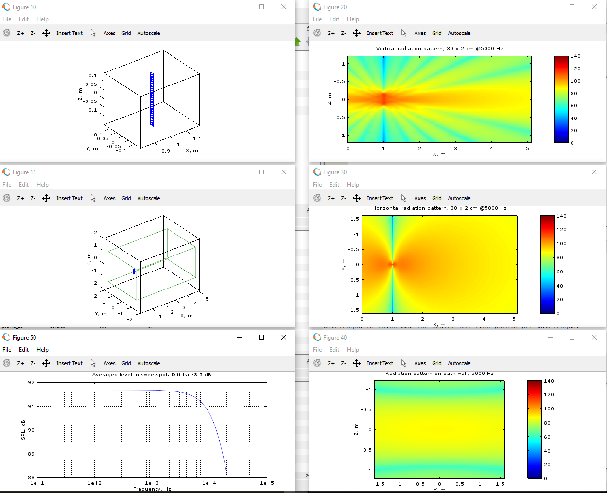

Hi everyone! I have made a little script to calculate the sound radiation pattern from sources of different shapes. I think this could be of interest to more people.
In short, it's a Matlab/Octave script that calculates the sound pressure from a threedimensional source. The source is approximated by an array of either monopoles or dipoles.
You can download it from Github:
https://github.com/HEnquist/RadiationPatternCalculator
To run it you need either Matlab or Octave. It runs fine in both. Matlab is a bit faster, while Octave is open source. Get it from here: https://www.gnu.org/software/octave/
Put all the .m-files in the same folder and run "radpatt_main.m".
What the script does:
- calculates the sound radiation pattern from a user defined source in three planes (horizontal, vertical and at back wall).
- calculates the frequency response at a user defined sweetspot.
- if enabled, shows the interference and channel balance between the left and right speakers
Just to avoid confusion I'll also mention what it doesn't do:
- it doesn't handle reflections from walls, floor, ceiling or speaker baffle.
- for dipoles it doesn't handle the path length around the baffle.
- it doesn't take cone break up into account.
The attached example is the output for a 300x20mm dipole at 5 kHz.
There are a few more examples in the thread Yet another DIY AMT by solhaga.
Thanks to solhaga for valuable input and help in testing!

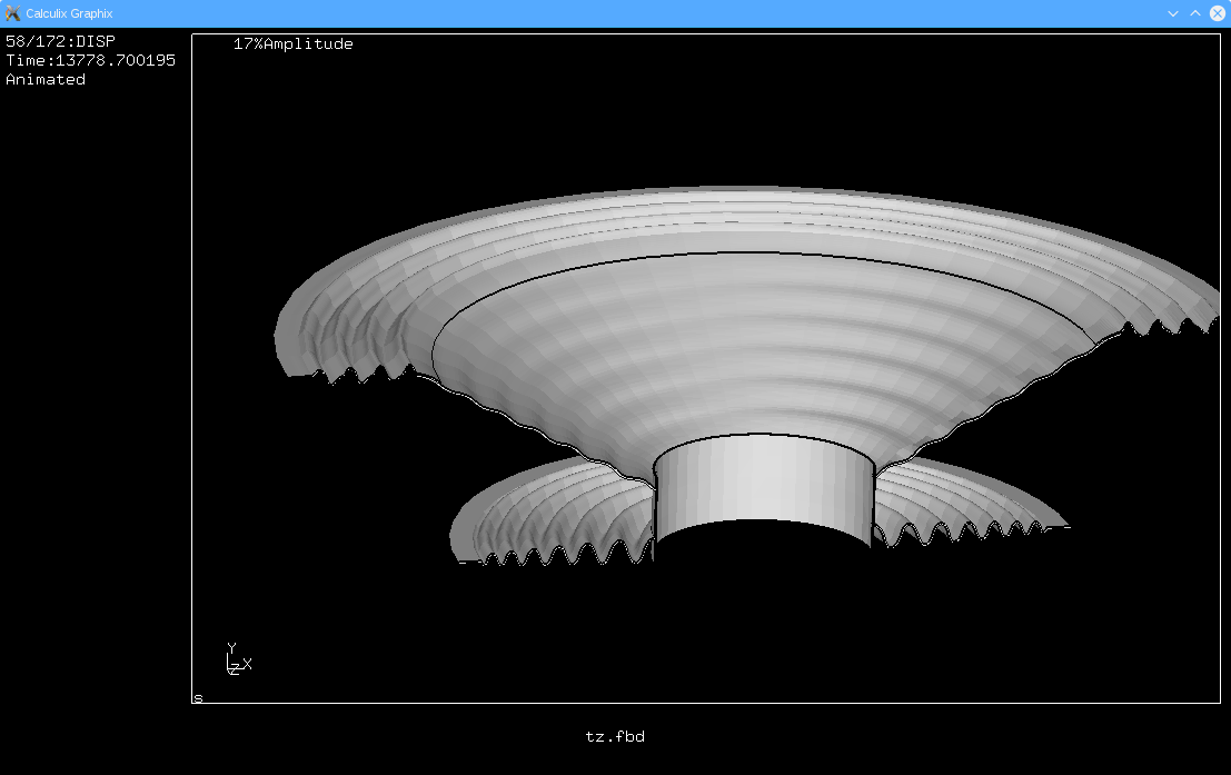

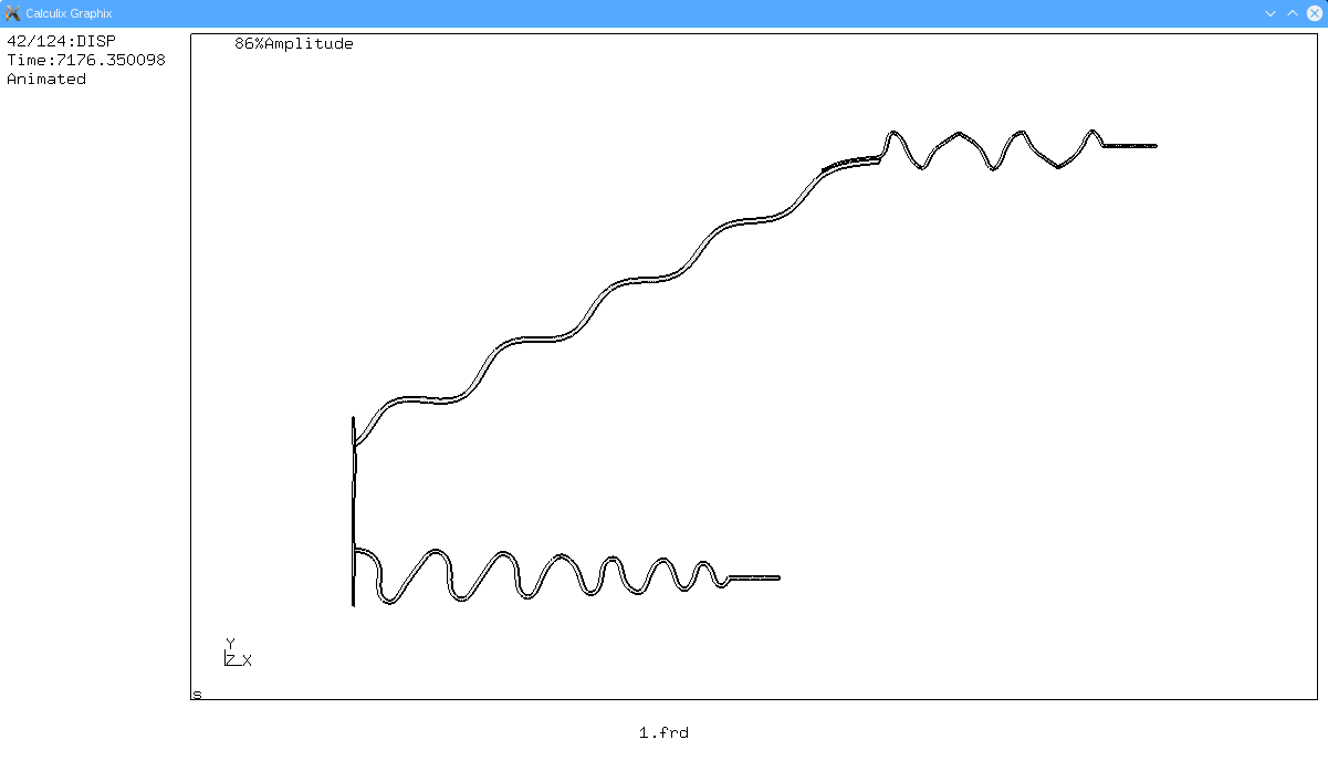

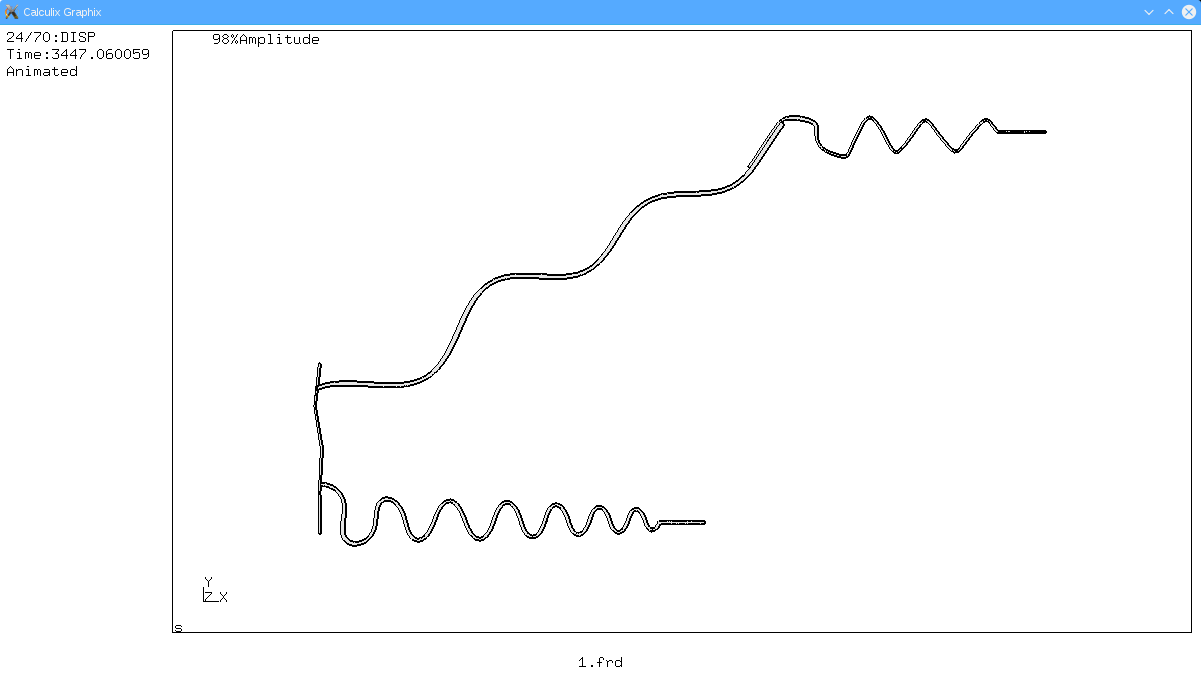

If anyone has any ideas about doing breakup modes in a woofer cone I would also be very happy to see that.
You'll need some FEM software to do that. I have access to Comsol at work and have played a little bit. I put up a few pictures here (via google translate from swedish..):Very interesting. This I will have to look into.
https://translate.google.com/translate?sl=sv&tl=en&js=y&prev=_t&hl=en&ie=UTF-8&u=http%3A%2F%2Fwww.faktiskt.se%2FphpBB3%2Fviewtopic.php%3Ff%3D10%26t%3D63389&edit-text=&act=url
Another option is FINECone which is a specialized FEM software for speakers: FINECone - Speaker Design software - Professional Products - loudsoft
I haven't searched so I don't know if there are any good open source FEM packages that could do this. The commercial programs are quite expensive.
Z88 and Calculix are the two open source FEA programs that we are working with.
Calculix has the benefit of using the ANSYS naming methods.
By "we" I mean my programming friend and me in the advisory position of let's see if it makes sense side of things. I'm really not that capable of a programmer any more.
My high level language was Turbo PASCAL 30 plus years ago.
The programming fluency has disappeared with my hair!
We have done some successful comparisons with COMSOL and OPERA as well as Vector Fields with a combination of the two open source FEA programs and FEMM for the magnetics.
ELMER is being looked at as it will do full 3D FEA in magnetics.
I discussed this method and concept of combining Open Source programs with Peter Larsen a few weeks ago when I was at the Loudspeaker Sourcing Show in Nansha China. He is great gentleman to talk to. And willing to share insights as to what worked well and what ended up being a dead end.
He took 6 years to refine and get Fine Cone working. We have been plugging away at it for 6 months. The FEA field is very much different than it was years ago.

I just rediscovered Code_Aster. Very comprehensive list of capabilities.
Looks very capable.
Might be enough to convince me to make my computer a dual boot system. Linux seems to have all the best computational tools.
Looks very capable.

I just pushed a new version to github.
The main difference is that it's now possible to have several sources active at the same time. The idea is to be able to play with for example double woofers or what happens around the crossover frequency. Each source has a level and phase setting.
Another change is that I added a parameter to set the wave speed in the source. This will give more realistic results for cones by letting the outer parts lag behind the center. It's a bit untested so please report back if you find any strange behavior.
This is what loudspeaker with an OB woofer and an OB AMT on top of it can look like.
Note that in the SPL diagram the AMT contributes over the whole spectrum; there's no simulated cut-off frequency.
It can still give some information if one experiments with for example the tilt of the elements.
The same objects at 20000 kHz.
Here I adjusted the tilt in order to get the most of it at the sweetspot.
Of course one has to make real life adjustments, I was thinking of having a piano hinge between the AMT and woofer.
So I´d say that this is a pretty awesome software/script.
You might even simulate line arrays, even CBT ones.
