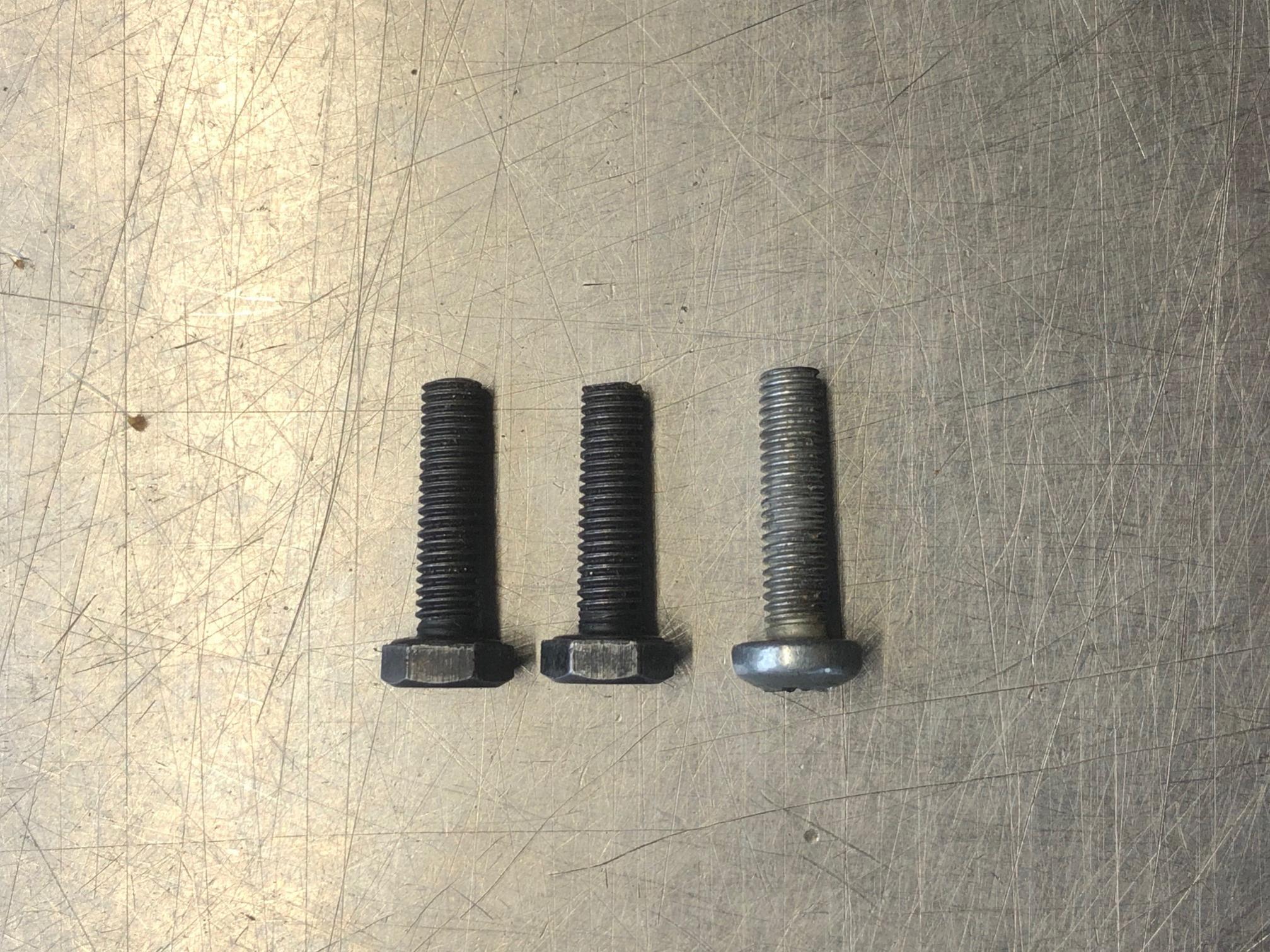

Hello. I’m in search of Screws/bolts for fixation of Kef B139. I bought the speakers (Kef Concerto) back in 1973. Recently I replaced the T27’s and then I noticed, 2 screws/bolts , of the B139 woofer were missing …
(please don’t ask me how this is possible..)
I searched the internet for days now, but I even can’t find which kind of screws this are.
I do know that the screws have withworth thread , but there seem to be 3 different kind of withworth-types..
The screws have a lenght of about 2cm and a diameter of approximately 5mm. (see pictures) .

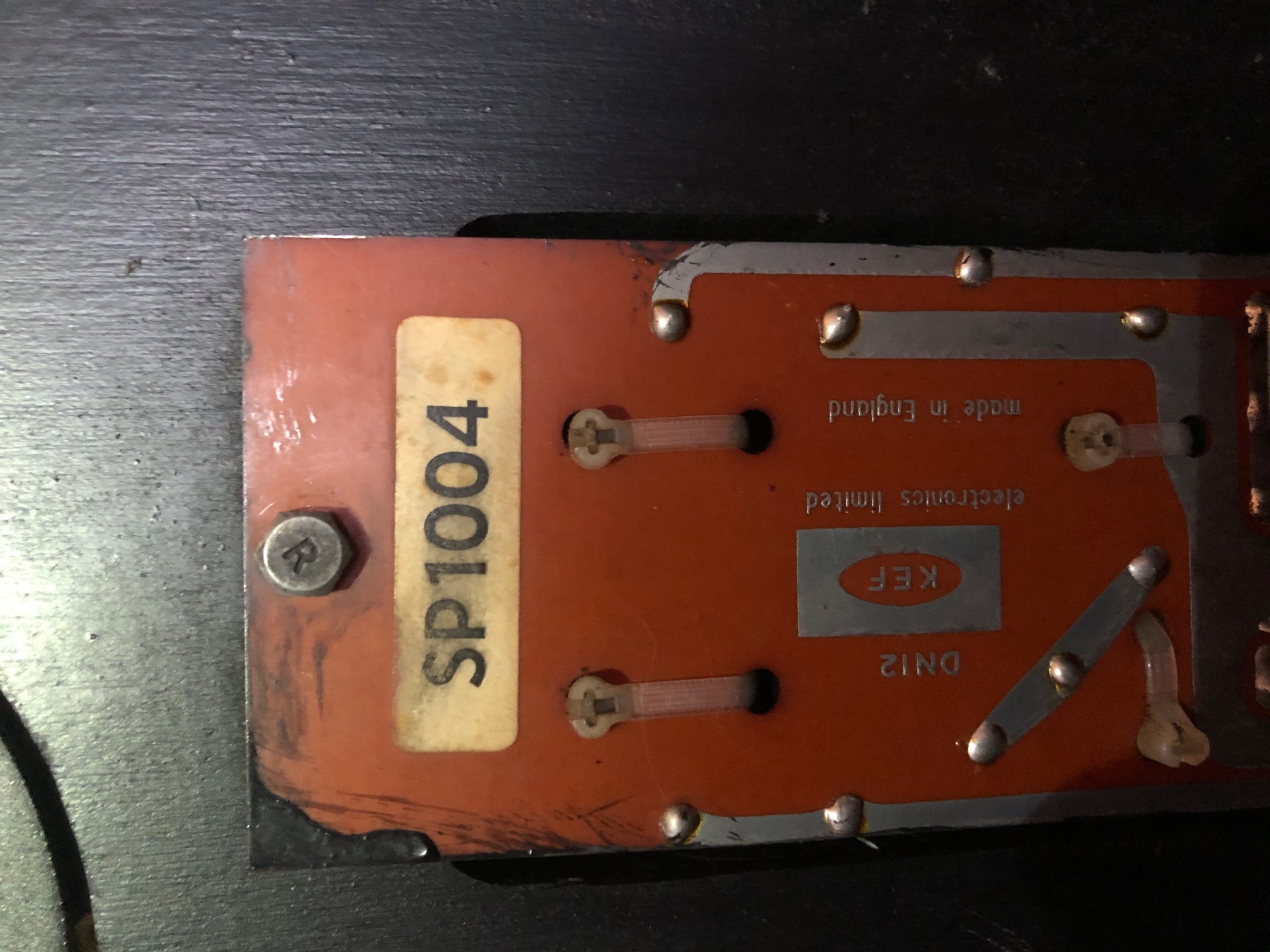

The same screw is also used for top fixation of the crossover-filter SP1004.
Can anyone tell me more about these screws , or perhaps someone has a few spare or identical screws they want to sell to me?

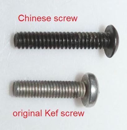

So, You live in Europe like me and want Philips "round pan ?" imperial threaded screws.
Some Hardware stores have them available, but not all sizes.
Did You try Leroy Merlin or similar store ?
Chinese stores also have all things that we can think... I buy there black screws.
Try also a machinery store. Some carry a huge selection of screws.
I presume they attach to a T-Nut.
https://www.amazon.com/Bolt-Dropper-Pronged-Climbing-Cabinetry/dp/B01MSVU3WF
Change the nuts for 5 mm and use 5x20mm screws.
You can also get a larger Hex or Umbrako screw and screw it directly in the wood.
In this case make sure You don't overtight them or they loose grip.

Eric, to be sure you really need to measure one of the existing screws with a thread gauge.
If they are the same, in the short term, why not take the two screws out of the filter and use them on the B139 and temporarily put some gaffer tape on the top of the filters.
Also, have you tried emailing KEP Support? Even if they don't have any screws left, they may be able to confirm what thread was used.
This idea also already crossed my mind Levistubby.
For about €2 , I now ordered 5 screws in China.
When these arrive, I will use the original crossovers-screws for the B139 and use the Chinese screws for the crossover-filter.
I didn't know Kef support existed 😱

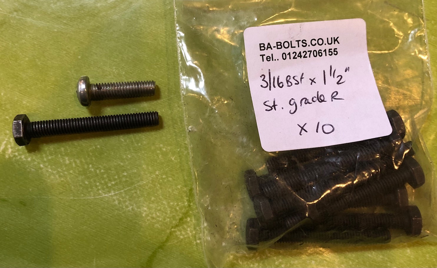

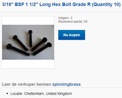

I've found another seller on ebay and bought these screws :
3/16" BSF 1 1/2" Long Hex Bolt Grade R (Quantity 10) | eBay
To be 100% sure before I bought those, I asked the seller about these screws and he answered : "yes these will fit 3/16 bsf is 32 tpi will do the job. You could also use a 2BA thread which is the same thread type."
So :xfingers: , but I'm very confident.
So thanks again, I'll keep you posted.
Have a nice day.
Eric

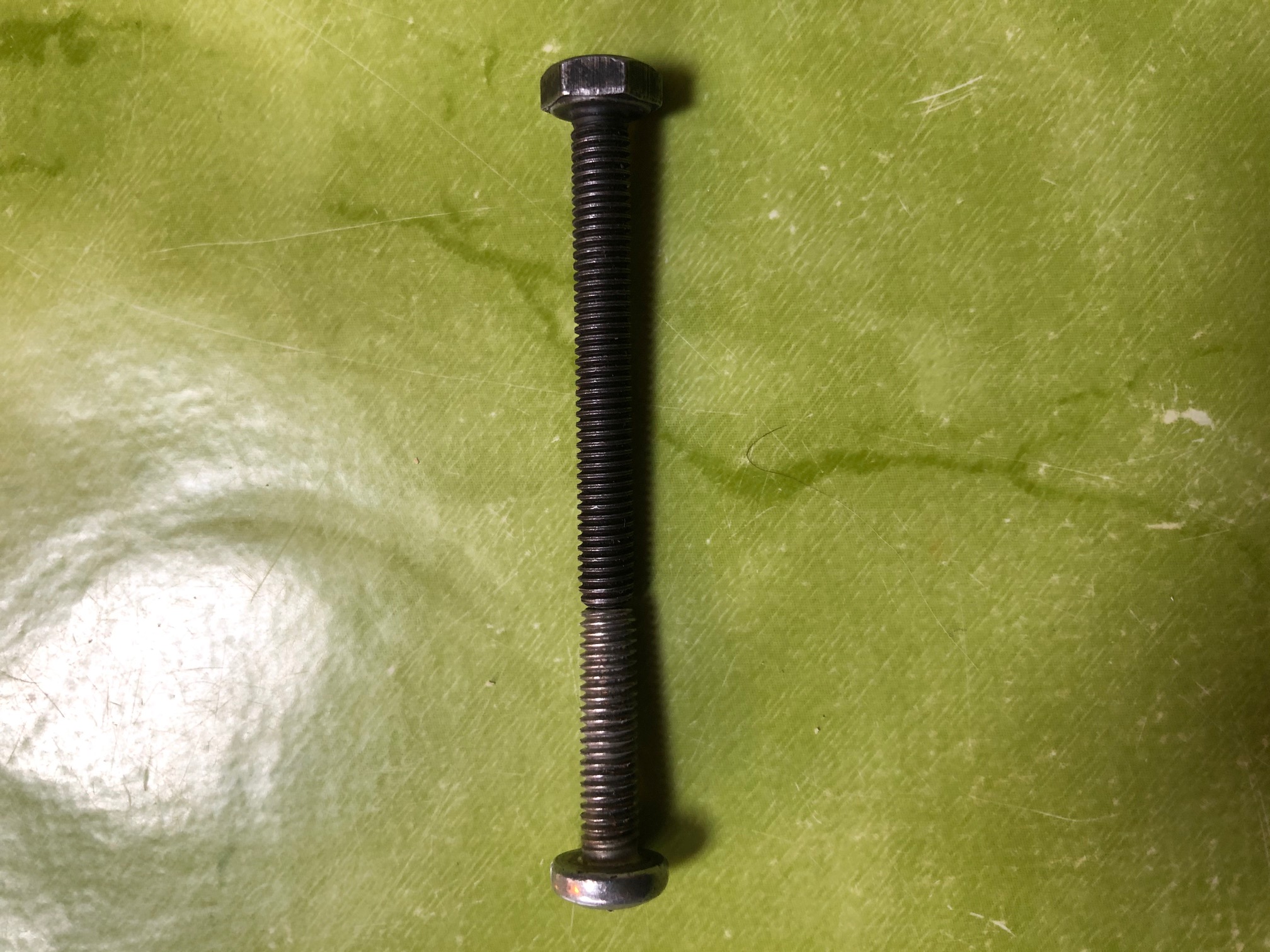

Hello everybody :wave:
Today I received the bolts that I had ordered.
And yes, they fit :nod:
So mission (finaly) accomplished.
Thank you all for your help :up:
