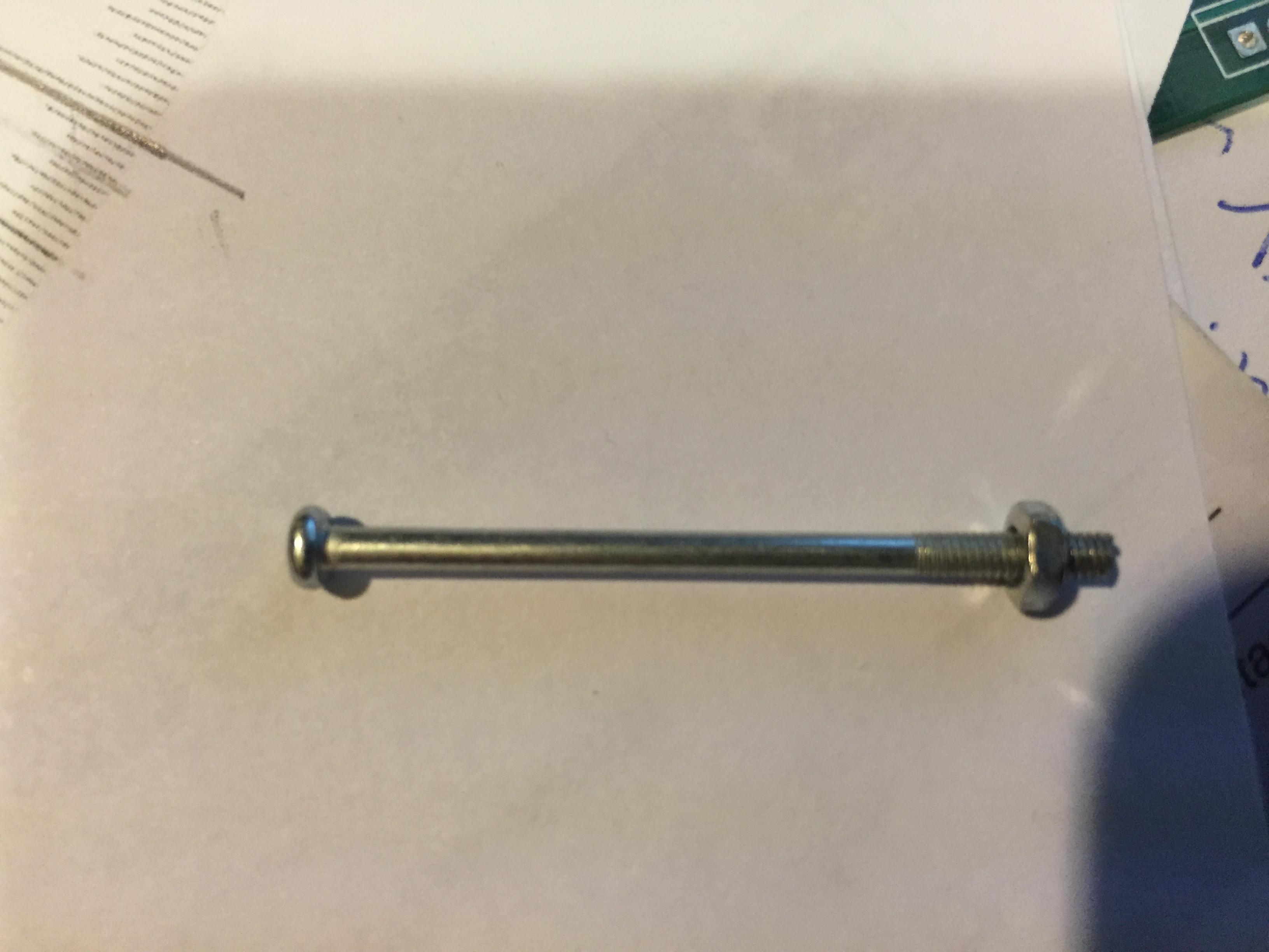

Oh, then "shoulder screw".

That appears to be an odd head geometry on that one, hopefully you can substitute something like this;

but the length need to be 2 inches and then thread size is not matching

A screw has the threads all the way to the head, but the last 1.5 threads may not be fully formed.
A bolt has a plain shank and then the threaded portion. Again the last 1.5 threads may not be fully formed.
A shouldered screw/bolt has a plain shank that is larger than the screw thread size.
There is a version of this that does not have a pronounced step, between the thread and the shank. I don't know the name for this.

Okay, so you need 2 inch length, with 1/2 inch of thread.
What is the thread size? and count?
Did ya try to ID at any big box store?
I've seen them (one) before, but can't recall on what, to what,
what does it go to?
Take a pic of the head end, on end so we can see what goes
in it to drive it. Many say Phillips when they are the driver
or reed and prince, or the ones from Japan/Asia...JIG, JIP, JIN ? or so.
Andrew are you referring to something like Cosworth Engine type bolt?
or
A socket head cap screw that has a small fillet radius?
The 1 to 2 ending threads typically called thread runout.
On very high quality bolts/screws that are mounted in
tension, we'll find a smaller diameter shank which has less of
a change of breakage.
If the blot/screw is mounted in double sheer (aircraft for example)
you don't want to use them with smaller diameter shanks....the load
is cross wise to the fastener.
Finally, we want rolled, not cut threads.

could be. There are many specialied bolts that are turned down where there is pure tension that maintain full diameter where a joint places shear on the bolt shank.Andrew are you referring to something like Cosworth Engine type bolt?
I think this is more for weight saving..............

I kept as a souvenir a rolled thread socket head cap screw that must have got misaligned between the rollers and ended up with a double helix instead of a single thread. Somehow it got passed by QA.If the blot/screw is mounted in double sheer (aircraft for example)
Finally, we want rolled, not cut threads.........
It resembles the straight spokes BMW used in the wheels of their very last airhead twins. But I suspect the depicted screw might not be long enough for this duty.
