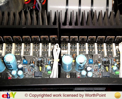

I have created the schematic. I note, there was embedded a screened cable in the feedback loop.
But not in the kind as to find about
http://www.diyaudio.com/forums/solid-state/181918-cable-part-feedback-loop.html
Instead this was the cable connected as follow:
- One end of the 40 cm long cable was created a connection (short wire) between the hot wire and screen.
- From the other end goes the screen to the NFB resistor and the hot wire to the NFB Input (inverted input of the differential input amp).
- Additional the screened cable is wound in the kind of follow picture:
http://estreo.com/foto/l-Klassische...tenVerwendetdieTipExchangeTechnologieFXL1.jpg
I have this never see before and I don't find any advicves in audio amplifier basic books concerning the target for this.
Who knows more about pros and cons concerning this?
Thanks for your advices.

If I understand you correctly, the shorted cable was used as a connection between the feedback resistor and the feedback input. This provides a connection for audio signals. In addition, it will:Instead this was the cable connected as follow:
- add a very small inductance to the feedback resistor (a shorted coax looks like an inductor at low frequencies) - which will probably do little harm
- add a short antenna to the feedback point - even coiled up it will still pick up some RF
- do strange things at VHF frequencies, but fortunately the amp is unlikely to have any gain up there so little harm will be done
I am sure the 'designer' will have a 'good story' to tell. It will almost certainly be complete bunkum, which he may or may not realise himself. If there is any audio effect it will come from the RF pickup adding spurious 'air' (i.e. down-modulated interference) around instruments!

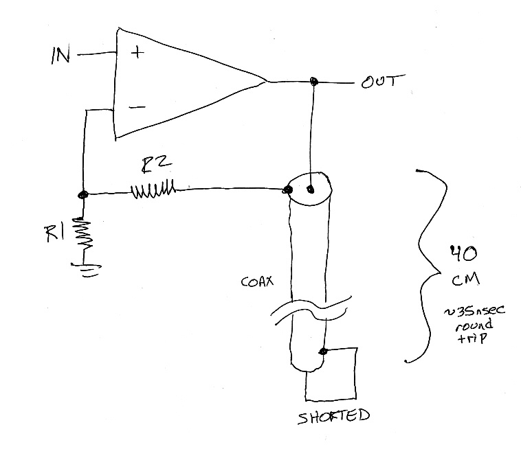

Could we have a diagram to confirm exactly which circuit we are considering? There are 12 ways to connect a symmetric coax into 4 circuit nodes. Some of them don't make much sense, but that doesn't mean someone is not using them!

BTW, inserting pure delay in a feedback system is about the worst thing you can do for stability
Like this?
Above 750 kHz or so, the phase shift contributed by that roundtrip delay, begins to exceed ten degrees. Yikes.
Yes. The only different is the direction of connection. Screen is connected to the output and the hot wire with R2. But this doesn't matter, so I think.Like this?
