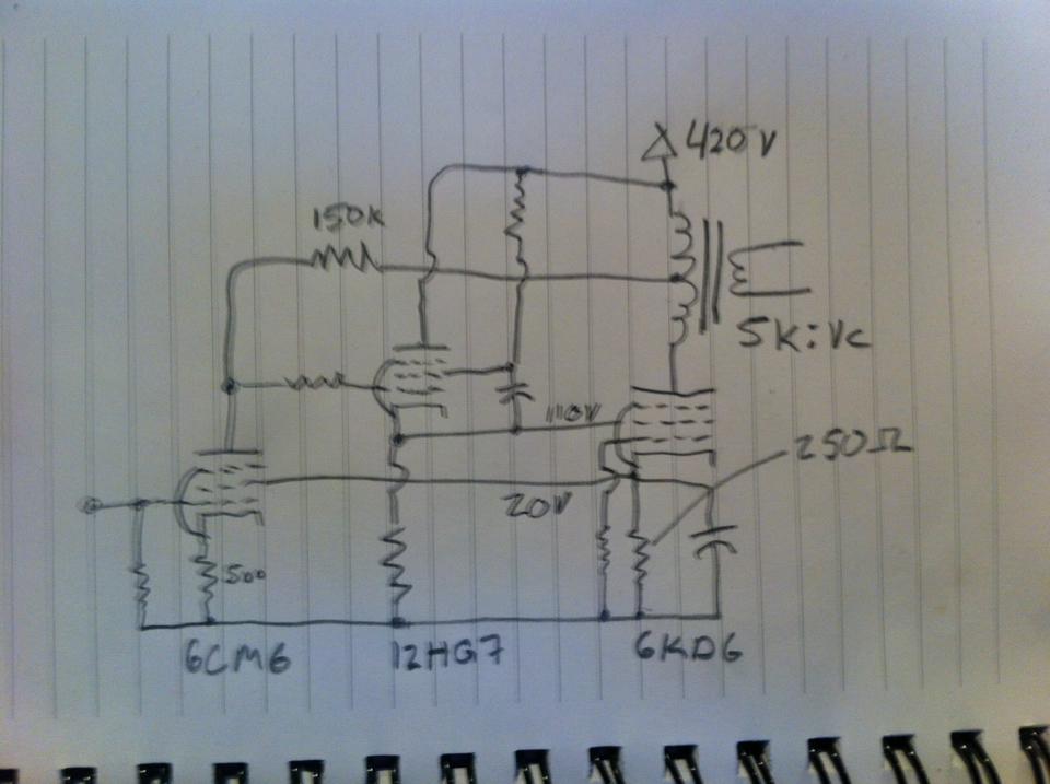

I've been working on this amp for some time. It's a little tricky picking operating points, since I'm working outside the range shown on the data sheets. I wound up having to tweak a few resistors. The values shown are the final design.
The input tube is a 9-pin version of the 6V6. I chose it because it gives what I feel is a reasonable operating point with only 20v on the screen. This allowed me to use a feedback loop from the output tube cathode to the input tube screen, holding operating points stable for DC operation. I nicked this idea from the Mullard 3-3, and use it quite liberally. I like using pentodes as input tubes, especially in DC amps. They work well at lower plate voltages, and have plenty of gain to do the job with one stage.
The output tube is a sweep compactron with the signal fed into the screen grid. I had a few on hand, and I thought it would be fun to try screen-mode operation. I applied bias to the grid to make the screen bias voltage more manageable for DC operation. My design goal here was to use as little grid bias as I could get away with.
The amp employs feedback similar to Schade from the output transformer's UL tap. This is used primarily to lower the output impedance. Screen driven amps are said to be quite linear already. Taking a wild guess at the 6KD6's screen tranconductance, I would say the feedback yields a plate impedance of just under 1kOhm.
Not shown in the schematic is a diode in the cathode follower. It is between the grid and the cathode, and it prevents excessive positive grid voltage as the amp warms up.
On a final note, I think I may have stumbled on a novel form of partial feedback, at least by degrees. It isn't exactly Schade feedback, since that is applied to the grid of the output tube. Ultralinear is applied to the screen, but the screen isn't driven in that scheme. It borrows a bit from E-linear, but, again that doesn't drive the screen. It may have been done before, but screen driven amps seem pretty uncommon, and I haven't seen it.

Interesting.
But only 20V on the 6CM6 screen? Must not be running much current there. Another 12HG7 or 12HL7 for input stage could run with good current using the 20V. (and with good V to I linearity from high gm) Looking at screen driven TV sweeps on the curve tracer, I've seen the best linearity when the g1 was near 0V (wrt cathode). Probably something to do with the aligned grids.
The UL tap is usually well coupled to the secondary (as opposed to the plate taps) for UL use, so should work well for N Fdbk, as long as it is stable.

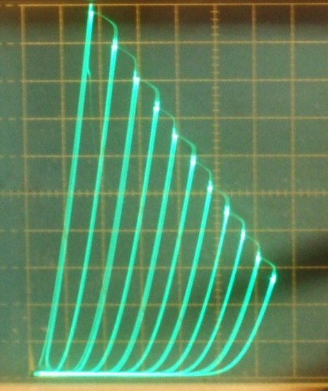

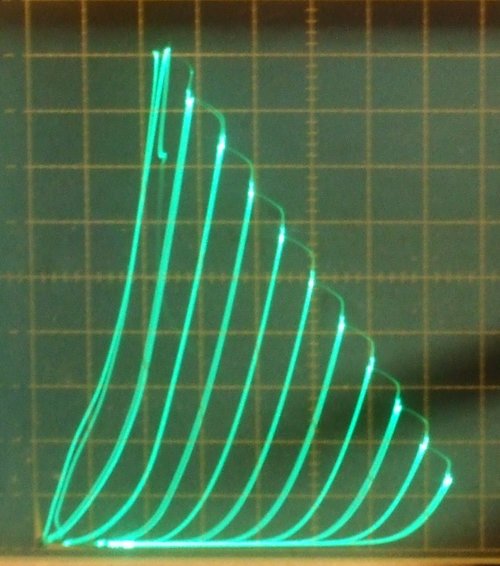

26HU5/6KD6 pics, 50 mA/div Vert, 50V/div Horiz
a) triode Mu of 4
b) Schade gain of 4 approx.

The 6CM6 is running around 2ma. I considered some higher gm tubes for this position: 6BQ5 or 6HG5A for instance. With 20v on the screen, these tubes would be going into cutoff at less than 1v. I was concerned that grid current could become a problem. The 6CM6 has rather civilized looking transconductance curves with a gradual transition to cutoff. I was able to bias it at 1V and keep it in what I hope is a reasonably linear range of operation. The input tube in this design needs to handle +/- half of its bias current for full output. I like to give it as much breathing room as I can.
Do you have any sweeps where the screen is driven negative? The only thing I could find was Svetlana's data for their version of the EL509. It showed the lines bunching up around 0V.

I'm afraid I haven't invested in anything more advanced than a DVM. My best guess from data sheets is 10-12 watts at 1-2% THD, with DF around 5. I expect the input tube contributes most of the distortion, and that is fairly low ordered. My guess is that for a given percent of feedback, Schade would be more effective than this at reducing distortion and output impedance since transconductance is lower for the screen than the grid. However, screen drive seems more linear than grid drive, so the end results might be close enough.

Thanks for running the curves. These make me think it may well be worth the effort to change the output tube to 0v g1 bias. In addition to the clearly more linear operation, my data sheet indicates that the screen would be a bit easier to drive.
I notice the 6KD6 equivalent seems to be the least bad of negative biased sweep tubes. I'm not especially surprised by this. Most sweep tube curves show a hump in the screen current with screen voltage between plate voltage and cutoff for negative grid voltages. The data sheet shows screen current rising more rapidly in this range for the 6KD6, but no hump.
