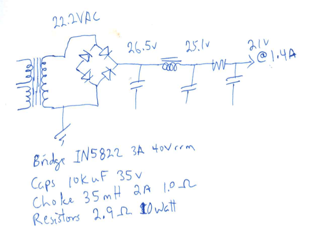

I built a linear supply for a Pass ACA amp. I don't understand the rectified voltage. It is much lower than I expected.
I attached the schematic.
My question is why is the voltage after the bridge rectifier 26.5v instead of 31v? My experience is that voltage would be [(22.2VAC x 1.4) - 0.6v].
BTW, the filtering seems to work pretty good.

Wrong ground connection on the schematic above.
Disconnect the ground from the secondary winding.
Instead connect the ground to the rectifier, at the left corner of the square.
Also connect all 3 capacitor lower leads to ground, along with the load.
Post the corrected schematic here before you change the actual circuit.
If your circuit is already built correctly, and the schematic is just wrong,
lower than expected voltage can be due to many things.
Load too heavy for the transformer. Low AC line voltage. Too small first filter capacitor
What is the transformer secondary current rating? Should be a couple of amps or more.
What is the transformer VA rating? Should be 50VA or 75VA.
The series resistor before the last capacitor is too large.
It drops 4V at 1.4A, and so is probably about 3 ohms.
Instead use a smaller value, 1 ohm or less.
In fact you may be better off with an even smaller value, say 0.22 ohms or so.
That would also waste less power.

Yep, corrected schematic attached.
Line voltage is 120VAC as expected.
Too small first filter capacitor.
10,000uF 35v. Could this be the issue?
20v @ 5A. It has a 100watt rating. Under load it is measuring 22.2VAC.
My question is why am I seeing 26.5v after the bridge rectifier?

The coil is 1 Ohm. You loose 1.4V over the coil. You loose 4.09V over the resistor. That is 5.5V. 5.5 + 21 = 26.5V so that is as calculated and in reality. High impedance PSU too with strong tube amp PSU resemblance and that worked OK with relatively low current. This is a class A amplifier though with 1.4A current.

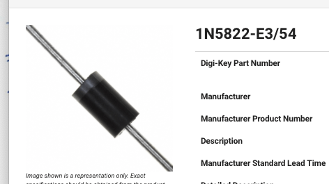

Maybe the transformers and/or the main filter caps 10,000 µF are not high quality? Or are the Schottky diodes becoming too hot giving higher than normal Uf? They are relatively light rated for the purpose.

The AC waveform is probably flattened at the tops, either because of the mains, or because of the supply itself. The measured AC is either average or rms, but in both instances the peak voltage will be lower than expected

The load current appears to be correct, since the voltages on the 3 ohm resistor are consistent.
The coil is 1 Ohm. You loose 1.4V over the coil. You loose 4.09V over the resistor. That is 5.5V. 5.5 + 21 = 26.5V so that is as calculated. High impedance PSU too with strong tube amp PSU resemblance and that worked OK with relatively low current. This is a class A amplifier though with 1.4A current.
Maybe the transformers and/or the main filter caps 10,000 µF are not high quality? All far from elegant designing to be honest. An LDO regulator design will give better results. In all cases with unregulated or regulated LPS you will lose energy to useless heat much more than with an SMPS. Cleaner power though but at a price. That come with class A, therefor the SMPS was chosen.

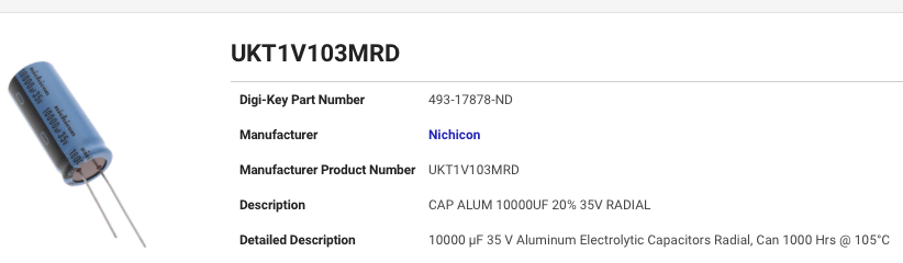

I do think the caps are good quality:

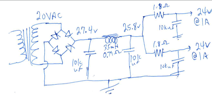

I didn't want to drop so much voltage. I just wanted to try CLCRC filtering on Nelson Pass' ACA class A amp. A Meanwell wall wart is recommended for that project.
But I made some mistakes along the way.
First being, I thought each channel draws 1A, but it draws more like 1.5A. So I designed my inelegant PS expecting 2, not 3 amps.
Then the transformer I bought is spec'd at 20VAC CT, but it is measuring 22VAC with the load. So I have more voltage than I expected.
Also I bought a choke rated at 2A, but the circuit draws 3A. (I can go on!)
I think my biggest error was getting a choke rated at 35mH, 2A and 0.79ohms (but measures 1 ohm), when I should have gotten lower mH and lower DCR.
This is what I wanted to get 24v per channel, but based on 1A per channel:
oh well.
Dan

1. With 3A for 2 channels the diodes definitely are chosen too light!!! They also have to charge the filter cap. I think you will need one of those chunky chassis mounted 35A rated bridges. Also for correct cooling.
