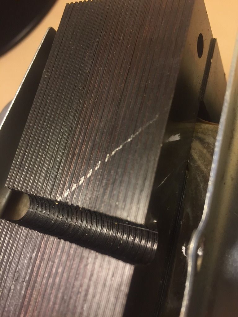

I recently got an output transformer for a 100w Marshall superlead I am going to build soon. While handling the transformer ( I was removing the covers to replace the bolts) I realised there is a scratch across some of the laminations on the side of the transformer. I don't remember if it came like that or if it's my fault. I assume it is my fault though.
As you can see from the picture the scratch is interrupted where the laminations are lower. I tested for continuity and indeed where the scratch is continuous i get some of the laminations shorting.
Is this a significant damage? Is this going to affect the performance of the transformer in a negative way? What about the sound?
Is it a good idea to dab some insulating varnish on the scratch? Although I know that if there are burrs bent across the laminations the varnish will not fix it. What do you think?

Drive 6.3V 50/60Hz AC through a 10 Ohm resistor to the 8 Ohm winding. Measure the ACV on the 8 Ohm side. Do NOT get fingers on the plate-side leads! (They will be hundreds of Volts.)
A healthy transformer (that size) will show well over 4.0V, probably >5.0V. The unloaded impedance is higher than the nominal impedance.
A badly-scratched transformer might show under 2V. The inter-lam shorts form little loops conducting through steel. Even though it is high-R steel, they tend to short-out all windings.

_I_ suspect that scratch is "not bad". But I could be wrong.

Drop some thin CA glue on the scratch. The stuff wicks in pretty good and might give some areas a little more insulation. In my opinion (for what it is worth) it is not all that bad, just don't do it again.

Let me get this right. I have a 6.3v filament transformer here. Without load it puts out 6.7vac.
I've put some power resistors in parallel to get about 10.9 ohms.
I hooked one side of the multimeter and one side of the 6.7vac on the OT secondary common.
Then I hooked the other side of the 6.7vac to one side of the 10.9ohm resistor.
Then I hooked the other side of the resistor to the 8ohm tap of the OT and the other side of the multimeter.
I measure about 6.5vac. I get very little voltage drop. Is this correct?

I think the transformer is excellent.

that scratch on your traffo is a mere annoyance, a typical newbie reaction, nothing to worry about really... 😀
