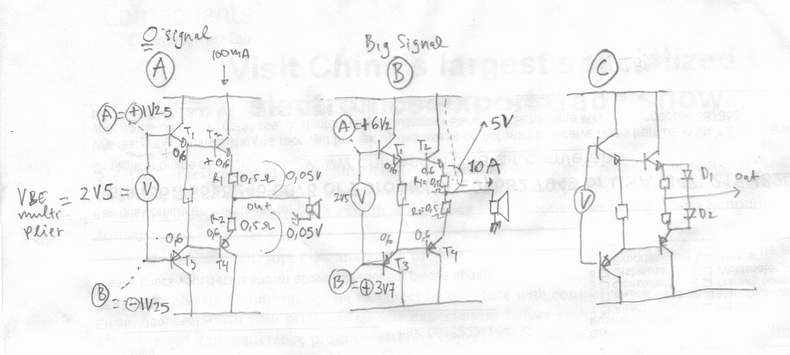

Hi, James,
I'm thinking about less variation in VBE multiplier if we use schottky in the place of RE.
John Curl writes that in uS time, current flowing in RE can reach more than 20A. If RE is 0.22ohm, it has 4.4V accross it alone (VBE doesn't have that value, the other transistor and its all driver must be off/heavily reversed at the time 20A passed).
If passed 20A , diodes wont give drop as big as 4V4, isn't it?
Inspired by NP who uses ordinary diode in parrarel with RE, so I think why don't just use schottky in this place, without any R? Schottky has very smooth characteristic compared to ordinary diode.
Also thanks about the info about IN4148. If it is ordinary diode (not fast recovery or soft recovery) why is the datashee, the TRR only 25nS, like fast recovery diode? Or is IN4148 is a fast recovery small diode?
Oh one more question. What kind of diode is LED? Is it fast/soft/schottky or ordinary diode?

Possible reasons for not seeing small-signal Schottky diodes used much: They have lower availability and higher price than junction diodes. The main advantages (low forward voltage drop, lack of reverse recovery glitches) are of low importance. The downsides (high reverse leakage current, high capacitance) can be more important.

Hi lumanauw !
I see a very big problem using diodes instead of Re, in normal EF-type
one outputbjt is typically reversebiased while the other is heavily
conducting. This mechanism is used to reduce crossoverdistortion,
so by using diodes you would kill this mechanism...
If you have a never switchoff topology, this is different of course !

Hi, James,

Hi, Mike,
Figure A shows what we usually do. For simplicity, I assume the VBE of transistors is one value, 0V6. In steady condition, where the bias current is 100mA passing thru 0R5 degeneration, so the VBE multiplier value will be (0V6+0V6+0R5x100mA+0R5x100mA+0V6+0V6) = 2V5. This 2V5 will be the same value in every condition, right? So point A will be sitting at +1V25 and point B will be sitting at -1V25 if we assume the output is attached to speaker who is negative is 0V. All transistors are on in this condition.
Figure B shows when there is quite some current passing thru the speaker (in frequencies when speaker's impedance drops very low, in uS time). The current that is needed for the speaker is 10A. So the drop in RE1=10Ax0R5=5V. That makes point A is sitting at +6V2. The VBEmultiplier only gives -2V5 steady difference towards pointB, so pointB will be sitting at +3V7 instead.
Lets see the output voltage node (assume 0V) towards +3V7 in pointB. TR3 and TR4 are PNP's. Their bases is more positive than their emitors, so in this condition TR3 and TR4 is heavily reversed OFF.
This is what happens in classB amp. While one side of transistor is turning ON, the opposite side will be turning OFF/reversed. This makes ON-OFF-ON-OFF-ON-OFF-ON-OFF-ON-OFF in both sides transistors.
The ON-OFF will generate high-order distortion, because abrupt state change from ON-OFF.
You can try simple experiment like figureC. Put ordinary diode (IN4002) in place of D1-D2, then play the same music.
You will hear the trebles will have "LESS" resolution (compared when you dont have D1-D2 in that position). I think this "LESS" treble resolution is the right sound, because in normal (more) resolution, what we actually hear is not a high resolution, but it is a high order distortion being feedback to differential, regenerate by output stage(+another high order distortion), re-feedback to differential, (+another high order distortion by output stage), re-feedback to differential, and so on-so on.
When you put the diodes, the ON-OFF is reduced, feedback signal that is received by front end differential has less of this high order distortion and so on, the result is "LESS" resolution highs, but actually it is less high order distortion.
This happens in the 3 stage topology class(A)B amp that we know all this time. This is caused by 3 factors :
1=Feedback (if you built non-feedback amp you won't hear it),
2=classB output stage (if you built full classA output stage, you also wont hear it)
3=VBE multiplier (if you can get with biasing technique that is sliding perfectly) you wont hear this also.
We all cannot get too far with no.1 and 2.
NP known about this, he came up with patent #3,995,228 to deal with no.3. He also came up with fig.C. (but now he seems cannot get away with classA 😀 )
Mark-Levinson also knows about no.3, they came up with "Dynamic bias" with their biggest amp, ML-33. Krell makes "sustained plateau".
They all tries to makes all transistors not starting cycle from deep OFF/reversed but rather from always-on condition, so the high order distoriton is less.
I think putting schottky for RE like this thread also will reduce it, and we can still uses classB output stage + feedback like we usually do.

Hi, James,
I found it. It is on LSN (Large Signal) distortion section. He found that putting forward diode // with RE reduce distortion for impedances <4ohm (2.6ohm in the experiment).
But he don't mentioned schottky, just junction diode for the purpose.
If we use no RE at all, just attach forward schottky in that place, will it work?
