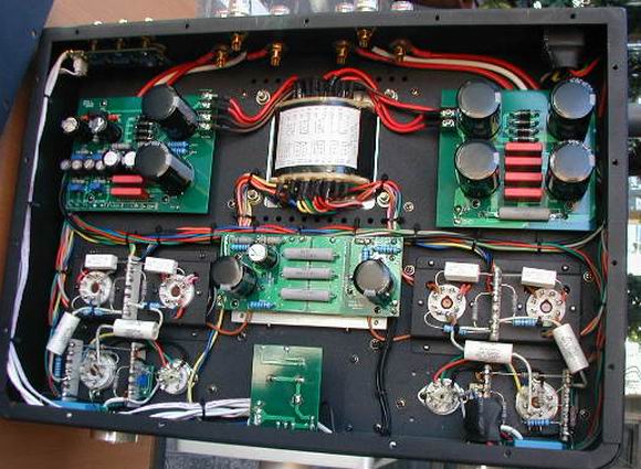

I am looking for the schematics for this amp, i tried to google but just ended up in some shady websites that wants my credit card number.
Anoyone has the schematics for this i would be very happy!
I just bought one very cheap, and want to check BIAS on it, and also i am interested in adding preout (after volume controller, but before amplifier, so that it can be used another beefier amp for the low end)
Any input here is very appreciated!

stability of bias of KT88 in Xindak V30
An Eastern European website says -quote- "it uses an accredited classical design " that would make it easier if you checked out the many KT88 designs available at least in the UK .
A preout after the volume pot will have high output impedance and is rarely a good idea.
The circuit is very likely extremely close to the Eico HF-89.

The KT88 / KT66 /6550 Directory
Scroll down by the KT88 data to various circuit diagrams using the KT88.
Of course it could be a copy of the world famous 1947 Williamson KT66 circuit as published in WW-

If you look at photos of the build of the V30, you can see half of each 12AX7 isn't used, and the coupling caps going to the output valves come off the plates of each half of the 6SN7. That kicks it out of the Williamson camp.
The coupling capacitors go from the anodes of the Williamson to the grids of the output valves 6J5 to KT66 the 6J5 is just a single older version of a 6SN7 which is two 6J5,s in one glass .
Look up your tube equivalent book all specs are the same .
Yes it looks like one side of an ECC83 is not in the signal path.

Hello Guys, thanks for the info.
From the comments above it is difficult for me to derive if there is a possibility to hook up a pre out that is volume controlled from this V30 amp. I would be very happy to do so, as this might open up possibilitys to use another amp for the heavy work and use this amp for mids and highs, in a bi-amp configuration.
You guys have any suggestions as to where these pre-amp should be hooked up, or if there needs to be any other components added in order to reach this goal?
I found this amp at a very good price, and i am more then excited to find out what i can do with it.
