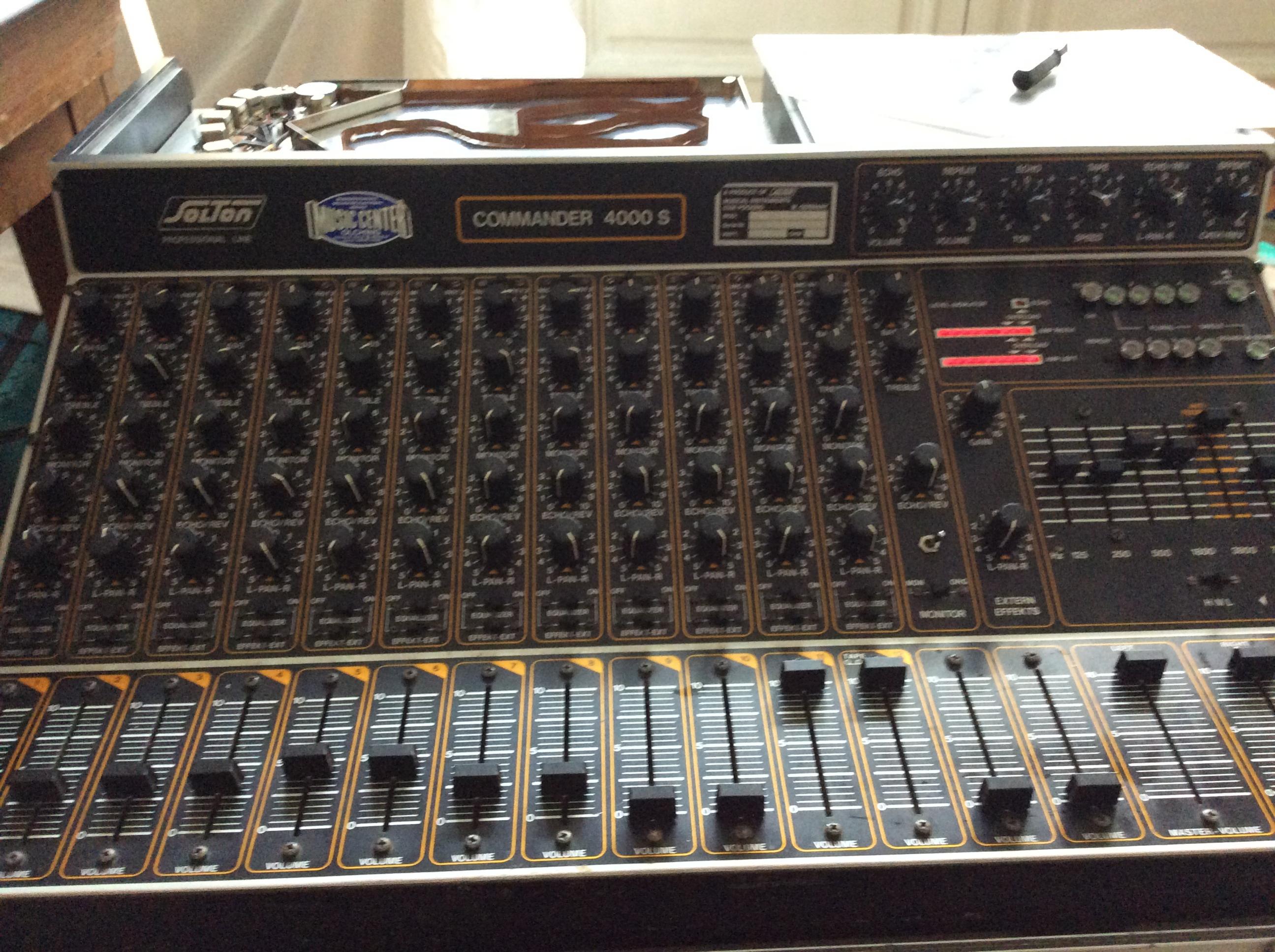

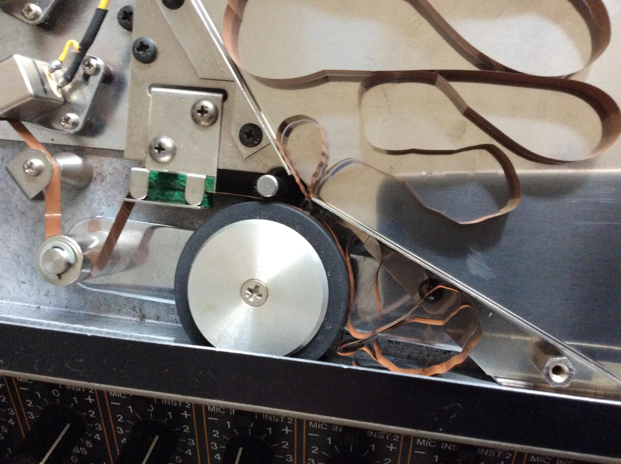

Commander 4000
Hey guys,
i found your thread. I hope you're still reading this. I recently bought a Comander 4000 S. I guess it's the same as yours just with 12 channels.

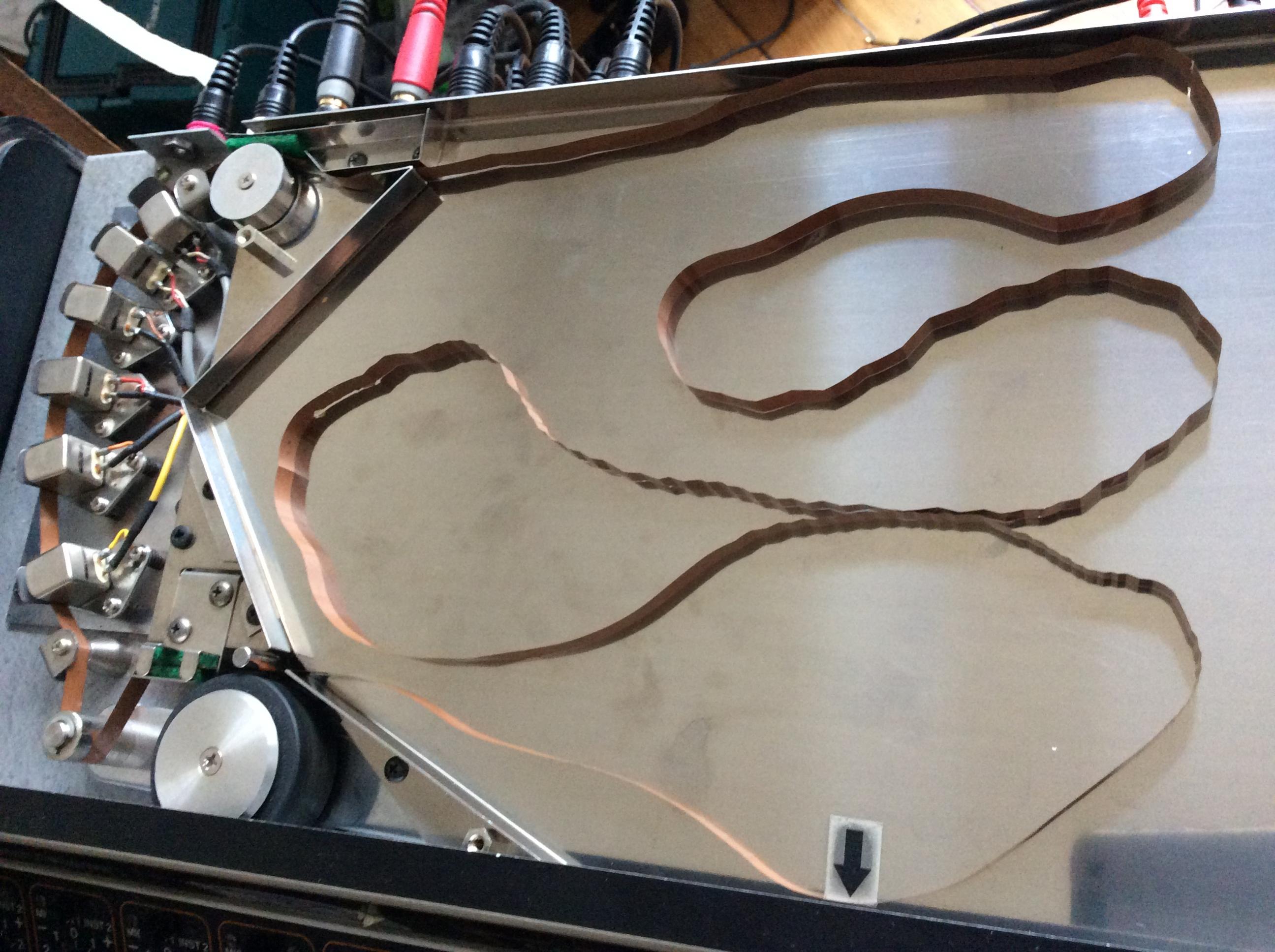

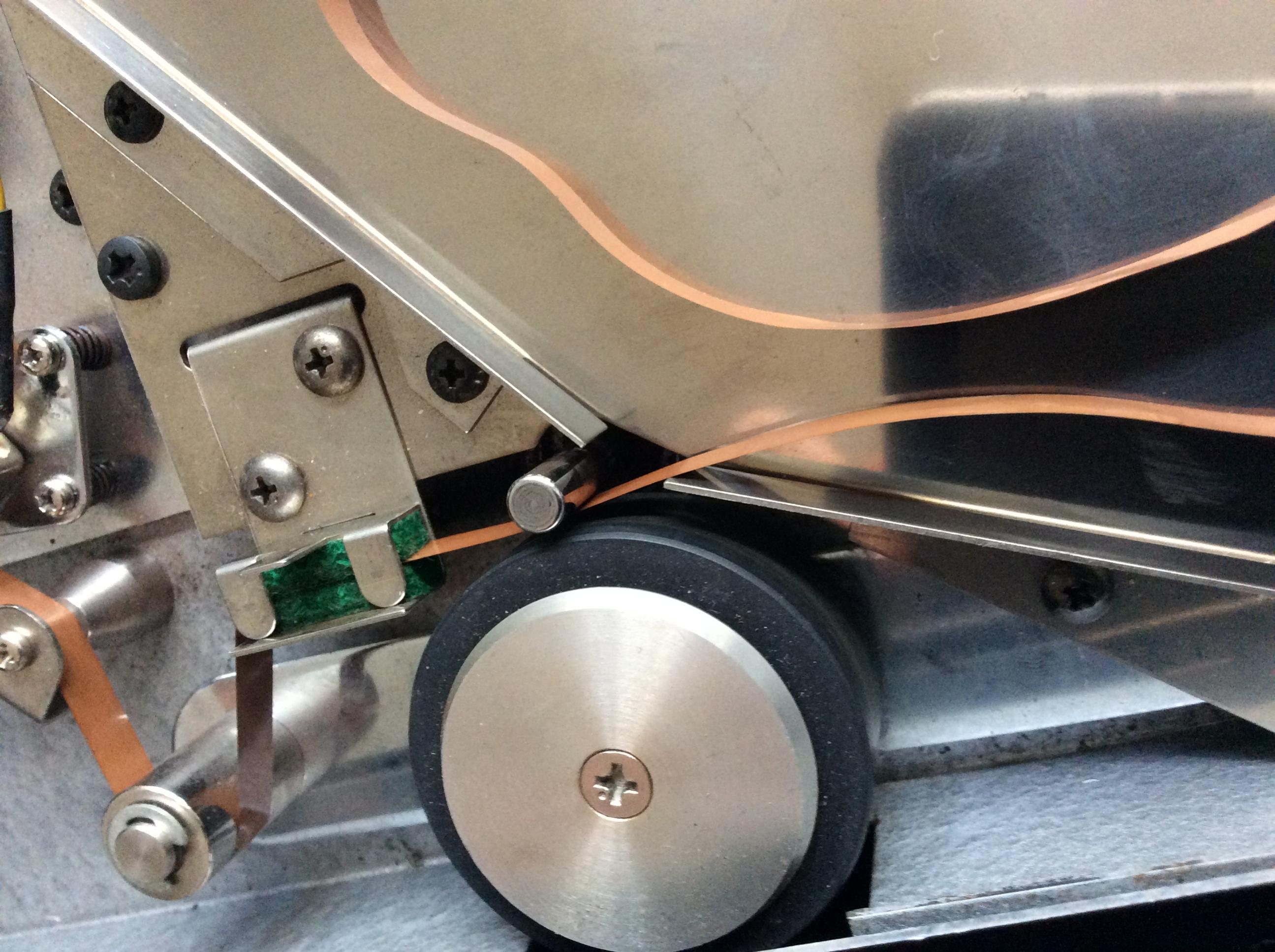

I also had to fix the power switch. I like the sound of the mixer (especially the graphic eq). However mine came with a very messed up tape. The tape echo basically works and is amazing even with the 4 switchable tapeheads. But both the tape echo and the spring reverb seem to need amplification (thinking of finding a way to add a little amp for the effect section)... But the main problem seems to be that the tape always gets eaten after few minutes of usage (especially when adjusting tape speed). I was wondering if it has to do with the length of the loop. Think i ll try shortening it...
Well the tape is 7cm wide and 1/4" reel to reel tape is 6,35 cm wide. So i was thinking to try that...
any suggestions, ideas, experiences, schematics?

Success
Hey the machine works great with 1/4" reel to reel tape and sounds amazing... perfect for dub, wave and trashy experiments.. I tried it now with a 1,60m long loop and luv it. might make a shorter one later...
