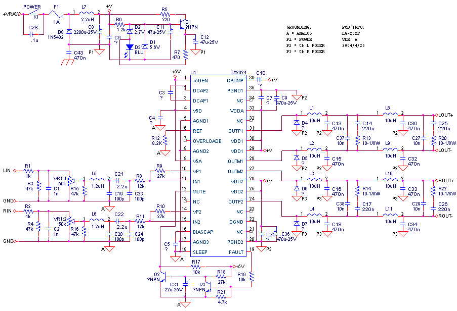

I've been looking for schematics for the Sonic Impact Super T-amp. The closest thing I've found on the forum was this:
Link
But as I understand it, this is for the Class T Amp, not the Super T. If so, does anyone know where to find those schematics?
There is also the possibility that there aren't too many differences between the two... in that case I would appriciate if someone could point me to some kind of comparison between the to regarding any differences in the design.

As far as I can recall, the output filter design is somewhat different. A fourth-order filter instead of a second-order design?
There may be some useful information for you at at Panomaniac's site:
http://www.michael.mardis.com/sonic/start.html
There's no schematic, but lots of juicy info.
