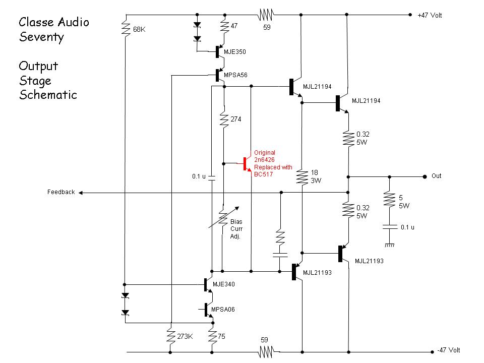

Classe Audio Seventy Output Schematic
I have explored the Classe Audio Seventy and I have found the darlington transistor 2n6426 was malfunctioning. I couldn't find the 2n6426 in the local electronic shops so i have replaced it with the similar transistor BC517. It is now working well . I have adjusted the bias resistor for an idle current of 150 mA . I am not sure about this setup but i think it's not bad.
Has anyone have an idea about the idle current of Classe Seventy ?
Below is the output stage schematic of Classe Audio Seventy that i did explored with a multimeter.
Reha
Reha
I have no idea if this helps or not, but my DR-15 schematic list's the BIAS at 74ma per device!
Zc
Zc
Actually i did the 150 mA bias setup by measuring the current on the +47 Volt power rail . I have tested the amp 4 hours continuous . The output heatsink was near 40 degree . The MJE340 and MJE350 was about 70 degree . May be the 150 mA a little bit high
