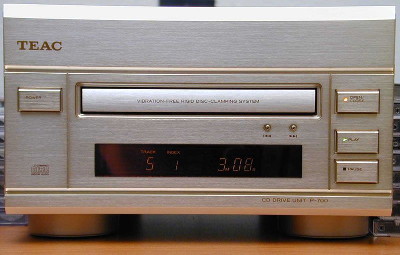

Hi DIYAudio members,
Who can help me with the schematics of a TEAC VRDS P700?
I want to upgrade the power supply and other things like a new Clock (Kwak Clock-7) and need the schematics.
If some one can help me, I'll be very happy and greatfull.
Thanks in advance,
Audiofanatic 😉

Hi Vidard,
Unfortunately, I don't have it.
I didn't order it cause it was to expensive.
I'm still working on the Digitalout.
The transport sounds wonderfull with a new PSU and a KC-8 onboard.
The new case is being made and it'll be like a semi WADIA case.
The bigest problem with this transport is, the PSU make sure you make a brand new PSU and than you'll beat allmost all transport I know, exept the CDM1, this one sounds different but not better or worse. It's like listening to a tube pre or a BJT pre they both sound great but different.

Hi Analog_sa,
The best thing I did was instal a KC-8 in the transport.
I had a Tent XO-2 in it for a few weeks (used one from a friend), the sound was OK, better than the original one.
But the sound was like fatiguing, then I switched over to the KC-8 and sinds that day I didn't hear a transport that sounded this good.
Not even a Wadia.
I also changed the SP/DIF out for a new one, thisone was also made by Elso.
The PSU is also new, a new toroid transformer and most caps are ELNA's and OsCons.
The Laser is new and the case is damped with damping material.
That's about it.
I don't have the schematic so if you have one, please send me a copy.
Best regards,
Audiofanatic 😉
