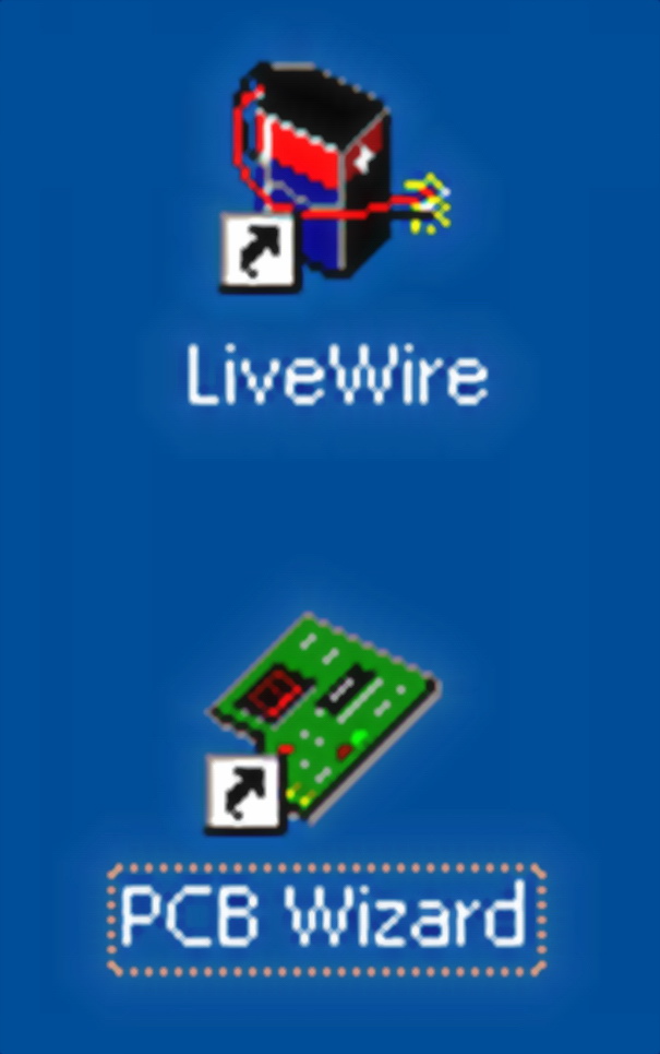

Live wire and PCB Wizzard will fit your needs
Into the live wire you will create your schematic... alike a simulator you build your schematic into your computer screen... then you save the schematic.
Now you open the PCB Wizzard and drag and drop your schematic to the main page... to the program desktop.... then click into "PRODUCE SCHEMATIC"
And ready!
You will see the program trying several positions for copper wires till it found the better one and offer you the schematic.
Those two programs are 11.8 Megabytes size.... they do not travell into Internet that use to have 10 Megabytes limit...you will have to download from FTP or from a site.
regards,
Carlos

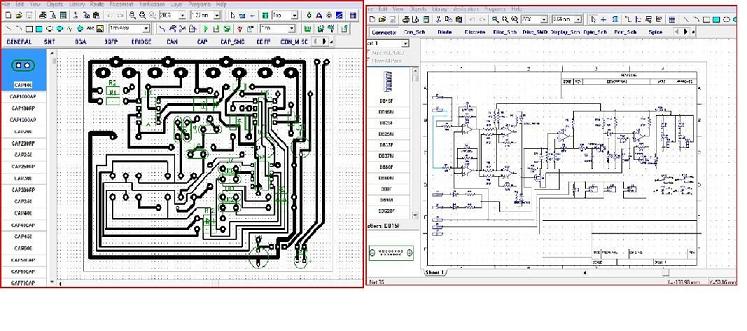

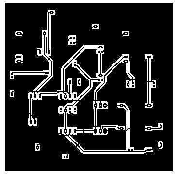

You can decide the dimensions... OR...to let the program decide the smallest board
....possible.
You can instruct the program about shape and dimensions and all stuff....or let the program do by itself and offer you the board ready to use.
Here is "Art Work"
regards,
Carlos

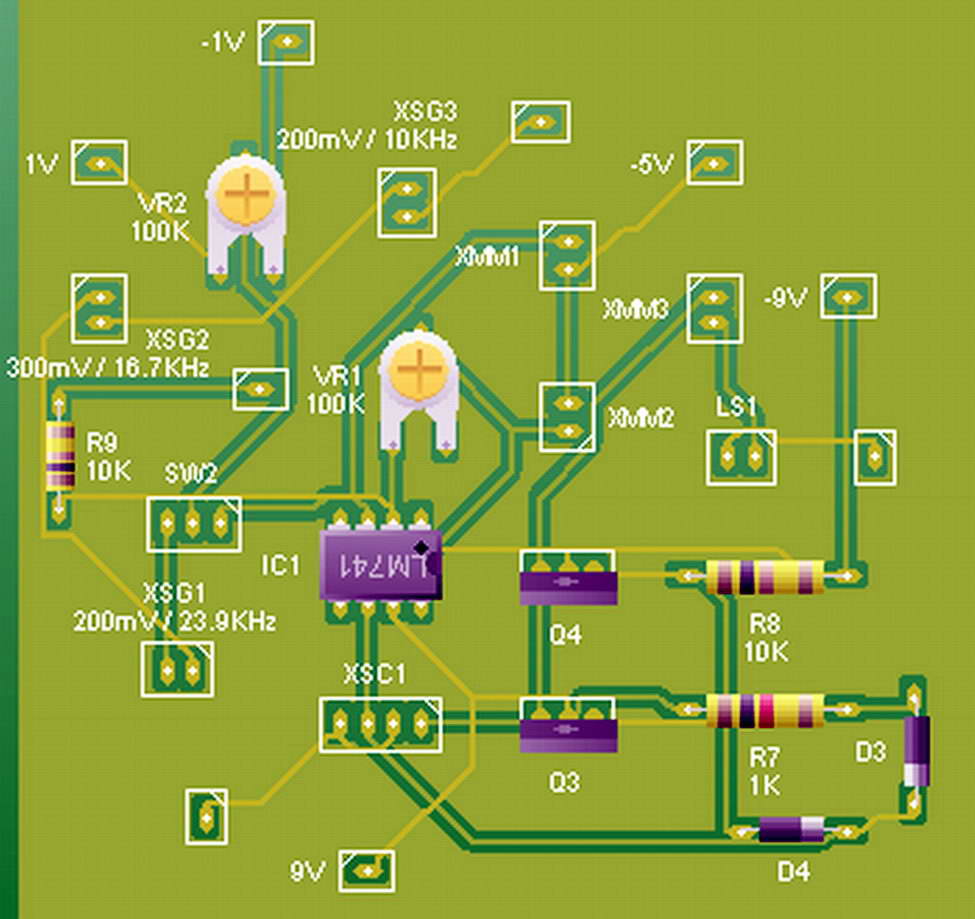

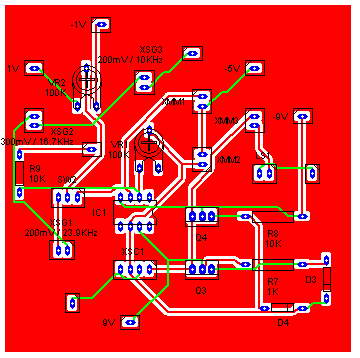

Also you can have Ray X vision, that will be interesting during the construction
of circuits... you can see the top components and also the copper lines that are into the under side of your board.
Both same time...because of that i am calling this Ray X vision.
regards,
Carlos
