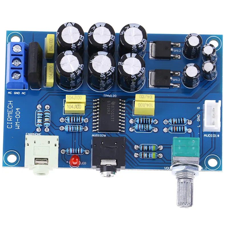

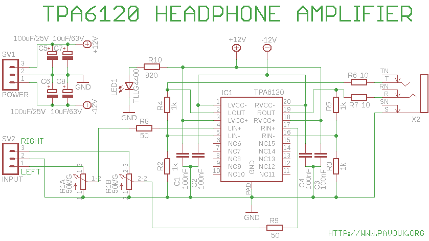

J Julian RO Member Joined 2015 2024-10-19 12:04 pm #1 2024-10-19 12:04 pm #1 Hi, Does anyone have the schematic for this module sold on Ebay? Thank you in advance. Last edited: 2024-10-19 12:15 pm Andersonix Member Joined 2004 Paid Member 2024-11-02 10:36 pm #2 2024-11-02 10:36 pm #2 I suppose you've already seen this schematic of a different board (Pavouk)? Can it be much different? Attachments tpa6120_headamp_sch pavouk.png 14.9 KB · Views: 92 Reactions: Julian RO J Julian RO Member Joined 2015 2024-11-04 5:49 am #3 2024-11-04 5:49 am #3 Thank you. It is possible that they are the same. You must log in or register to reply here. Share: Facebook X (Twitter) LinkedIn Reddit Pinterest Tumblr WhatsApp Email Link
