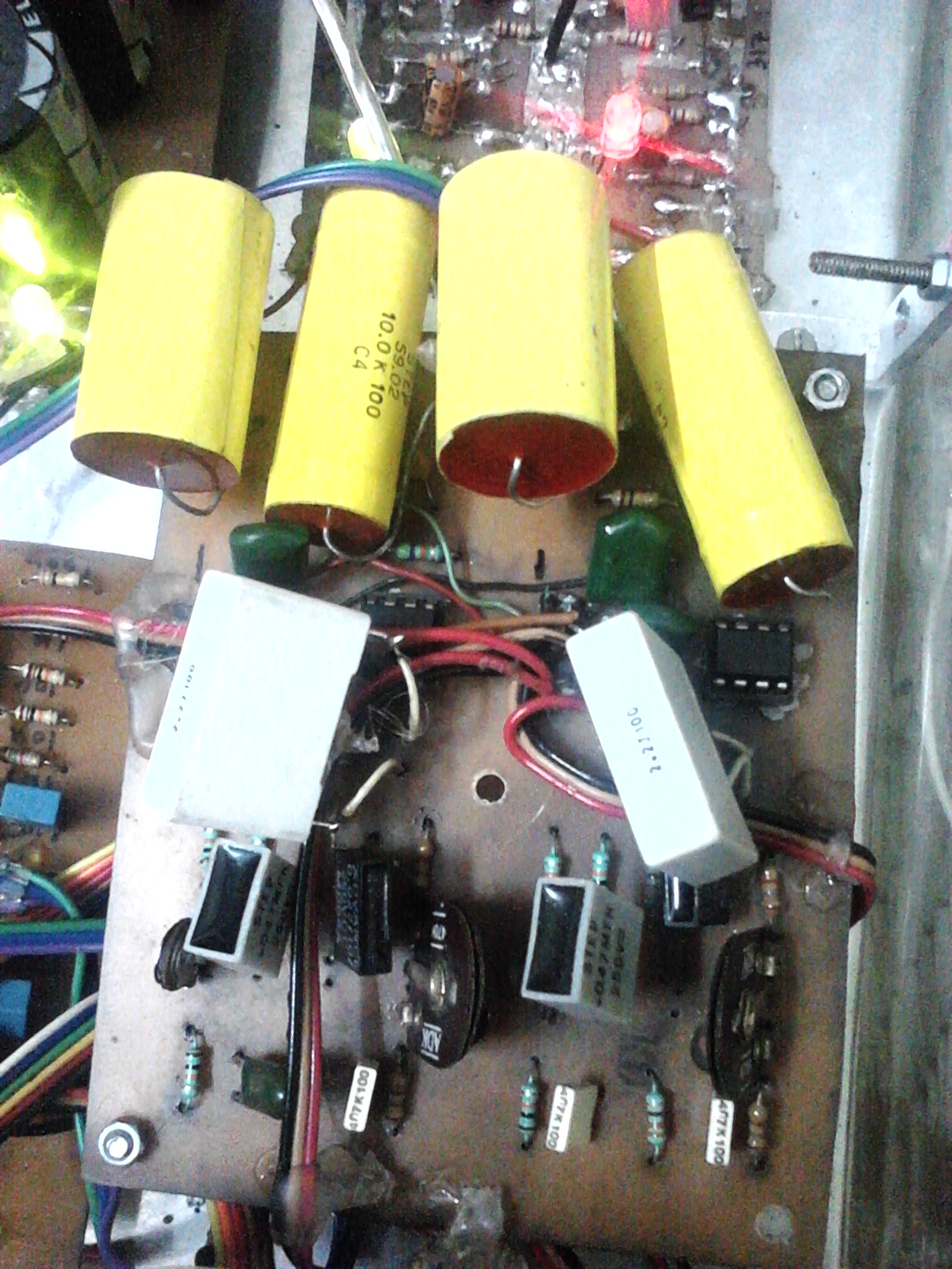

Here is a circuit that is thoroughly tested by me to my entire satisfaction.
3 band EQ
I used NE5532 with this. It is used in my present system. I tested its performance with many Indian Oldies and various genres. I am very happy I can say. Once you adjust it to tune your system, you won't have to touch it again.

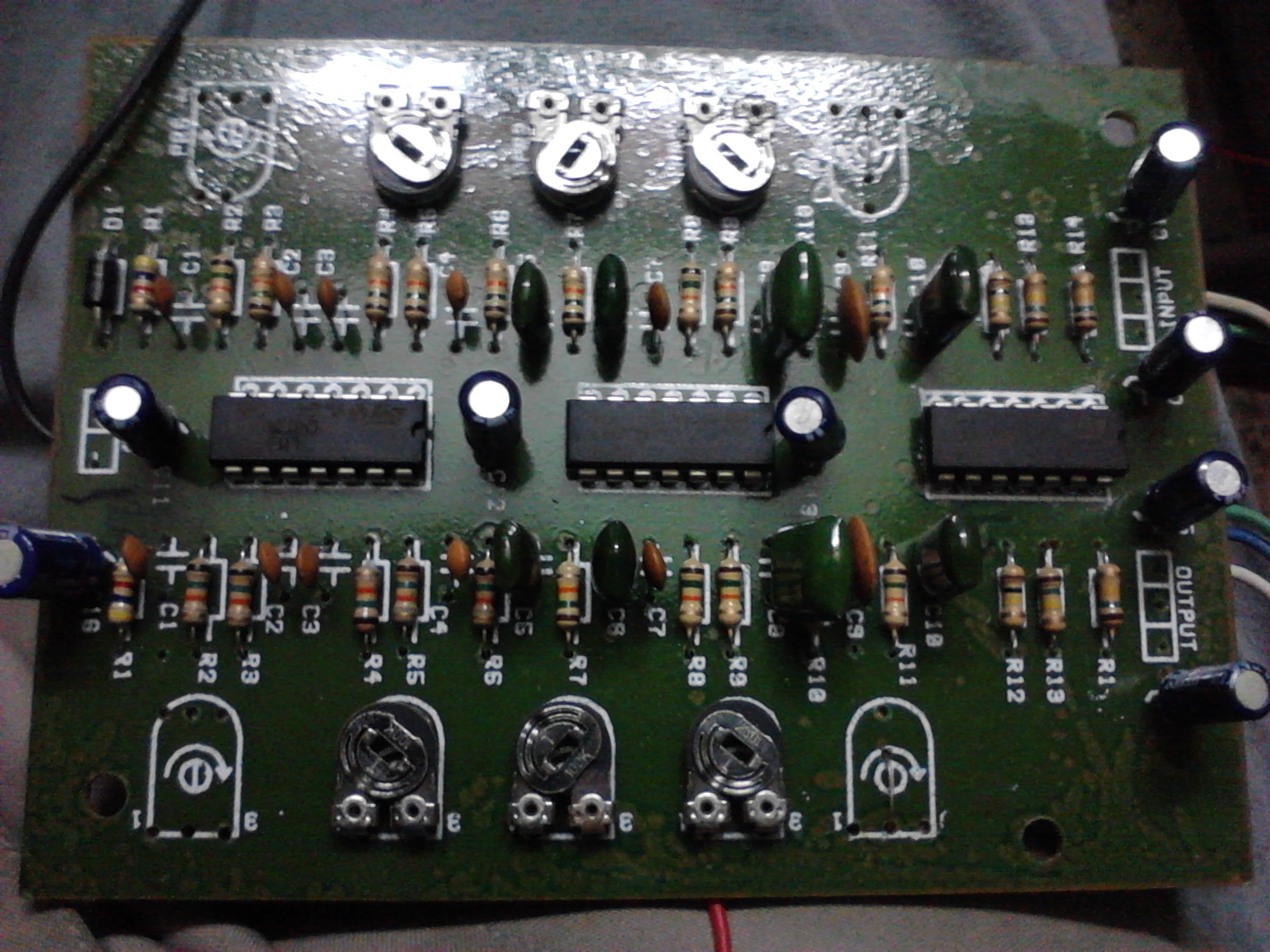

I purchased a commercial board based on LM324 but the circuit I assembled from that site is way better than that both in terms of performance and simplicity.( please vide the attachment.)
And here is my current Eq.
http://www.diyaudio.com/forums/atta...c-equalizer-sos-4-caps-added-eq-prototype.jpg

Sudhir, as you can see in the diagram that I posted at #3 .... it uses a 470K Lin Pot for treble ( I am using a variable resistor for the time being),
a dual version of which is hardly available .
Could you please tell me how to modify the circuit using a dual 100K pot?
