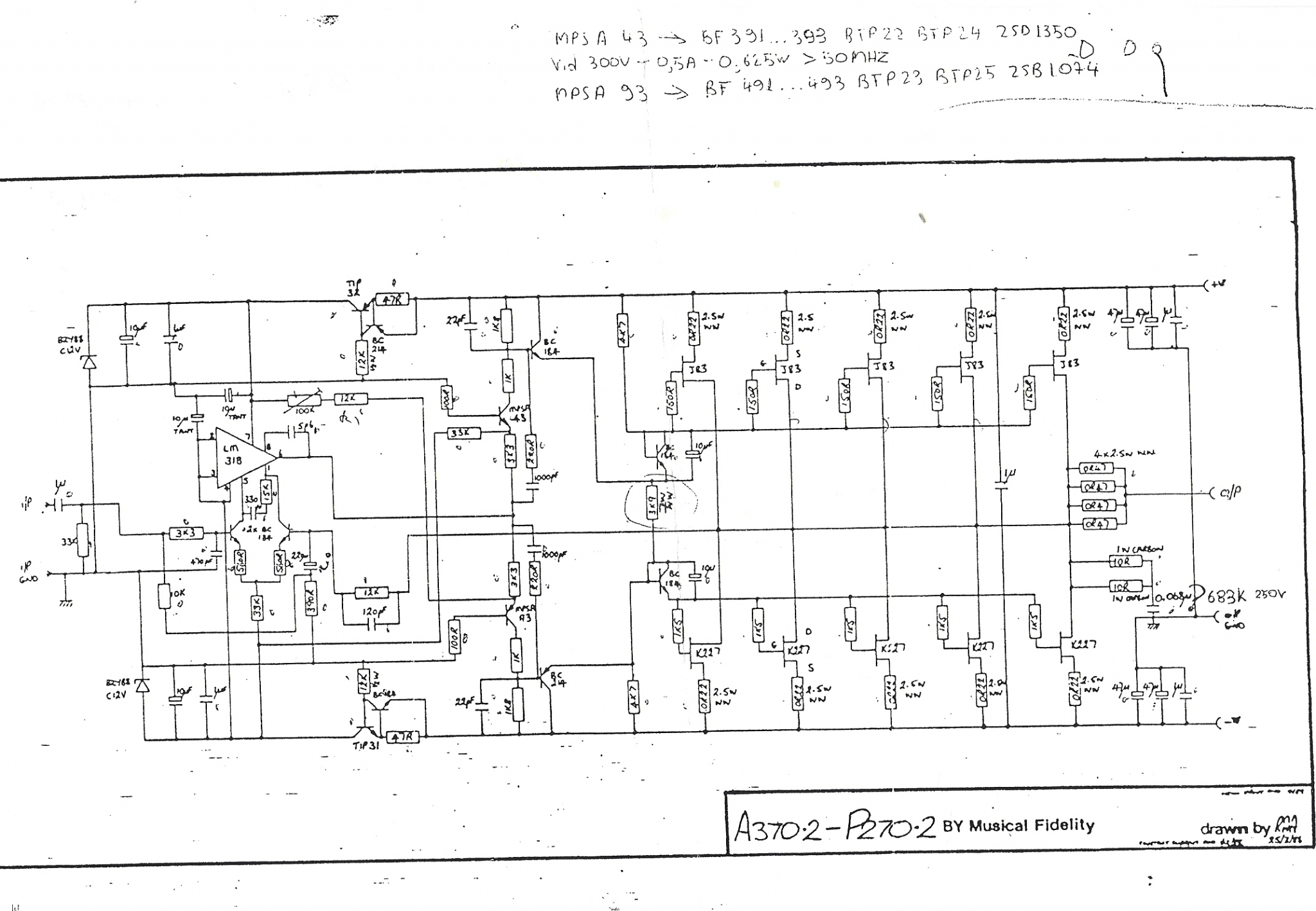

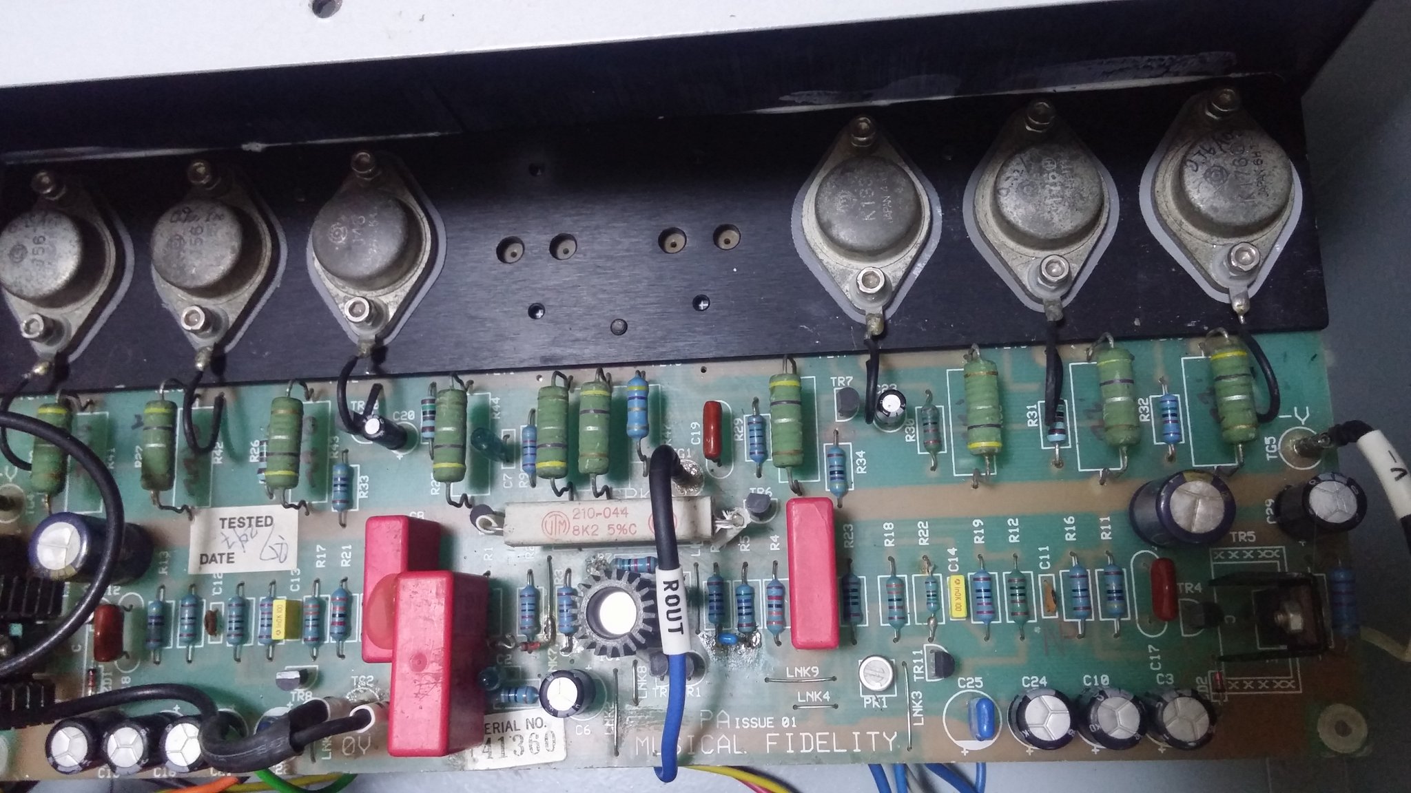

This circuit diagram and F15 the same, I have a F15 reference this repair. The output mosfet is different, F15 is buz900.906 or 2SK135.J50

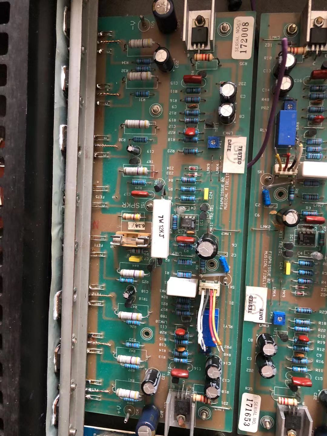

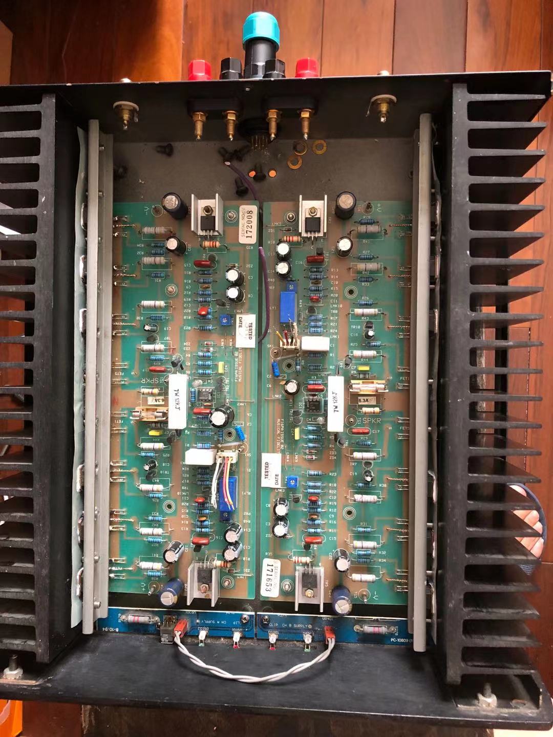

Here is a picture of my previous F15. Now there are two lost mosfet F16 amplifier board ready to transform the power supply independent split power amplifier, the circuit is similar to the above, power tubes with 2SK1058.J162, amplifier board has been tried with +-32V power supply, each power tube current 150ma, the midpoint voltage 5mv, after a few hours are very stable.
