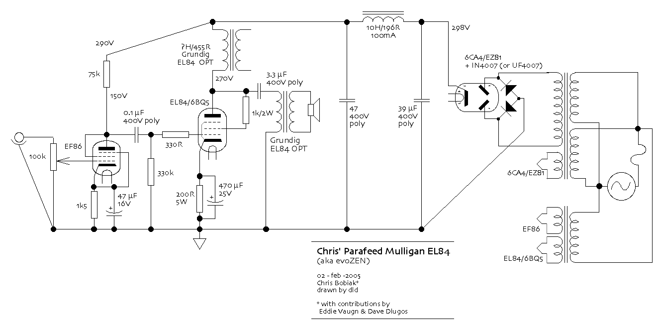

VectorWorks comes with a set of electronic drawing symbols, but i've ended up making up most of mine (and they are evolving continually. Drawing programs are also good for doing speaker & chassis drawings...
