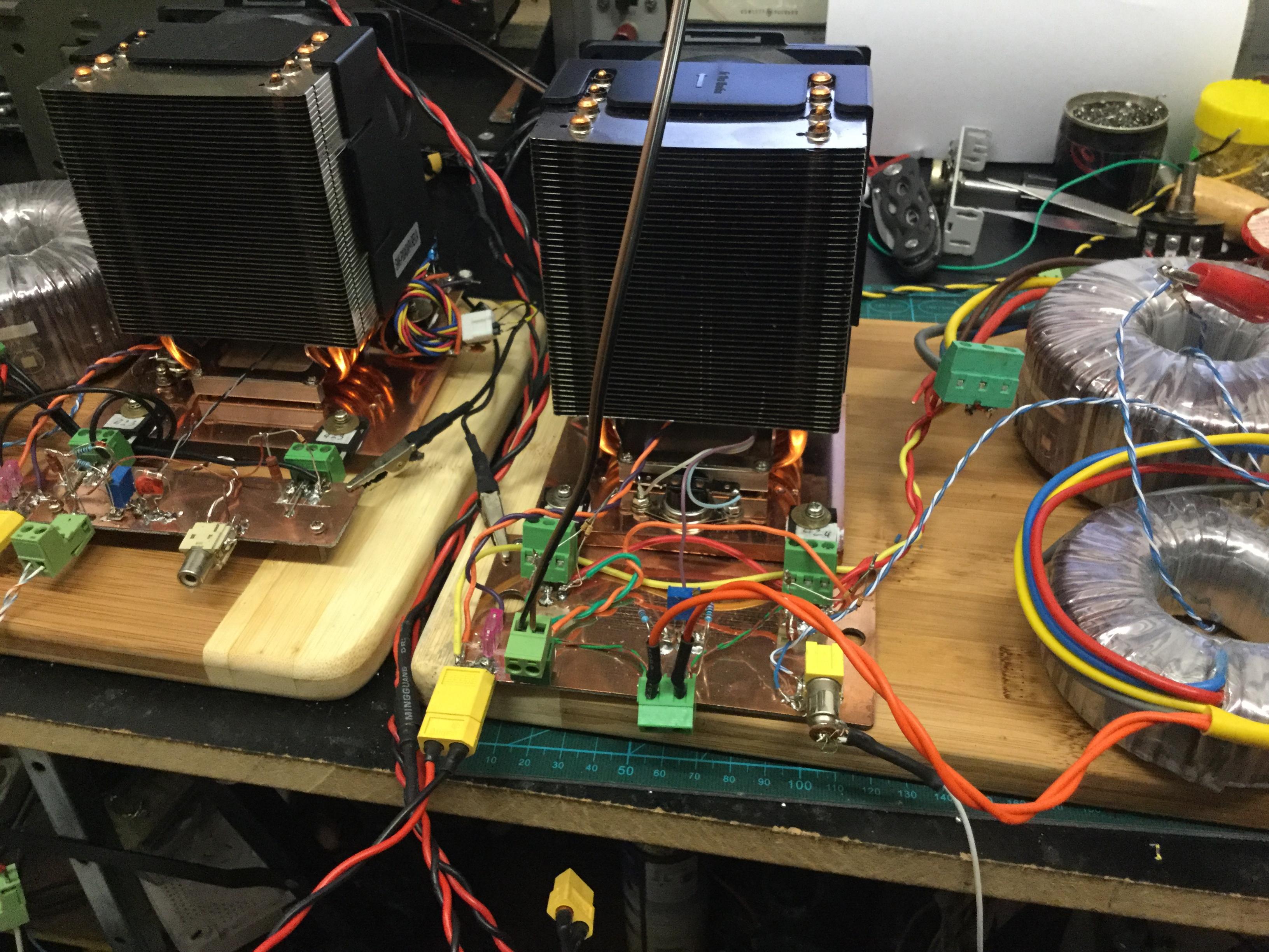

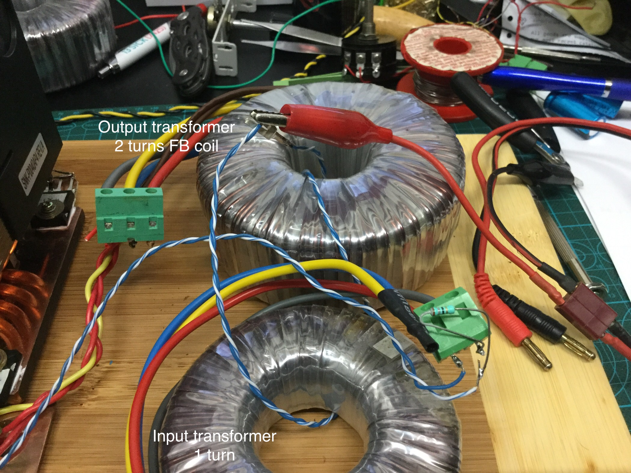

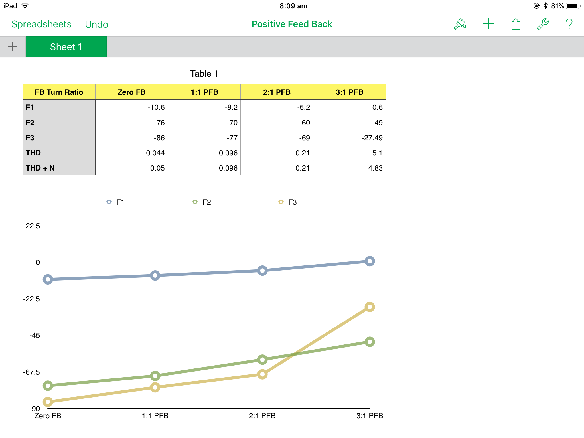

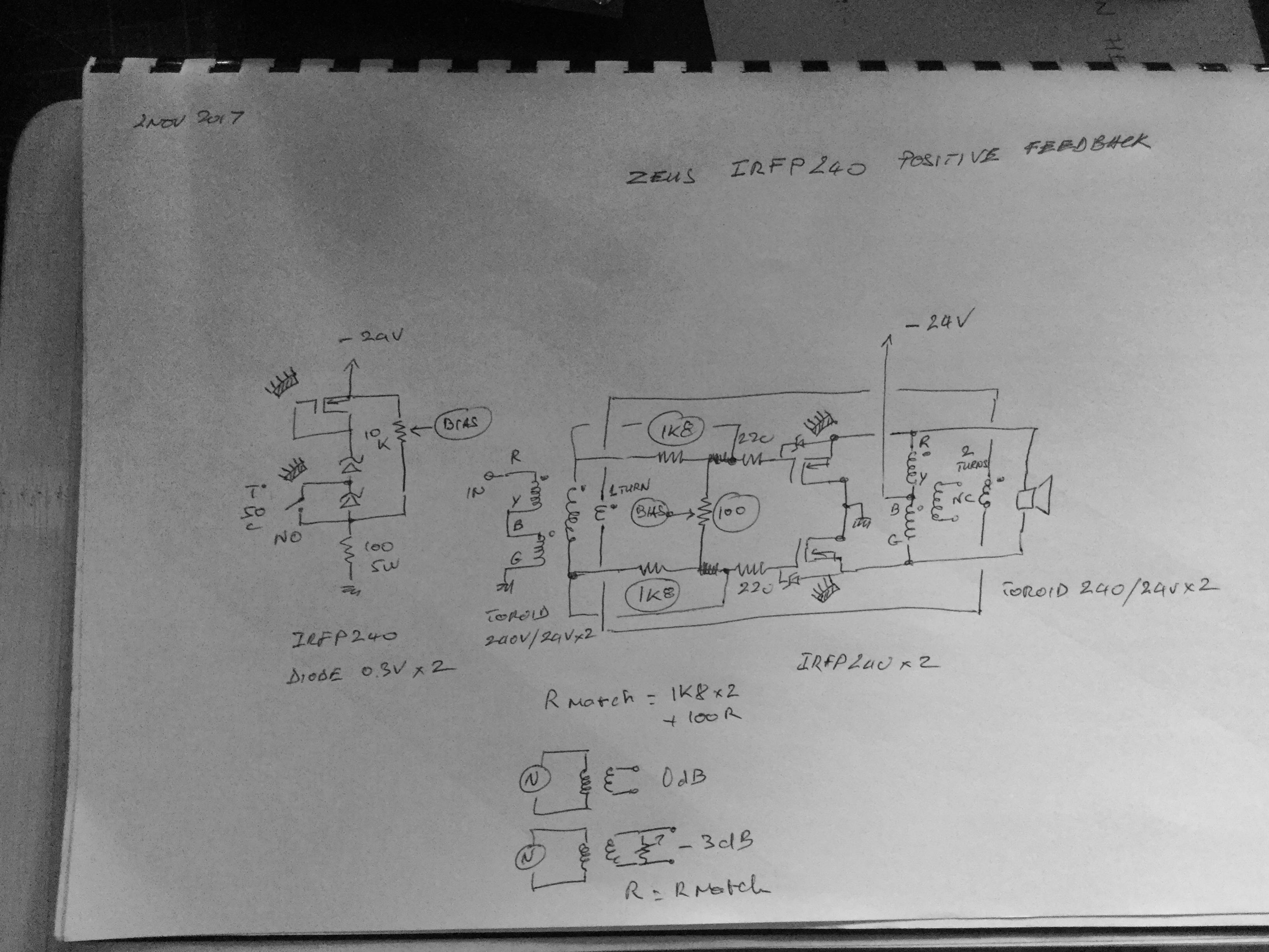

Zeus Positive Feedback
My attempt for a positive feedback amp, can switch in and out by disconnecting the loop, it gives a nice effect like a “presence” plus “ loudness” switches.

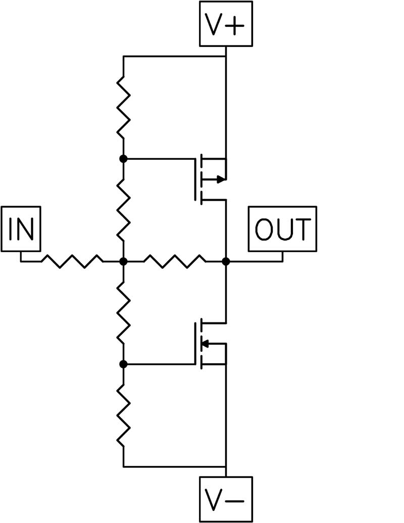

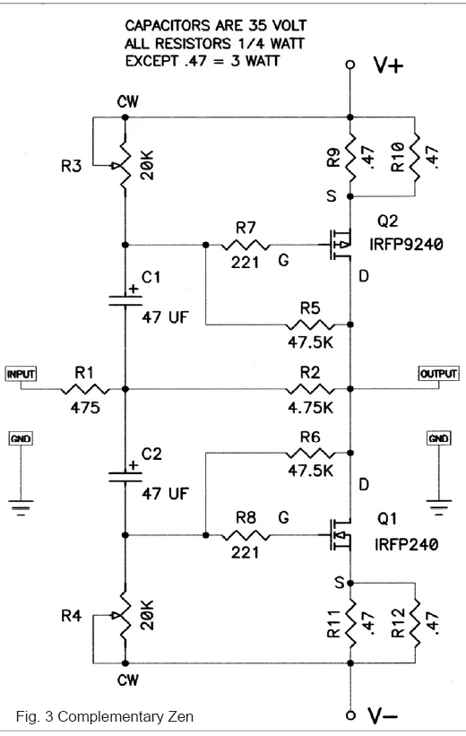

I had occasion to play with Mosfet push-pull Schades. The basic topology
looked like this:
Is that basically Zen version 5? (Or am I remembering wrong?)
most probably not

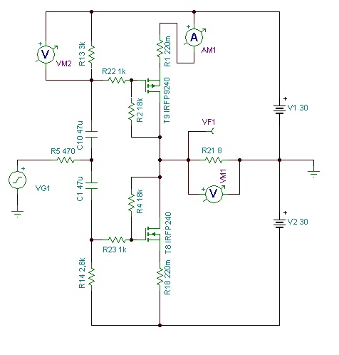

you chose 18K (instead of 10K shown in previously attached pic) , based on which criteria ?
overal THD or THD spectra ?
Hey Zen Mod, thanks for the comment.
It was another initial test and I was looking at the gain, but now using 10k and 1k with 15v + 15v and additional stage of gain, I got good THD results.
Output Current 1.7A
7.1 volts AC output at 0.13% at 8 ohms.
What do you think?
thank you
Output Current 1.7A
What do you think?
thank you
Will those 10k or 18k resistors allow enough current to drive the gate capacitence
at higher frequencies.
Am I forgetting something?
Zen v.5 sch. - R2 is the feedback element and you don't have it...
Schade is (a form of) fedback.Hey Juma, I thought to Schade that we do not need any more Feedback
Oh yeah, now I remember it...
