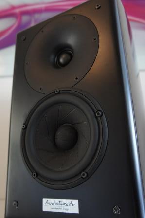

Hi everyone,
I've published a new loudspeaker design called "Revelation Two - M4 WG".
It uses the ScanSpeak Revelator 15W/4531-G00 mid-woofer and the Classic D2905/9500 tweeter paired with the Visaton WG148R waveguide.
It turned out to be a really nice combination. It has a LR2 cross-over topology and the cross-over point is 2.2kHz
For further details see: Revelation Two - M4 WG
Best regards
/Göran

The symmetric crossover option is interesting,never seen that before,did you try it and what was different to the conventional layout.
There is no measured electrical or acoustical difference between the two cross-overs, but some claim that a symmetrical cross-over sounds better because of the presumed easier load for the amplifier.
Yes I've tried it, but I stand neutral in this topic and I say it's amplifier dependent if you notice any difference.
I gave it as an option because I thought it could be a nice touch for anyone to test and experiment with. This cross-over was suitable because it wasn't so complex and didn't require too much additional cross-over components.
Here is a commercial loudspeaker company using Symmetrically Balanced Cross-overs. Gauder Akustik
Regards
/Göran

I'm not sure I fully understand your question?
Since, I used a flat baffle enclosure from Dayton Audio for the Revelation Two - M4 WG you need to tilt the enclosure backwards by ~2 degrees in order to get a perfect phase integration between the drivers.
You can also turn it upside down and have the mid-woofer at listening height or even better make a custom built enclosure with a 2 degree sloping baffle.
Regards
/Göran
