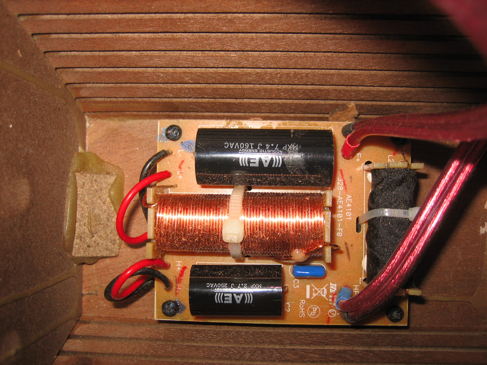

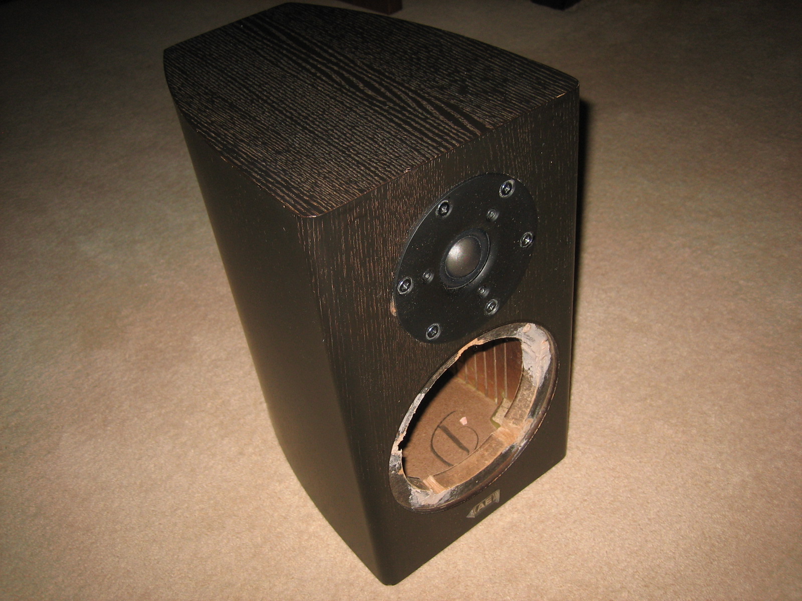

This is the existing crossover and the cabinet. Does this mean anything to anybody?
If you are set on winging it, then you could probably get close to a reasonable result by poaching another design using 15W4531 and a "similar" tweeter.
However, as Scottmoose says, there is more to it than matching simple characteristics such as efficiency. Several variables including impedance (not nominal) need consideration.

The crossover you have already will be pretty much useless for your new drivers.
Shure it will do something, but you should make a crossover that fits the drivers + enclosure. You pay for the drivers. Make sure they can do their work properly. Lots of people around here that can help you achieve that.
