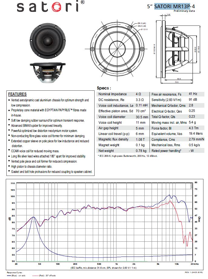

Are you planning a 1st order electrical crossover at 2kHz for which a 4" midrange with smooth high frequency extension is required?
For 2nd and 3rd order acoustic slope 2kHz crossovers, you can also consider a 5" midrange like the new/coming medium cost Satori MR13P. A 5" could simplify your 300Hz crossover plus increase the 300Hz max SPL.
The 10F-8424g has Xmax = 2.6mm, which models to have a 100db SPL limit at 300Hz. The MR13P and 12MU4731t have ~1mm extra Xmax for relaxed 300Hz transients.
I have listened to speakers with the 12MU4731t and RAAL 70-20XR and was very impressed with the sound, but I never listened to a 10F-8424g speaker.
Study the motors, venting, cone resonances, surround and suspension resonances, datasheets.....a "cost is no object" design with the 12MU4731t should sound better than a "cost is no object" design with the 10F-8424g. How will your room affect the sound?
