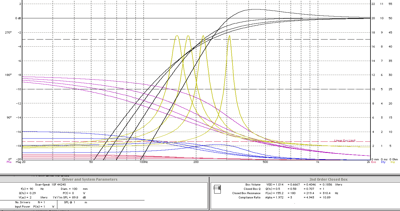

Hey guys, I've been researching a small but not tiny, two way enclosure with really low volume, and I've worked out I think, that this Scanspeak 10cm Wideband, 10F/4424G00 will be perfect in a sealed enclosure of 0.4 liters / 400cc for a QTC of 0.707 ... I'm trying to just double check my work because I don't trust myself... does anyone think that this will be a bad solution?

Yep, size is ok, but you will get basically nothing down low with that tiny xmax.

You calculation is right, but...
With F3 not getting close to 200 Hz, you'll have no bass and be missing much of the lower midrange. Given that this is an excellent mid-tweeter adding a tweeter imbalances things further an drastically complicates with the addition of an XO.

You really need to define the F3, or the Fs for your application. 40Hz with 6lt is imo much better than 100Hz with 0.5lt. Paul Carmody has some designs that may interest you.
