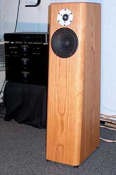

Speakerland has desiged a new Scan Speak 2-way system.
Very nice, very good. Ringradiator and 18 cm revelator
Look at
http://www.speakerland.nl/scan-l.htm
and then Ultimo 'download werktekening' for drawings and X-over.
Also look at hot for the new d'appolito design

Nice! But those won't be cheap to build 🙂 Those Tweeters run
around $900 USD a pair if I remember correctly? I am sure they
are good though...

More detailed drawings. Just wonder how would be the bass performance? Do they need sub-woofers?

I am sure it depends on what kind of music you will play. But my feeling is that a pair of good subs placed close to each speaker, and crossed very low (electronically) will only help.

what about the gross efficiency mimatch 95 vs 87(?) between the woofer and the tweeter in the Ultimo?
I always wonder if you basically end up listening to the sound of the series attenuator.

I also find it very odd to use this(fantastic) tweeter in a speaker that has a sensitivity below 85 dB.

yep a big waste indeed, this efficiency mismatch is very serious business likely to compromise the entire balance of the system. IMO even in an MTM configuration with 2 of those revelator midwoofers there would still be a problem.

I really don´t think that damping a tweeter is a problem. Less heat in the magnet/coil system means a more linear driver, so if you can drop some power in a resistor, do it. Anyway i am gonna run this babies in a full active MTM WW system. As midrange drivers I have two SS 15W/8531G10 and as woofer two custommade 26cm Vifa drivers. A better solution might have been the new 12M/4631G00 midrange driver (a real beauty) .
