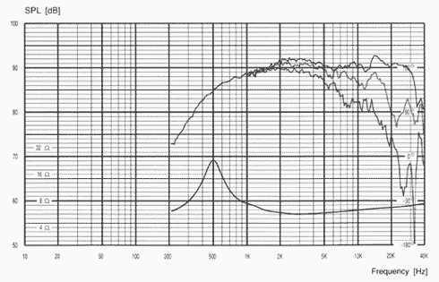

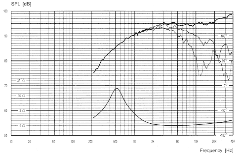

Have not hear either tweeter.
YOu can see the frequency responses, and the pictures of the tweeters themselves, at:
www.peerless.dk Click "Enter a world of speakers"
I can mkde a few observations though.
First, the 2904 is 4 ohms, the 2905 is 6 ohms. The 2905 would therefore be amenable to working with 8 ohm drivers, though the 2904 can be made to work with them too.
The design of the 2904 looks radical, the phase plug on top makes it look like some kid glued a miniature chess pawn onto the tweeter dome when his parents weren't looking.
More seriously, the high frequency dispersion of the 2905 is MUCH superior. With the 2905, the 30° off axis measurement stays within 3 dB up to 15, 000 Hz before diverging quickly from the on axis measurement. With the 2904, the 30º measurement is already 8 dB down from the on-axis measurement, and sinking fast.
Since one of the important criteria for a tweeter is good dispersion, I would definitely be inclined toward the 2905.

Pan:
I agree, but as the 2904 proves, even tweeters with similar diameter can have different dispersions. Of course, I am sure that phase plug makes the difference..
That is why there is a trend toward 3/4 inch and even 1/2 inch tweeters-so that better dispersion can be achieved in the highest octaves.
Thank you very much for the answers.
I am indeed considering the 2905/9900000 for the following reasons:
- Impedance compatibility with my setup.
- The extra dB of the 2905/700000 is not an advantage because I am attenuating current tweeters to equalize to the rest of the drivers.
- Better linearity and dispersion, as you've mentioned.
- Altough not cheap, it is much cheaper than the 2905/700000.
- I've heard the 2905/9900000 on Living Voice Avatar OBX-R2, top of the line from Living voice Avatar series, with external crossover, and it was superb. (never heard the 2904).

The reason I don't want to make broad sweeping generalisations is that the answer is not as simple as just radiating surface area, as kelticwizard alluded to.
Some tweeters has dispersion previously unseen in for their size eg. Vifa DX25TG. From my interpretations eg. of linear and non-linear distortion analysis by Mark K, Hobby Hi-fi etc, other parameters may not be as good.
AFAIK there's yet to be a "best" tweeter in terms of best low distortion, low crossover point, high power handling AND high dispersion. Picking one suitable for your design is picking compromises that you're willing to live with.
On all accounts the Vifa XT25TG Ring radiator is a very good tweeter and excellent value for money, providing you cross higher (than the low Fs would suggest) and can live or prefer reduced dispersion.
I couldn't afford the AU$500 ScanSpeak Ring Radiator but suspect it is a souped up version of the Vifa.
Back to the original question, I think there are more variables to consider than just 2 or 3 ways alone. Manufacturer specs indicate that both are likely capable of 2nd order electrical crossovers ~2.5Khz Khz crossover points, but the 7000 has the 3dB extra sensitivity and reduced dispersion.
Don't forget baffle step compensation. With 91dB/W of the 9900 is still plenty for a pair of high (90dB/W) sensitvity midwoofers.
