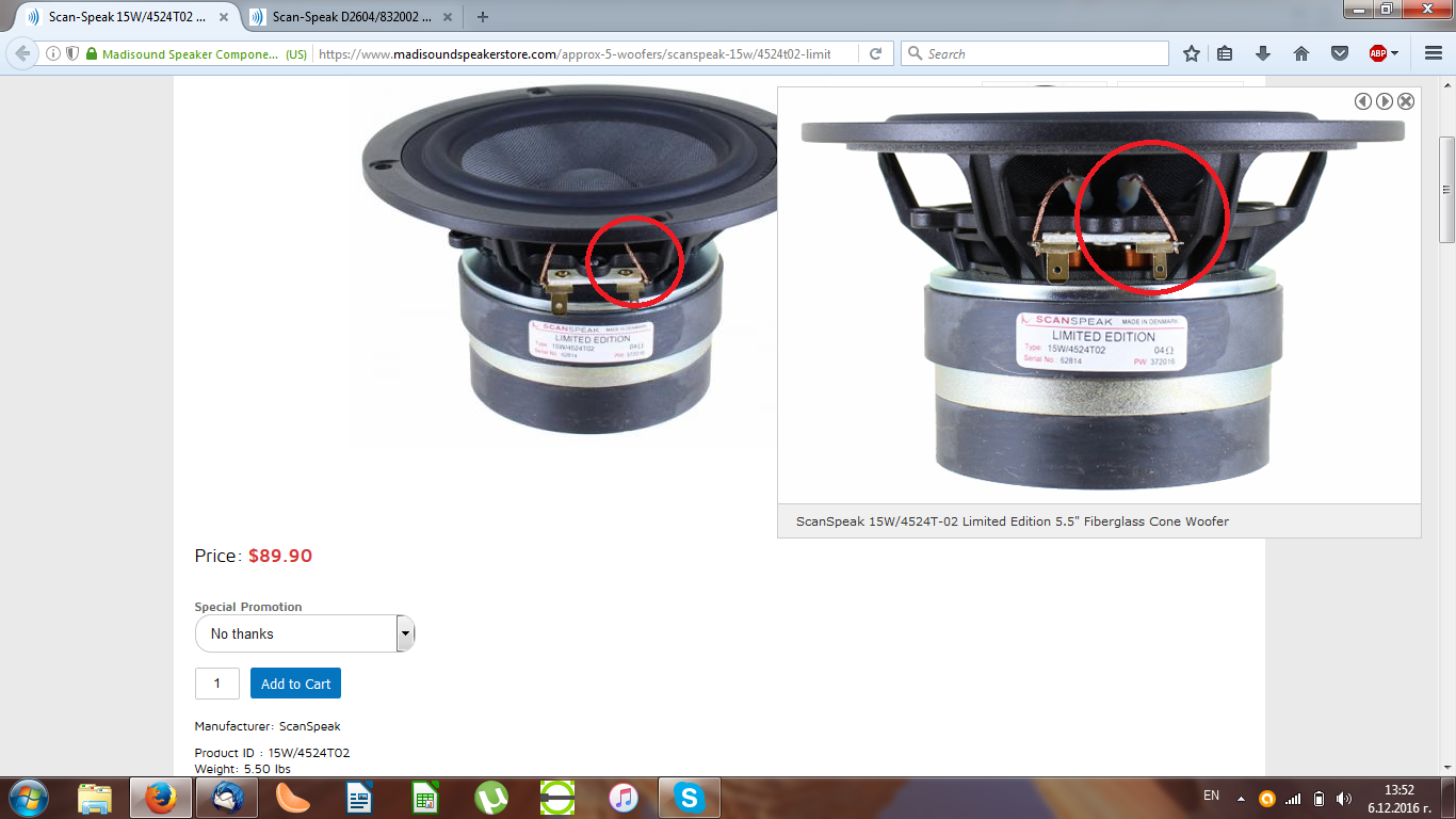

Generally marketing BS. The best "sounding" VC formers are: Nomex, Special heat resistant paper, Kapton, glass fibre, roughly in that order. Alu and other metals have their own place in a speaker, but likely not here...
Misunderstaning the impact of Qms on loudspeaker performance. Funny, a low Qms value is negative, and even much lower Qes which changes the Qts in a much more way isn't negative.
Are you are referring to the different sized spade lugs? I have seen this before and assume it is deliberate.I wonder if this was a lemon Madisound picked for the photo, or outward stroke would be funny to observe.
