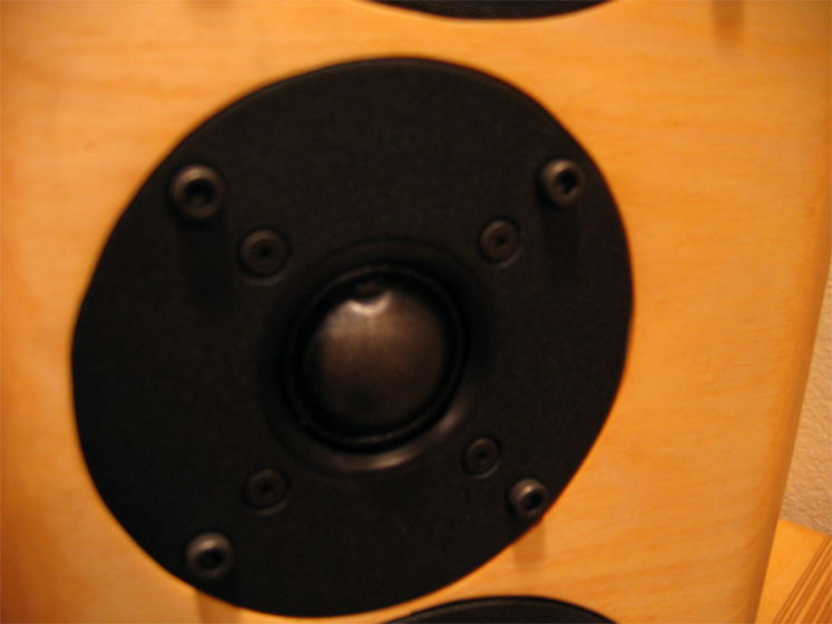

Any advice on how to fix my tweeter?
I've tried a vacuum cleaner attachment, and massaging with various tools. Can't seem to get the dome back to a smooth surface. There's actually another impression on the lower portion of the dome, not seen in the picture.

If Scan Speak are anything like Focal, you'll be able to buy a new face-plate/dome kit for a small fraction of the cost of a new tweeter. Maybe you could even buy 2! Try Madisound to see if they have such kits...
Your three-year-old (and cats) are a couple of reasons why speaker grills are worthwhile. You don't have to keep them on while listening but they are good protection from other household members when you are not in the room. Have you ever seen what "accidental" contact from a vacuum cleaner can do to your dome tweeter - leaves a three-year-old for dead...

I'll give them a call today. Looks like they sell a "Replacement Voice Coil", so I'm not sure what that all entails.
Understand, I didn't just toss the head of the vacuum cleaner hose onto the dome; that wouldn't be too wise. I used an attachment and tried to get at it from the side.
Anyway, maybe tonite I'll try some tape to stick to the textile, and possibly pull it out.

http://www.madisound.com/catalog/product_info.php?manufacturers_id=148&products_id=911
Product Description:
Replacement Voice Coil for Scan-speak D2905/9300 & D2905/9500 tweeter.
$24.

I have done this a bunch of times, most recently when the one and only Bob Cordell sent a sine wave through and blew my Seas tweeter coil. (Bob, I told you I would milk this for all it is worth).
Madisound has a pretty good stock of these and they are cheap. I would get a pair as quite often there are production variances and you want the tweeters to sound and look alike. The coils come attached to a face plate so you get a new plate as well.
So far, I have found the Seas and Vifa have Ok aligning pins on the replacements. Morel had this snap system which worked really well. Eton had no aligning system and I ended up throwing the tweeters away.
The ferro fluid stays in the gap when you pull the coil out, so don't worry about it.

Ordered two of them. Yes, $24 ain't bad.

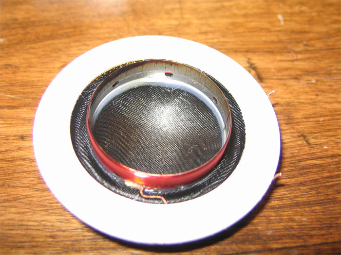

Got the coil assembly repaired. It was quite easy. The only "if" I had in the process was the centering of the new coil in the gap. My assumption was that everything would align due to magnetic forces, but I'm no speaker expert.
All I know is things sound good. 🙂
Attached a picture of the old coil. Kids squeezed that sucker so hard they actually bent both sides of the former !!
