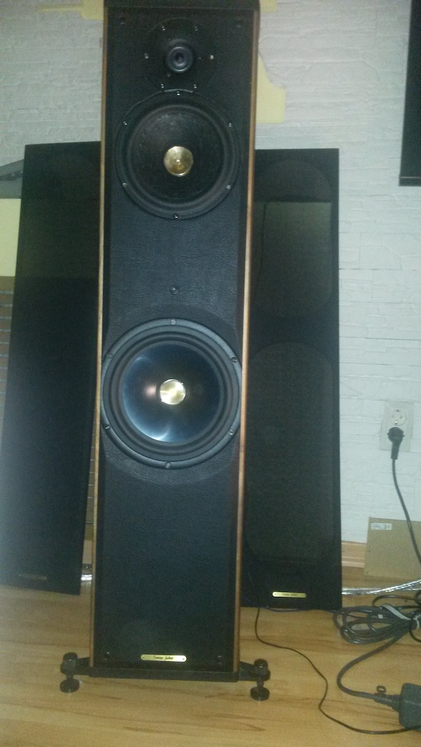

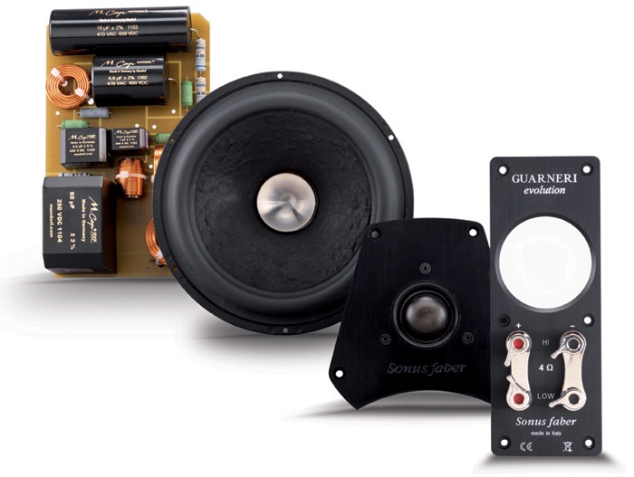

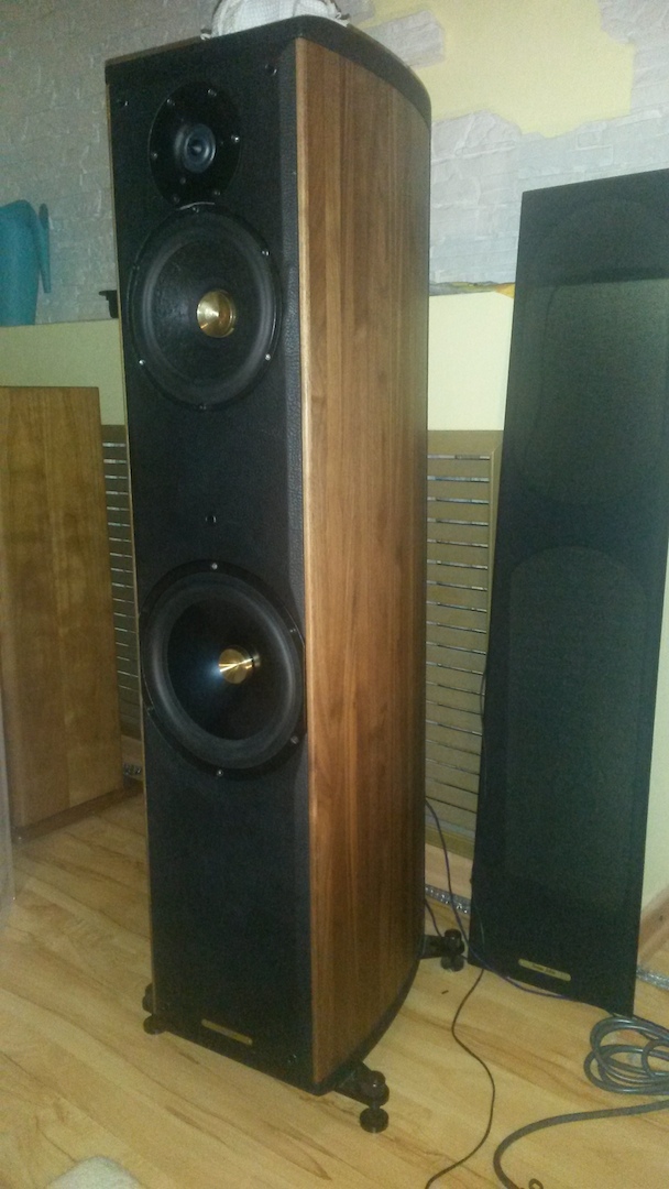

So after extensively listening to Sonus Faber Guarneri Evolution, I've decided to use the 8545K00 midwoofers. Guarneri' use Scan-Speak 18W/8545K00 and 2905/970000 and they sounded beautiful. Probably the best two way that I've ever heard.
I'll be modeling a crossover, but any and all help is appreciated. If you guys could post the actual Guarneri Evolution crossover, or decipher it from pictures it would be a great start.

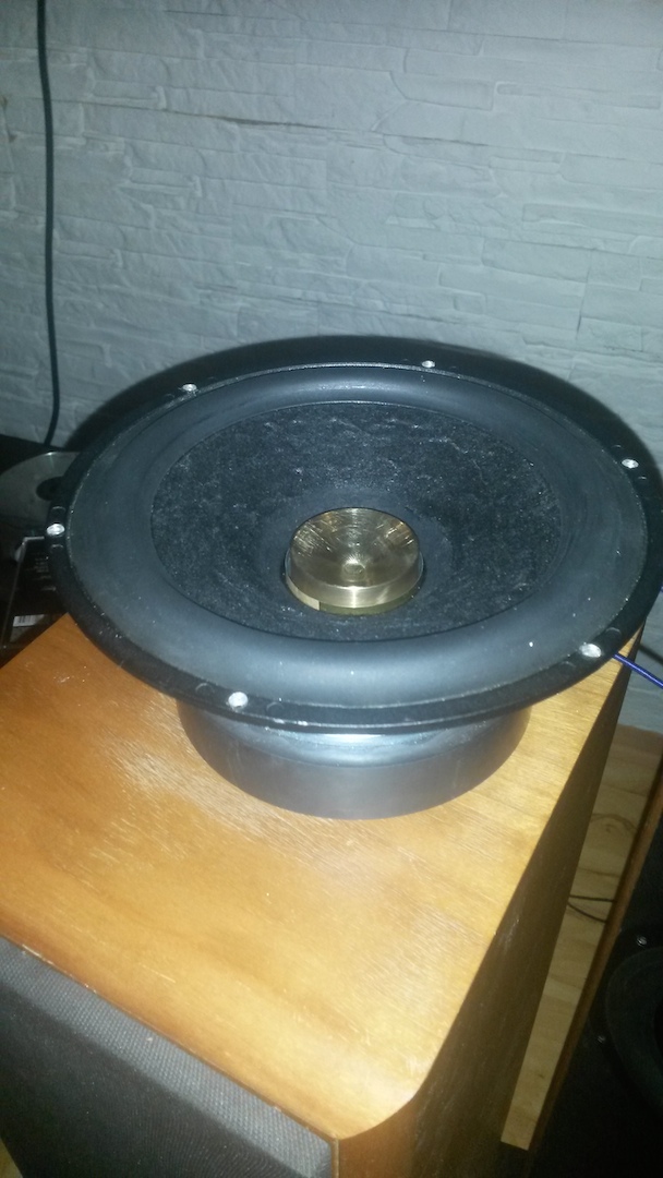

I highly doubt that Sonus Faber uses regular drivers, they are quite certainly custom made, at least the woofer is, seeing that phase (?) plug. The SF crossover was designed around the custom drivers, not the regular ones.Guarneri' use Scan-Speak 18W/8545K00 and 2905/970000 and they sounded beautiful.
OTOH, I haven't searched, but I think you'll find some design for your drivers, they are real "classics".
Ralf
Ralf
The drivers are probably modded slightly, but it would still be fun to get the crossover and model it with stock drivers to see how close in the ballpark it gets.

Right, manufacturers simply have to say their units are custom built
and they are. Does that mean one can't make a clone with stock parts, no.
You don't need the filter schematic to be succesfull in building it.
Use the Stereophile measurements of individual driver responses
and insert the parts until the curves look "the same" and you will
have a well performing clone.
