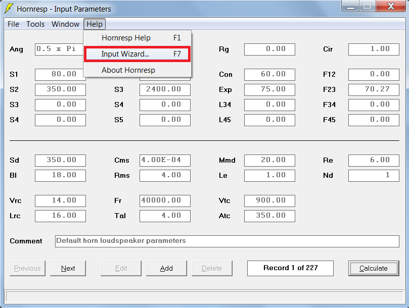

That was the configuration in their last build, though I did not take any measurements they had narrow band width,one note wonders. I downloaded Hornresp, I am struggling with it, I get the T-S stuff ok but most of the other stuff I am clueless at this point but reading the sticky. I will all serve as a good learning experience. I will also need to learn how to use Mini DSP with the USB mic., and filter software.
Hi Bill,
Use the Input Wizard to help you get started - it can be accessed from under the Help menu. Once you have generated a generic template for the system you want, change the given notional input parameter values as required. If you have any specific questions regarding the operation of Hornresp, post them to the Hornresp thread and I will try to answer them for you.
