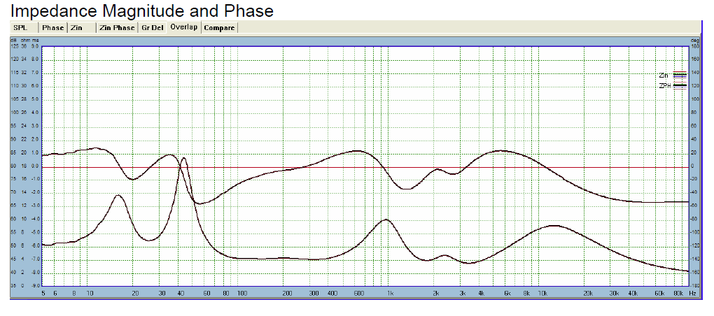

Let's take it from the top:

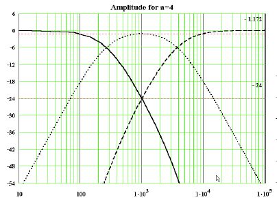

Steen Duelund curves for a 3 way. All works very well in LR2 or LR4.
Except sometimes it just doesn't:
I was as popular as a pork chop in a synagogue for saying that one stunk to high heaven! A severe burst of cognitive dissonance in the back-slapping build thread when I mentioned some problems in a gentle way. 😀
Dips to 3 ohms in the midrange. Impedance wobbles all over the place. It's even a DEAD SHORT at high frequency. I can't judge if the SB bass really needed breakup treatment, and Troels doesn't think it does: SBAcoustics-3WC
A 4" mid obviously helps here, but its 4 ohms is an unnecessary nuisance.
The fact is that easy, well-behaved drivers just give you a solution that works at every level. Once you start notching breakup, and having to bend a difficult frequency response, everything seems to go to hell.

You are just plain wrong about the impedance characteristic of the Sonatello. It dropped MINUTELY below 4 ohms briefly between 3 kHz and 4 kHz not in the midrange, and definitely didn't dip to 3 ohms anywhere. The impedance is right at 4 ohms between 100 and 400 Hz but with a favorable phase angle, so why is this a nuisance? The frequency at which it could decrease towards a dead short is so high as not to be an issue whatsoever due to an absence of any content up there to cause a problem, short of the driving amplifier being defective in the first place. Please don't criticize what you have not heard nor what you didn't design just because you don't like it or it's not the way you'd do it!

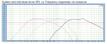

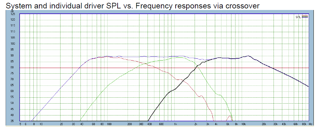

What did I say that was a lie? Charts below. 😀
I took the trouble to sim your speaker, and found it looked more like a test of concept. Forgiveable because it was 6 years ago, and really nobody knew much about SB drivers.
A 2.2kHz cross to the tweeter doesn't really play to a 3 way's strengths. The tweeter filter is underdamped, which is why the impedance dips so low at 3kHz. An attenuator would work better and perhaps sound better too. The tank notches are overly deep and there are two paths to Earth in the bass and the mid. I did say originally that you just take your beating on a bass reflex impedance.
I would call it an interesting failure. Sorry. Nowadays we think it is far better to use a dedicated 4" midrange (or even two, wired in series!) that is flat rather than a difficult 5" midbass. Or at least, me and Troels Gravesen do. Then it all falls into place, simply.
