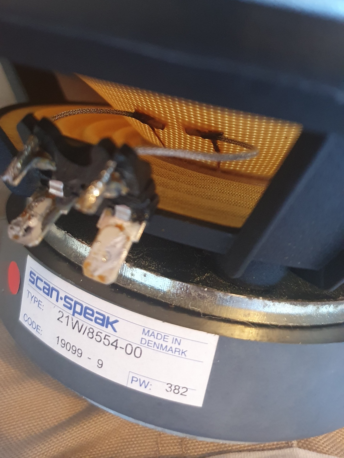

The leads look OK (see the attached image). The discolouration on the speaker terminals is flux; not rust or burning.

Looking at your image, the voice coil wires appear as if they are joined to the tinsel and then go straight down to the voice coil, not joined under the dust cap. Tricky!! it still might be worth trying some gentle pressure on the tinsel lead to verify it isnt broken and corroded just behind the terminal?

It's worth a try to see if the wiring has become flaky (I'll give it a go when I get chance).

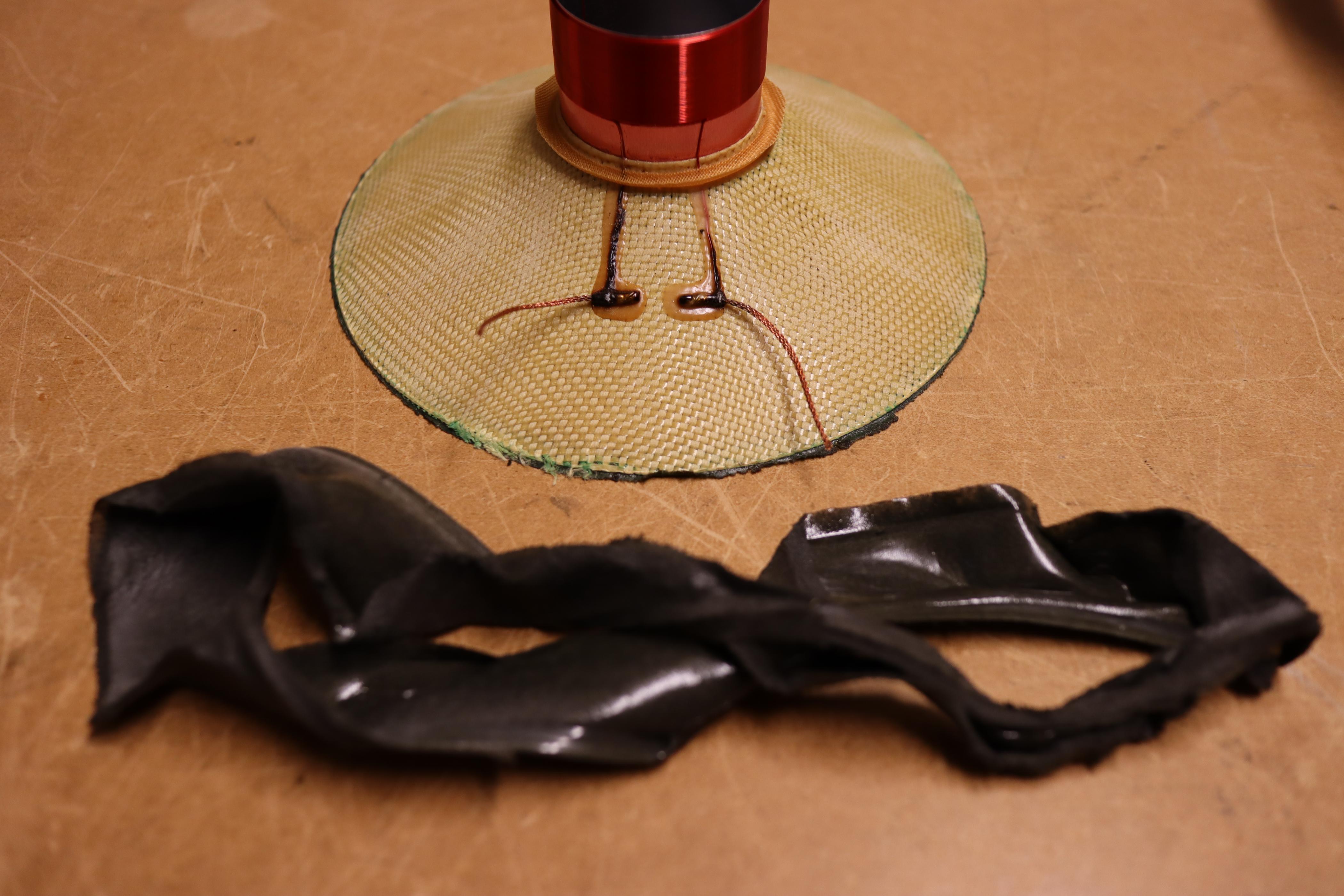

I think what's happening to these drivers is the Kevlar hanging onto humidity and contaminating the tinsel/VC connection over time. Corrosion gets started and eventually you have no more connection, even though the voice-coil is still fine. (Check out the photo.)
Also, the surrounds on these have a limited lifetime.
This particular driver had a third issue so I decided to tear it apart. In addition to the corrosion, the surround is a sticky/gooey mess. 🙂
