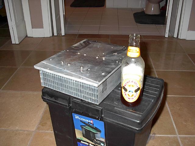

Eah watts wrong with a little heat. I found some ugly but very efficent looking heat sinks in my favorite surplus shop. They are about 3"x8"x12" with tiny fins (1/16"x1/2" slots). The guy said that with forced air, they should be good for about 2kw. (I think more like 1kw.) But they are only $15.00 each. I'm thinking that with a well thought out open cell foam labyrinth for an air chase that you wouldn't hear a quiet fan or three. This scheme works well with 150 KW diesel generators.
I love the looks of huge masses of axtruded aluminum, but this may be a more space and cost efective way of making a inexpensive huge AX.
I'll post pics later.

Here's the idea I've been kicking around for the heatsinks of a 200w Aleph-X. I was thinking of 'emulating' Levinson's 33H' with a tall'ish design. I was pondering the use of a 20 inch R-theta 65340 in black for each side of the monoblock. A silver or natural colour 66153 for the front. And 1/4" plate for the rest. Here are the related pics.
Dan
P.S. This is just me trying to think 'outside of the box' so be kind.
Dan
