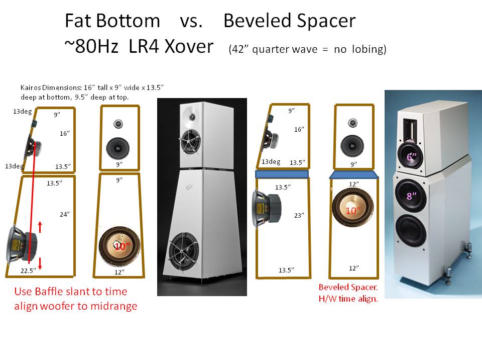

A narrow MT cabinet like the 9"W Kairos could use an expanded base woofer cabinet(fat bottom), or a beveled edge TM - W interface for a clean look.
Passive crossover L's and C's are expensive. Building a proven design can often save enough money avoiding C+L mistake purchases to pay for better drivers.
If the $714 Kairos pair kit is too expensive, price out this option.(Xover available)
